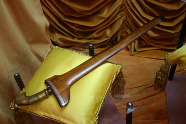

This Kris was part of a lot of Indonesian/Malaysian Keris I found so it was posted on the Keris forum.
I thought it was Sulu, maybe redressed in Borneo.
But Ian noticed that it maybe could be Malaysian and didn't look like a typical Moro Kris.
So I post it here instead with hope of further comments to help me understand from where it originates?
Quotes from earlier discussion between Ian and me at the Keris forum.
Ian:
"That Kalis Sulu is beautiful. The ivory kakatua is considerably smaller than most. Do you have any idea where this one originated? I'm wondering if it came from Brunei or Malaysia because it is somewhat atypical for a traditional Moro kris."
Michael:
"I suspect that it maybe could come from NW Borneo based on the motifs on the silver band. But that's just a guess and I still think it's Sulu.
Please convince me if that's not the case?"
Ian:
"The reason that I think it is odd for Sulu (that is, Moro) is the hilt: a smaller than average kakatua and the continuous silver wrap to the hilt which has an octagonal "tubular" apeparance. The usual form of Moro silver hilt dress would be circular or oval bands of silver that overlap. Also, there is a small "lip" to the silver handle sheath just above the gangya -- not commonlty seen on Moro weapons.
That said, there was a lot of interaction between the Sulu and Brunei Sultanates, so some diffusion of styles each way probably occurred. Indeed "Sulu" has sometimes been used to include Brunei, so we may be splitting hairs."
I misunderstood what Ian meant with the octagonal hilt so Ian clarified:
"What I meant to say is that an octagonal hilt, per se, is not rare on Moro kris, but a continuous silver "sleeve" as shown in your first example above is something that I have not seen before."

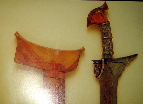

Just recieved this Christmas card from another collector (not active on the forum).
It's from the Tropenmuseum, Kris from the Sulu archipelago, with a full silver hilt collar resembling mine?

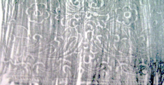

I still believe that the key to narrow down its last usage may be found in the engraving work on the scabbard and hilt; considering the trade throughout the archipelago that won't help to ascertain the origin of the blade (which could well be Sulu) though.
Michael, could you please try to take pencil rubbings from the silverwork engraving? It's hard to see details from pics... Thanks!

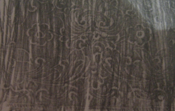

Hi Kai,
Never been a great artist but here you have from the scabbard.
Unfortunately the hilt engravings didn't come up.

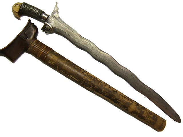

Bill
Location: Chicago area
Posts: 327
From your pictures, the patina on the ivory looks like it's pretty old. It looks like everything is very old. The kakatua on the one I'm posting is bigger, but has some simularities. The "elephant" head is also simular. Would guess the age is about the same on both too. The one I'm posting, I would have thought came from Sulawesi or Brunei. I think there was a post sometime ago where someone stated the metal wrap on the hilt was Malay, Riau or the straits area. The Bugis would be common to the whole area.
