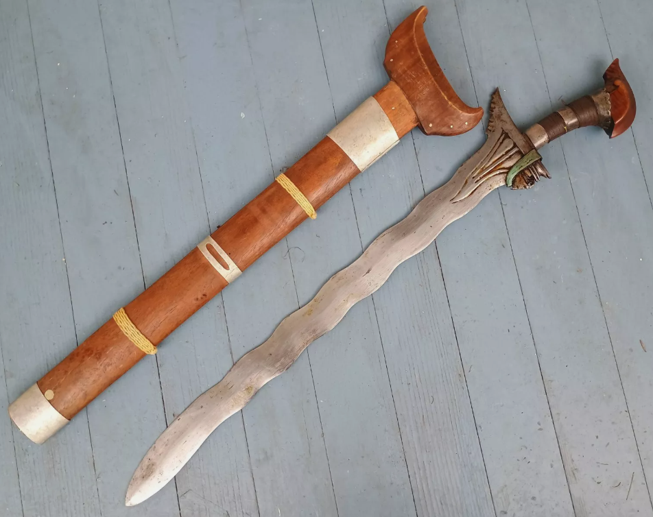

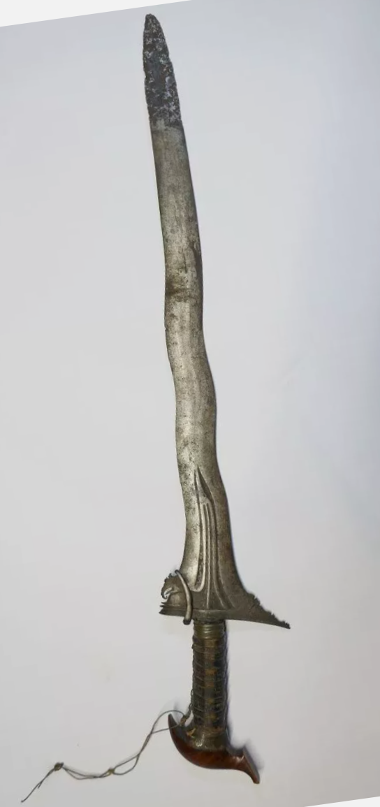

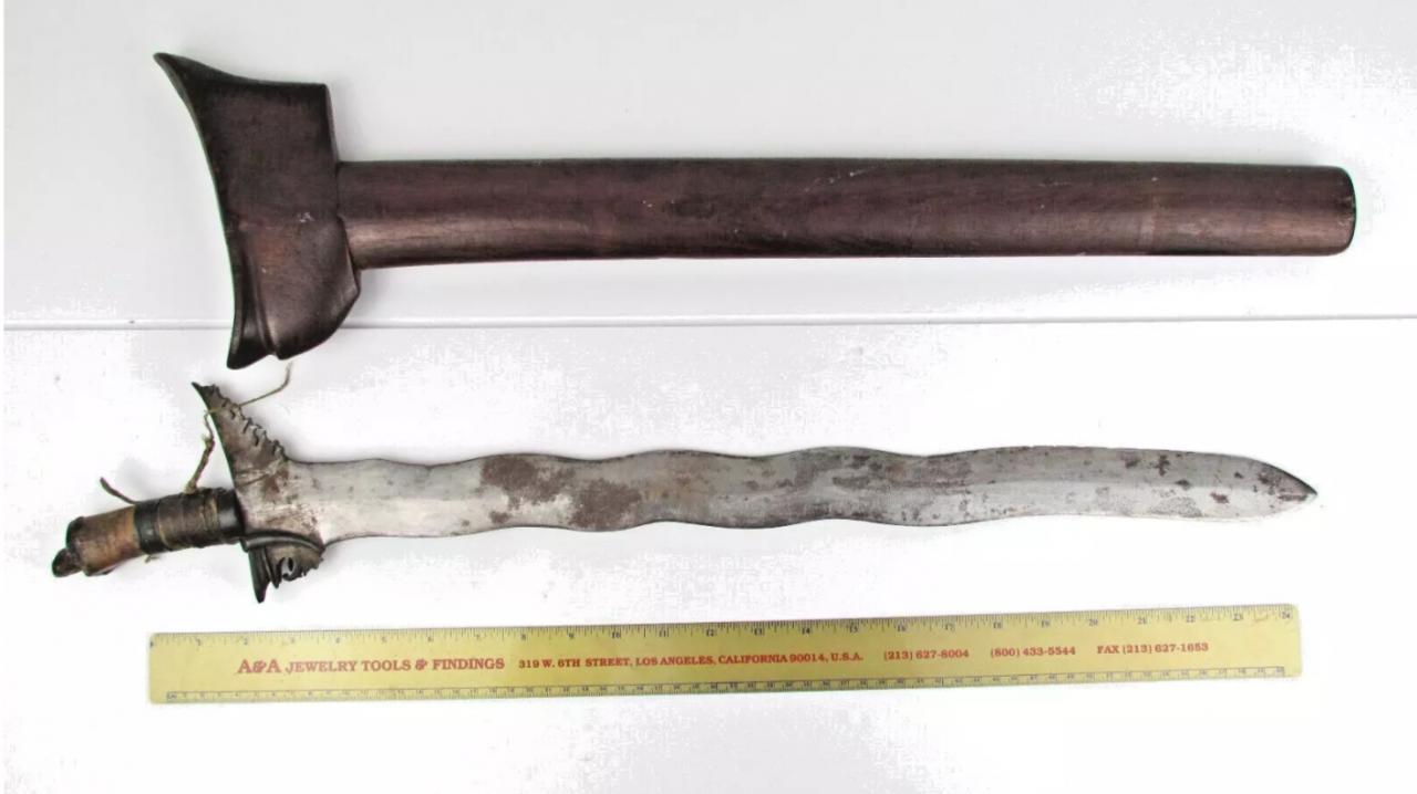

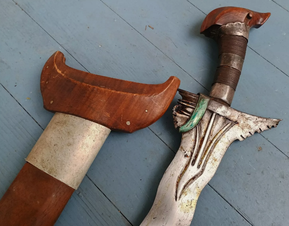

Here are three recently sold examples of average kris that I thought were interesting for various reasons. This is a comparison overview shot.
Name:  Kalis Comparison Try 2.png
What is your first impression of these swords? Age, designed use, overall cultural impression. Do we have a name for these swords yet?

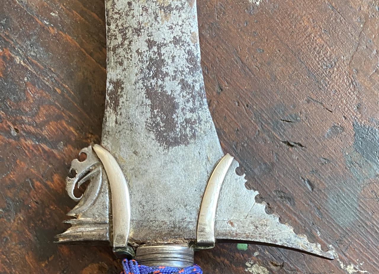

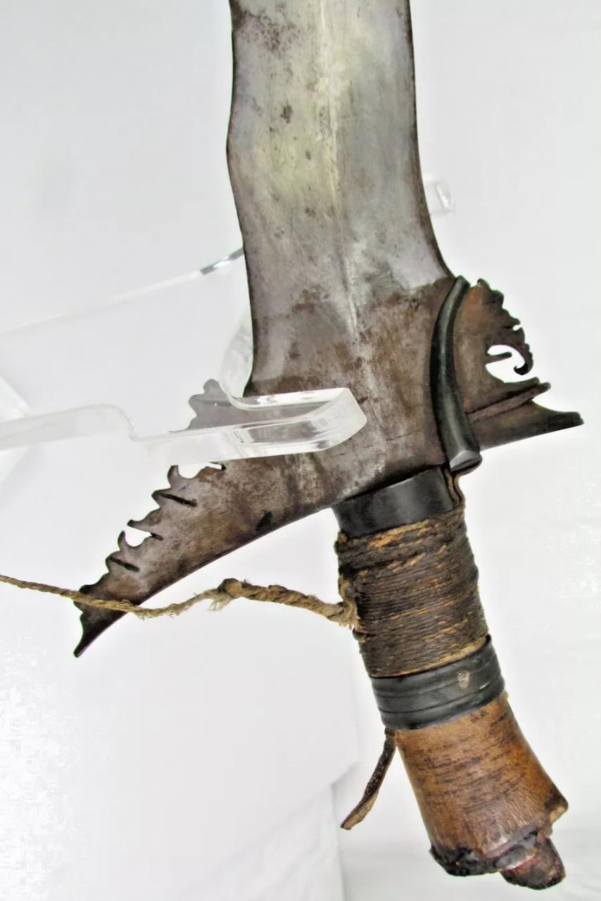

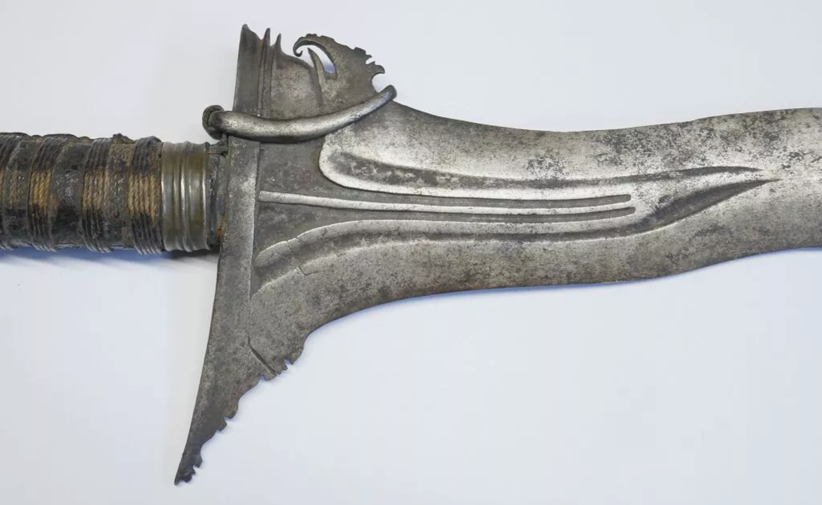

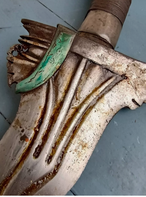

Now here is the ganja shot. Does Cato's system of analyzing the ganja work? Two seem to me to be two piece ganja one I am uncertain about. If we had a name is it still the same? What else do you all see?

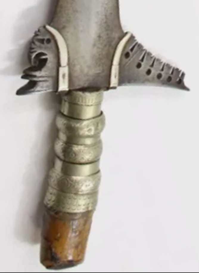

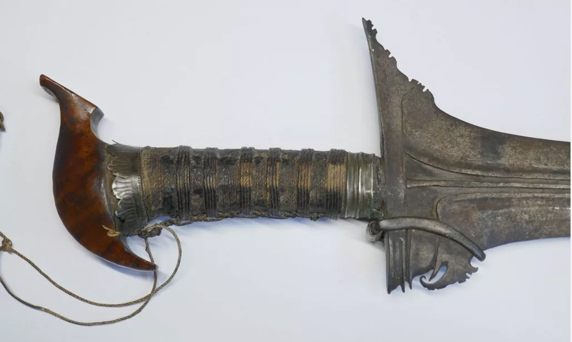

Dress. Handles. One is missing a pommel I believe. There are 2 baca baca on each. Would the hilt now change the name of each? What culture would you say each is from? Estimates on the age of handles?
Two examples have the sarong/sampir still. Age/culture? How does this change our perception of these two?

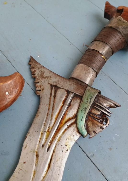

White metal handle of the middle example. Sorry for the large size it was resizing oddly for some reason.

As you may have noticed in my article, the samples were from a particular era (late 1800s-early 1900s), as those were the kalis and kris that I've been most exposed to, and had the privilege of studying. I believe all the samples you presented in this post fall under that era.
I look at all the details at the base of the blade, particularly the elephant trunk and the 'katik' or notched guard. Then there are secondary considerations... for example, Sulu kalis usually have slightly smaller blades than their Mindanao counterparts; Maguindanao blades have an outline at the elephant's "mouth," Maguindanao and Maranao battle blades have raised spines at the middle, etc.
If I were to label your sample-blades from left to right as A, B, C.
A is a bit blurry, so I can't give an ID. Meanwhile, B is likely Maranao. C is likely Maguindanao.
The dress of A is Sulu; the scabbard, kakatua and proportions to the hilt, the way the asang-asang are attached to the hilt, the ferrule- all Sulu in my eyes. I believe the dress is as old as the blade, or at least belongs to the same era.
The dress of B is also Maranao- but if what I'm guessing is correct (that the material used is aluminum), then it's of WW2 or postwar make.
The dress of C is Maguindanao. I believe the hilt wrap may have been "upgraded" at a later time. The hilt wrap looks like brass wire-wrap with interspersed brass bands. The asang-asang is also brass, possibly upgraded the same time as the hilt.

Among the hilts, here's what I observed:
-All hilts traditionally have a wood core; sometimes the pommel and grip are made as one piece, sometimes they're separate. I favor those made as one piece with hemp or rattan wrap- something like C's, but in its "original" version, and not the upgraded one. The brass or silver wires are a literal pain once they fray. There's a reason why the simple hilts were attached to battle blades- because they were the most functional and least likely to break.
-If the pommel is ivory, the hilt comes in 2 pieces. Regardless how well the ivory pommel part is attached, if the hilt suffers a lot of stress (prolonged and repeated use), the middle part (grip) will eventually break. Ivory is usually "heavy" and I'm guessing the physics of having something modular at the end of the hilt results in significant strain on the wooden grip.
-If the pommel is light metal, the hilt will last longer than an ivory-pommel one, although not as comfortable and resilient as wooden pommels.

Thank you for responding! Sorry I took so long to reply. I had to process the answer for a bit.
So two asang-asang do not guarantee a Sulu connection?
I attached a better picture of A.

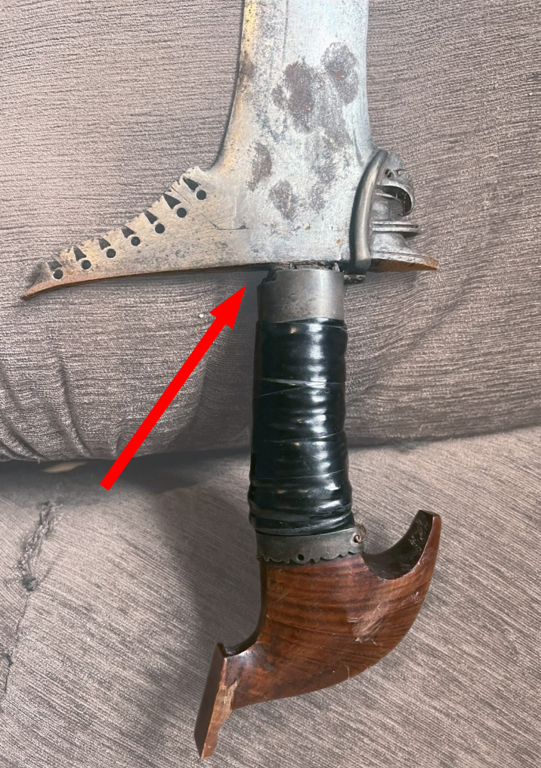

Thank you again for your responses. Could I ask some follow up questions for clarification?
What is the outline at the elephant's mouth?
Secondly. If the blade of "A" is thin, light, and springy like a butchers knife. Lenticular in cross section. without a distinct raised spine and described in post #7 as "For the blade itself- I would posit Mindanao (Maranao or Maguindanao); if I'm correct in this, then it's a hybrid piece, Mindanao blade with a Sulu dress." What would it be for? Without a raised spine is this a dress piece or could it be for quick slicing movements rather than heavy chopping blows?
