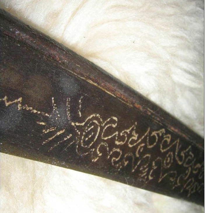

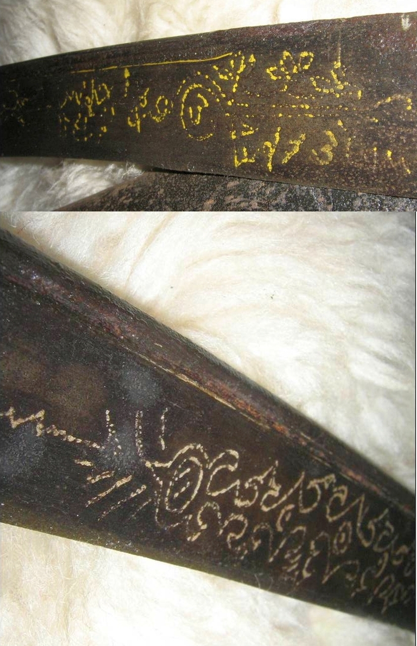

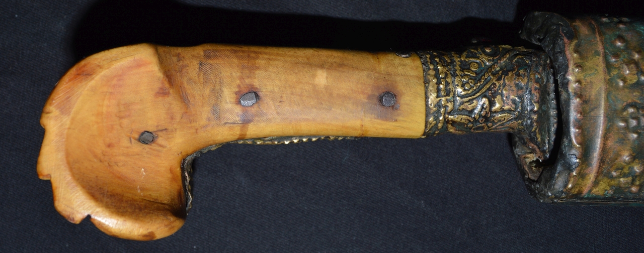

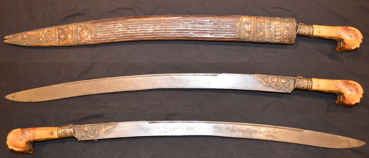

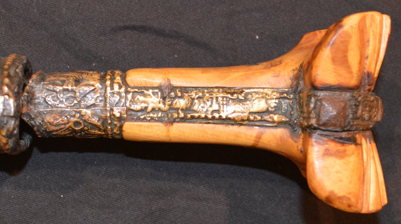

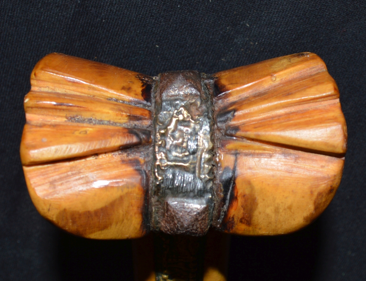

I still have not seen anything similar to this yatagan, here are some additional pictures. 28 inches long.

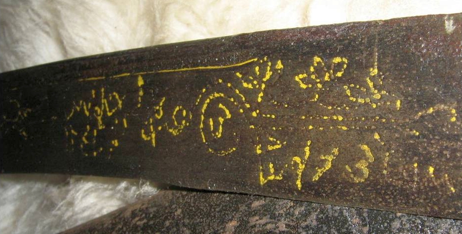

#13 |

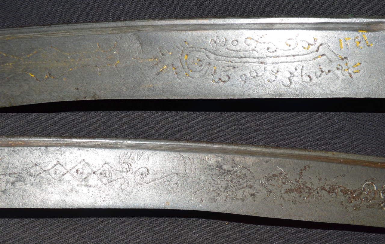

I like your yatagan, the date on the blade is 1825.
Is the central part of the scabbard silver? Congrat!! |

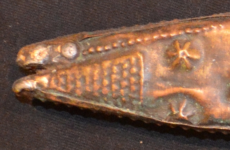

In the last set of pics, the fourth from below, scabbard fitting: isn't there a half-moon and a star?

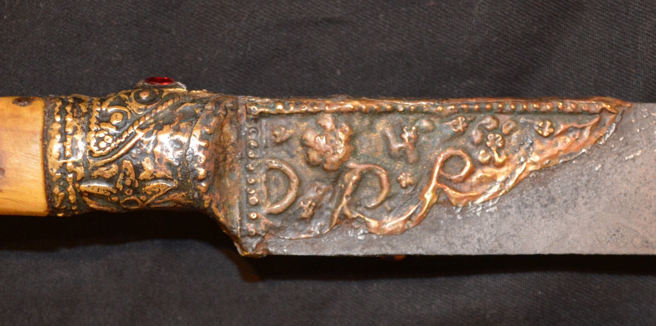

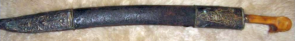

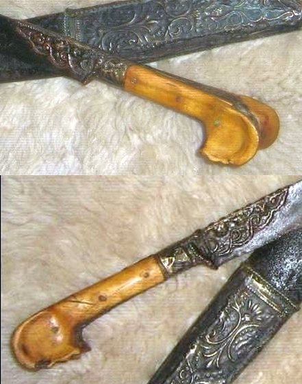

This yatagan is similar in some ways, the blade has gold marking on one side and silver on the other, the scabbard ends are similar as is the grip which may be wood, it is the closest I have seen.

#21 |
Posts: 7,363
Thanks for the close ups. Now I see that this is truly more unusual than I originally thought. Though still leaning Balkan, it now does not seem as Balkan as I thought now that I see these later picture close ups.
Regarding the 2nd example, what region does it come from in the Ottoman Empire? Also I agree with Kubur regarding the fish/monster scabbard finial. Quite common on Ottoman yataghans, both on sword and dagger styles. |

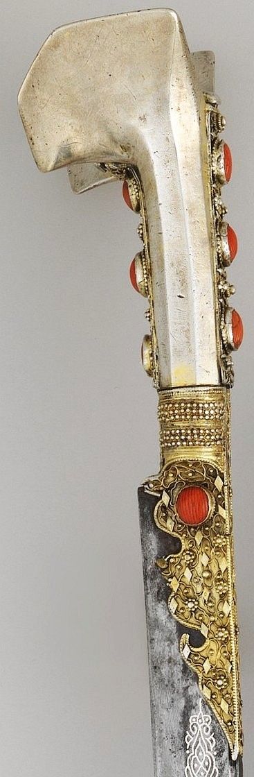

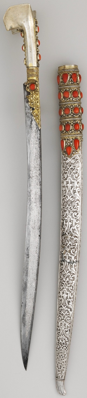

#22 |

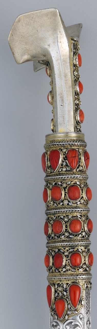

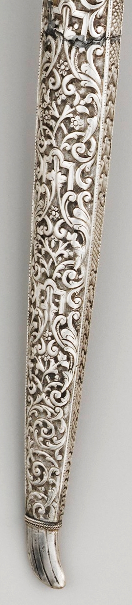

The one with a silver handle has round non-striated red stones ( corals?) .
I recall that Elgood mentioned it as a specific sign of manufacture in Foca. |
#23 | |
Join Date: Jun 2012
Location: USA
Posts: 1,492
Is this the yatagan you mean (Regarding the 2nd example, what region does it come from in the Ottoman Empire?), if so it is from the Met. Ottoman (Anatolian or Balkan) yatagan / yataghan, dated 1802–3, steel, silver, gold, coral, Length 29 in. (73.66 cm) Length of blade, 23 1/8 in. (58.72 cm), Wt. 3 lb. 8 oz. (1588 g). Met Museum. The yatagan was popular throughout the Ottoman Empire. It is distinguished by a single-edged blade that curves slightly inward and by a hilt with no guard and two flared wings at the pommel. |

The engraving on both blades and the hilts seem to be quite similar in my opinion.

#30 |
What makes my antennae twitching is the apparently different metals of the bolster parts and the scabbard fittings, the clumsiness of the scabbard's mouth ( the real things are almost in line with the handle and not almost twice as thick as here) and the crudeness of the scabbard decoration. I am also very uneasy about the " fish head": usually it is almost like a separate detail, turned up and more like a "dolphin-head". This one is short, stubby and looks like a herring:-) .
The more I look at it, the less I like it. But the blade is unquestionably real. TVV is correct: Bulgaria is not the only one place in the world exporting benign or not so benign:-) "restorations". Simply I saw quite a lot of things on E-Bay coming from there with similar features and very similar wooden ears of a non-traditional contour. |
