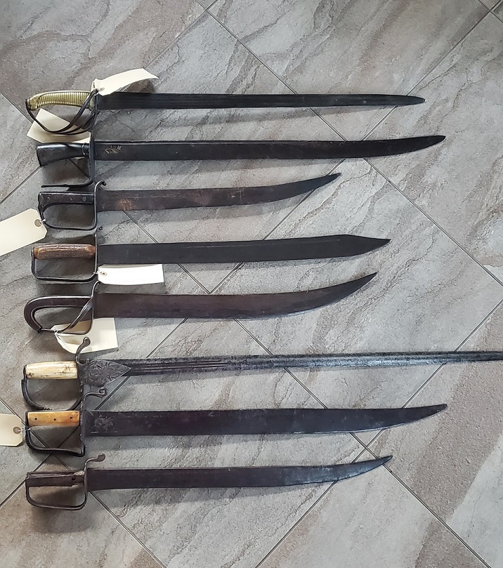

The work continues, and I recently found a shellguard example (attached) which is yet to arrive. As noted earlier by Mark Eley (again my sincere thanks to him for his response) these had a close connection to the 'cutlass', from which they evolved as discussed in the article.

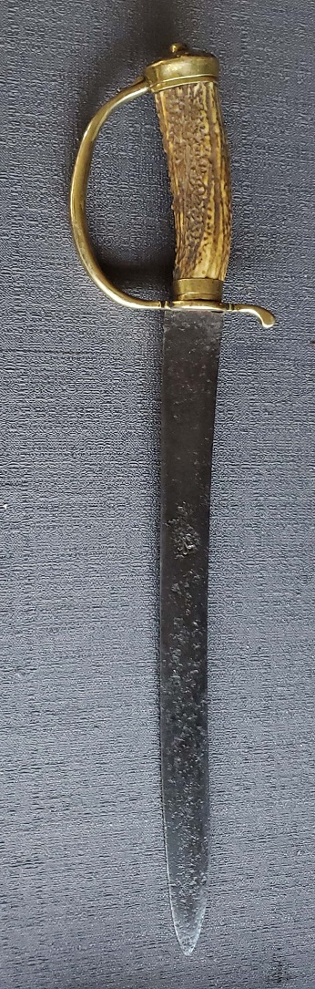

I wonder if this curiosity of mine fits anywhere in your world; it is certainly an oddity with more relations in the naval world, but still not certain.

This seems to fall into the category of naval cutlass alright.
As noted,the Spanish espada ancha, as I point out in the article, is likely derived from the hunting hangers of the 17th century which were typically used aboard vessels as well as the heavy bladed types regarded as cutlasses.
The heavy bladed 'cutlass' was far more durable for the utility duties it was most inclined to find use in, particularly ashore when such weapons were needed to clear vegetation etc.
The 'name game' comes into play here,as used aboard vessels, stout often shorter bladed weapons were collectively termed 'cutlasses', while ashore used in the vegetation clearing (and other) functions it became 'machete'.
This was actually the Spanish term by which the 'espada ancha' was known as these evolved in the frontier regions of New Spain (now Mexico,and Southwestern America) in the 18th century. The espada ancha term came from a writers mistranslation in the mid 1960s and has remained in place with collectors since.
This fine example appears to have the hilt of a British infantry hanger of 1750s and of course the stag horn grip popular with hunting swords of the times. As we know, these horn grips often occur on various cutlass forms as they had through the 17th century as well.The blade seems somewhat cut down from a hanger of the period much in the manner of dirks.
You will recall this example,an English or French hanger cut down into a dirk.

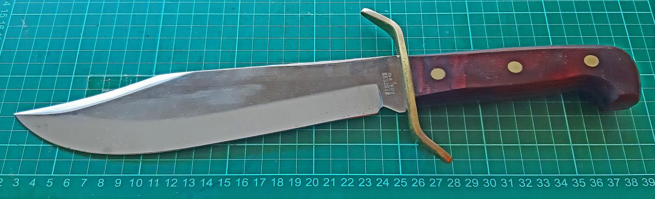

Peter mentioned such swords cut down to form 'Bowie' knives.
Here's my 10c worth.
As close as you can come to a cut down sword.
This Western/Coleman knife is the knife Harvey drew when about to start the knife fight with Butch. "Rules! In a knife fight?"
I'd wanted one of these since I first saw the movie.
I've actually chopped fire kindling with this one.
It's much bigger than it looked in Ted Cassidy's fist.

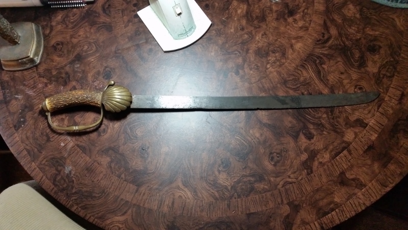

The cutlass arrived today, and it has crowned GR on blade (Gilkerson, p.88) but hilted with Spanish cockle shell guard of espada ancha. It appears to be indeed a cutlass but of the 'Spanish Main' of the early 19th century in Caribbean 'South Seas'. As these Caribbean colonies were using many English (or Solingen produced versions) in these times, this falls neatly into that regional part of the espada ancha spectrum.

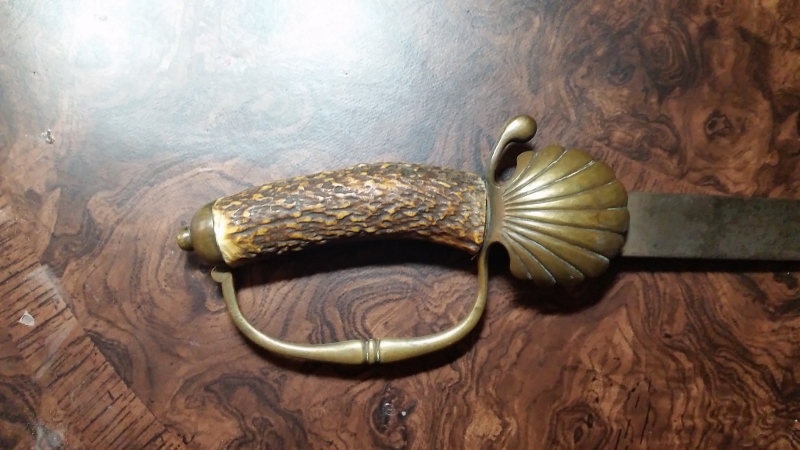

And here's my 'shell' hanger ca. 1780 to add to the pot of naval contenders!

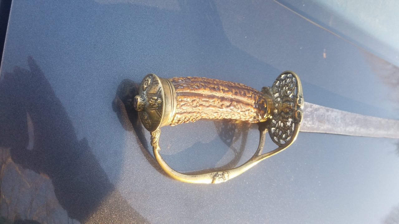

And one to match Keith's-

Thank you so much Capn! What an incredible 'shell' that is!!!
Great insight into these types of cutlasses, and how key this is to the scope of the espada ancha, which of course evolved it seems from these types of swords used on vessels. The terminology is always a conundrum, essentially a heavy, relatively short bladed weapon is a 'cutlass' as used on a vessel.....but employed in utility use ashore becomes a 'machete'.
The machetes that became known as 'espada ancha' through an inadvertent mistranslation in the 1960s, thus creating a colloquial term for them, now firmly emplaced, are in effect machetes. (a machete by any other name is still a machete- Shakespeare?).
While the 'shell' that just entered my arms locker has its place among espada anchas.....I will post another thread for it under cutlass heading after a bit more research.

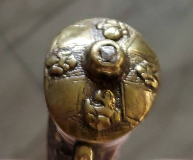

I don't know what I like best: the superb piercing on that very practical weapon or the magnificent table of 'Elm burr'?
ps
Notice the Feur de lys on the pommel cap Jim.

Yup Keith, just like the one cut down to a dirk!

In accord with post #14, it appears this shell guard hilt style is English c.1750 as per Nuemann (1973, p.83, 64.S).
It would seem this is virtually the same hilt form which likely circulated for some time, and seems favored for refurbishing cutlasses as might well be the case in supplying privateers and private merchant vessels.
While the shell is well known on many espada anchas, the theme is of course widely used on European hangers, including those regarded as cutlasses.
I have started a new thread with this cutlass today.
