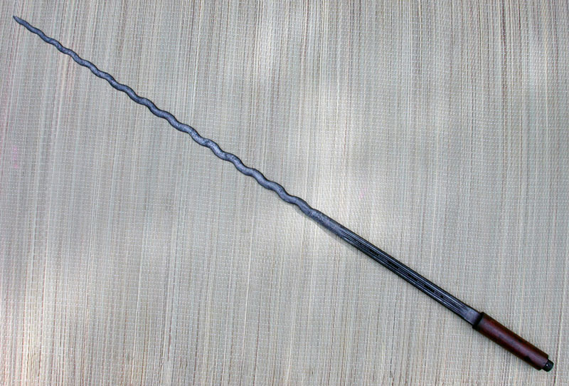

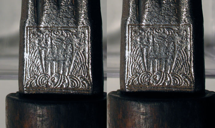

Hi,
I found this unusual sword in an old collection weapons from Congo, it doesn't look african to me, ...I have no idee. It have some figures on both sides of the blade, one figure looks greek to me
Total lenght: 95 cm
Sombody any idee of the origin and age?

Old 16th August 2006, 03:16 PM   #2
Posts: 6,429
Looks like European markings.
Could be an old flamboyant rapier blade .

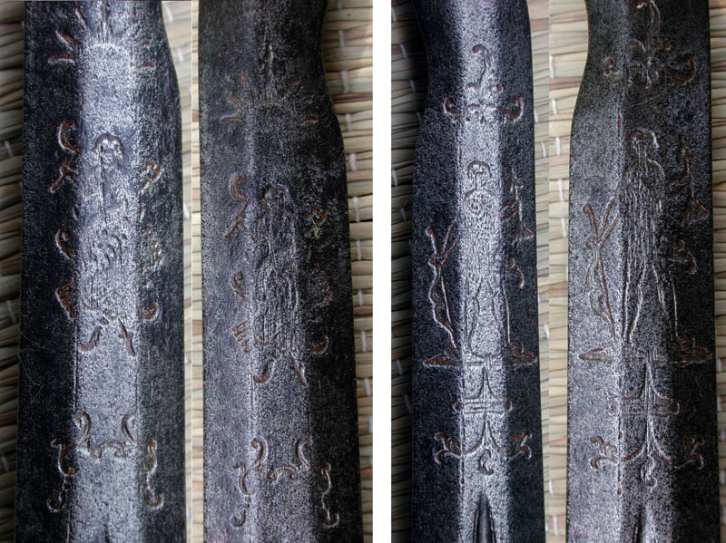

Old 16th August 2006, 04:11 PM   #3
wolviex
wolviex's Avatar
Location: Poland, Krakow
Posts: 421
Very nice and unusual find!
Etchings on the blade are from the 2nd half of the 18th century. Etched lady is Diane - in Roman mitology godness of forest and animals, always depicted as hunting lady. I can't recognize the second person on the other side of the blade under the sun - the picture is fainted.
The blade is European for sure, probably even earlier. Open-work - those holes on the blade, reminds me some of the 17th or even 16th century blades, but I think the first conjecture will be closer to the truth.
I believe the others will tell you more about it.

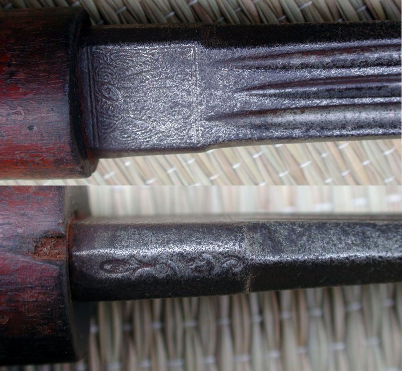

once converted into a concealed weapon, like a sword cane or stick, now missing the blade cover part ?
Old 16th August 2006, 04:49 PM   #5
Posts: 6,429
I see drums and flags at the ricasso .
How about doing a rubbing of the marks ?
I think you're correct with an earlier age Michael; if this is indeed a rapier blade the length would be in keeping with that which was popular in the mid to late 16th, early 17th century . The thing that puzzles me is the half waved half straight form .

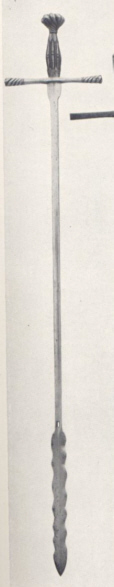

Posts: 5,996
This is a 16th century hunting Estoc from the Wallace collection. I think we may well be looking at the genuine article. The goddess of the hunt would seem quite appropriate. Rather a special blade to have. If it were mine I would take the handle off. I would then display it proudly. Although I think it is a wonderful thing, I am not sure wether it would set an auction alight.

It is a clue, no doubt. Thought blade discussed here is of different construction of course - that one from Wallace is wider at the point and with hole to attach some horizontal bar, to prevent deeper penetrating of the blade. This one is without such feature, and holes we can see are purely for decorating purposes.

Yes a clue. Some how it does not look like a fighting weapon. I would not like to fight an opponent with this blade if they had a straight blade. There are many versions of hunting blades as your life is not so dependant on them.
What is that picture from?
I did that, it didn'nt work very well, those marks are superficial, perhaps I must try again.
Congoblades is offline   Reply With Quote

Some different light used to make the picture.
Thanks all for the respons, intresting so far
Old 16th August 2006, 09:33 PM   #12
Posts: 6,429
Hmmm, nice pictures Congo' .
Now they look like bucklers possibly; I still think those are banners to each side .

It is possible the blade is of Portuguese origin. Portugal had very early dealings in Africa and I could see this piece being a holdover from those early adventures.

I do think it is a rapier blade and would not be surprised if beneath the handle there is the typical ricasso found on these early rapiers. The fullering is quite nicely done although I cannot tell from the pictures if the waves were forged or created from stock removal. They lack the "grace" of forged waves but we do not have good close up shots of these areas of the blade. The blade shows a tremendous amount of surface wear and corrosion and I tend to think it is quite early, possibly 16th or 17th century.
It would be really, really nice if this blade could talk. Who knows how a very early rapier blade ended up in an old weapons collection in the Congo. If we agree the "etchings" are much later than the blade, perhaps the blade had already been converted into a walking cane which was not uncommon in the 18th and 19th century and found it's way to Africa via missionary or other routes and therefore was not mounted up in Africa but elsewhere and left behind by a 19th century visitor.

I agree with the observations expessed suggesting this is quite likely Portuguese and probably end of the 17th century blade. As Rick mentioned, the Portuguese had trade dealings and stations into these regions from many years earlier, and blades often followed these routes. In the book "Homens Espades e' Tomates" (a curious title but excellent book in Portuguese) by the prominant collector Rainer Daehnhardt, Lisbon, 1973, on p.31 a Portuguese cuphilt c.1640-1668 is shown. While the blade is undulating it appears the full length of the blade.
Apparantly these undulating, flamboyant blades had a degree of popularity in Spain (an 18th c. cuphilt, Spanish w.German blade, undulation full length, shown in "European and American Arms" Claude Blair, fig. 136). This fashion carried into European smallswords (Nuemann, 206S, "Swords and Blades of the American Revolution") where an example has again, full length undulation, and it notes "primarily for decoration" which suggests no particular practical advantage intended with the undulations. Such feature was even carried to English officers broadsword c.1775 (Neumann #148S).
The apparant age, fullering, piercings seem to indicate the 17th c. period quite plausible on this blade, with the undulations intended to apply more to Christian symbolism than to practical purpose. In Masonic lore the wavy or serpentine blade recalls the flaming sword guarding the gates of paradise ("Material Culture of the American Freemasons" John Hamilton, 1994, p.149) and though described for American application, possibly the symbolism may extend to the well established military orders in Portugal.
Just some references and observations to support what you guys have already well figured out!!! Pretty interesting blade that may well have some fascinating history.

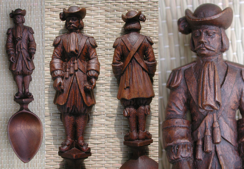

Another item in the african collection is not african, maiby there is a link with the sword? or maiby it has nothing to do with it , just wondering what the meaning of this spoon is, being in a collection between 70 other weapons and items who are typical Central Africa, exept for the sword ofcourse.
