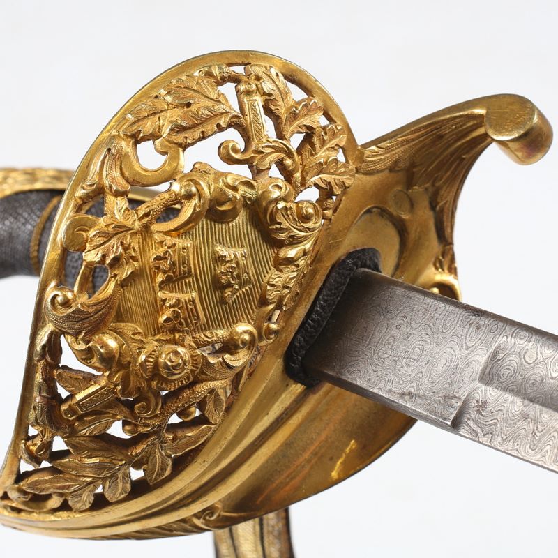

I don’t generally collect 19thC swords so my knowledge here is quite limited. From consulting the book “Blanka vapen och skyddsvapen” (1975) by Josef Alm it seems this sword likely is infantry officer’s sabre [sic] m/1859. There’s no picture in the book but the verbal description matches. The handle is made of gilted brass and the grip is covered with fishskin with seven scores in which there is twinned brass wire. The pommel is in the shape of a lion head. The guard plate is big and points upwards on one side with decorations and perforations, and smaller and points downwards on the other without perforations. The blade is decorated with partly gilted etchings and the inscription “Konungen” (the King) on one side and “Fäderneslandet” (the Fatherland) on the other. The scabbard is nickeled. There’s a version for underofficers where the grip is not gilted and lacks decorations with the blade. This model was superseded by the m/1899 infantry officers sabre which has a leather grip with 10 scores and a straight knuckleguard. For some reason straight blade Swedish swords from 19-20thC are called sabres locally, probably because of the grips. Technically I suppose they should be more correctly called pallasches. I hope this helps.

I agree with you that the m/1859 saber was used as the basis for my sword. But since this specimen was made to order and, apparently, by a wealthy officer, there are differences in the design of the guard and the blade. The figured cup is decorated with incised patterns. The blade is of an unusual shape, pay attention to the lower edge; I have never seen such a shape on broadswords.
Judging by the sheath - a holder with a fixed suspension, the broadsword bracket was made after 1875.
Regarding the names of Swedish sabers/broadswords, you are absolutely right, I couldn’t figure it out either, so I call it a sword.
Regards, Yuri.

In 2022, a saber m/1859 with an AR mark on the blade was sold at a Swedish auction
