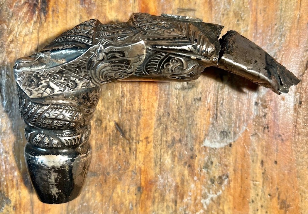

Here is how I got the hilt.

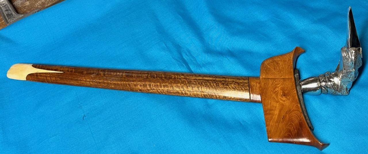

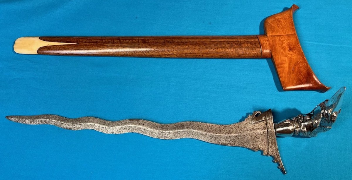

This is what I did with the hilt - I cleaned it up and made a new nose for it.
Everything came with it, even the secondary scabbard. However the scabbard was made for this blade.

I was also told that the selut was integral to the rest of the hilt.

That's a very admirable repair José.
Old 19th March 2024, 12:14 AM   #10
Posts: 6,436
You just get better and better with your work, Jose..
Very nice indeed.

This was on my bucket list. True - the original scabbard would have been best, but this was so affordable for me and I took the opportunity.
