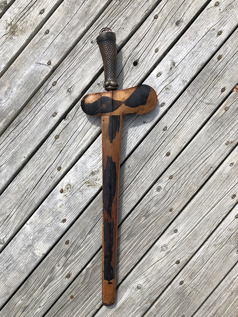

Hello all,
My name is Martin and I am from Amsterdam, i am a teacher in restoration and art history and collect since several years Keris mostly from Java Surakarta and Solo. Although the occasional Sumatra Keris is in my collection too.
After lurking for months on this forum about the Keris I will post my last addition to my collection. It,s a Balinese Keris I bought at an auction and it comes from a Dutch collection that was housed in a castle in France since 1923. Sadly no warong or mendak. It,s a beautiful blade I guess from the 19th century. ItÂ’s slightly rusted and I just started the removal of the surface rust.
Would like to know in what type of warong it would have been dressed..
Best wishes, Martin

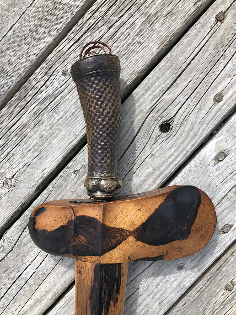

Hi Martin. Welcome to the forum.
I assume you are asking about what kind of sheath this should have? A warong means "stall" in Bahasa Indonesian, "tavern" in Javanese. You may have been thinking of the Javanese word wrongko (also spelled wrangka or warangka). Or maybe you meant "Sarong", which is sometimes used in Bali to mean a sheath.
If i am correct that you are referring to the sheath then there are a few options for dress, but i would say that the Bali version of the standard everyday dress (called gayaman in Java, the Balinese name is eluding me right now) would probably work best for you.
Also, the hilt rings in Java are mendak. In Bali they use a somewhat different style of ring called wewer or uwer. It should not be to difficult for you to find a wewer for sale on eBay or some other similar site. The sheath will be harder to come by. Sometimes i have seen used sheaths for sale on eBay that can possibly be adapted to fit your keris.
This seems like a decent blade and does seem to present as Balinese, though the greneng seems a bit strange me for 19th century Bali blades. Though i can't think where else i would place this blade.

Balinese wewer vary mostly with the materials used. Gold, silver, brass, etc, generally decorated with various stones, glass or pastes. The "stones" are usually white, black, red or blue or a combination there of. They are generally cabochon "stones', but more recent ones seem to have added cut stones or glass to the mix. Of course these wewer can be found in all levels of quality from simple and cheap to precious metals and really gemstones. Though in Balinese ensembles you will often find glass and paste "stones" in the mix. It is relatively easy to find wewer for sale in places like eBay. If the photos are good you can usually get a good idea of the quality of the wewer being presented, even if you can't be sure of the materials.

I believe I would accept this keris as being of Balinese origin.
In Bali the most commonly used word for a keris scabbard is "sarung", but the Javanese term wrongko/wrangka/warangka also exists and in Bali it becomes "urangka". In Bali the top cross part of the scabbard is called "sampiran" & the long lower part that covers the blade is called "penyejer" or "penabeng"
The name for the Bali everyday scabbard is Bebatun Pohan, customarily abbreviated to Batun Poh.
The usual spelling of "warong" is "warung", in Javanese speech & spelling the individual letters in a word, both vowels & consonants, often get interchanged, linguists regard Javanese as a non-standard language. So "warung" & "warong" are actually the same word, and both pronunciations would be understood in either Javanese or BI.
I do not know of the word "warong" or "warung" as having a meaning of "tavern". The English language idea of "tavern" would need to use "warung" or "toko" or "kedai" together with "minuman" (drink) to express the English language idea of a tavern. The way native English speakers understand the idea of "tavern" is probably not able to be given in either Javanese or BI with a single word.
As David has commented, the greneng is not really what we might think of as typical for a Bali keris. I'm wondering if this particular keris might be a bit older than it appears to be, or another possible reason for this greneng variation could be that it has been made somewhere out of the mainstream.
Still, all that perhaps irrelevant detail that I've written can be put to one side, this is a pretty nice keris, and well worth bringing back to life.
