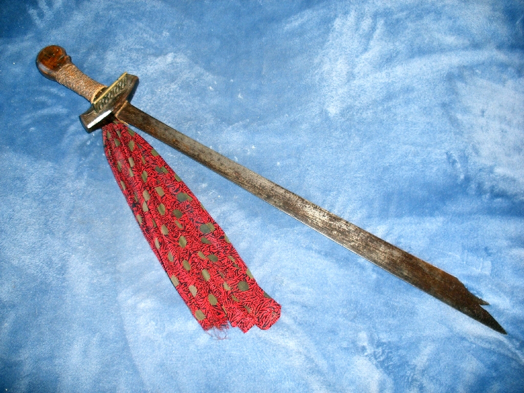

This post didn't catch any takers but figure I should show the sword now that I've received it and had time to clean it up some. I also have a question.
Here is the sundi I was asking about earlier. Note the inset circle below that was revealed by the etch. First I've seen with steel as these inserts are typically brass when they occur. This one would be invisible if not for the etching. Also note the wave pattern and contrast of the etched steel - the sundi looks like a boat on rough water...
Full sword

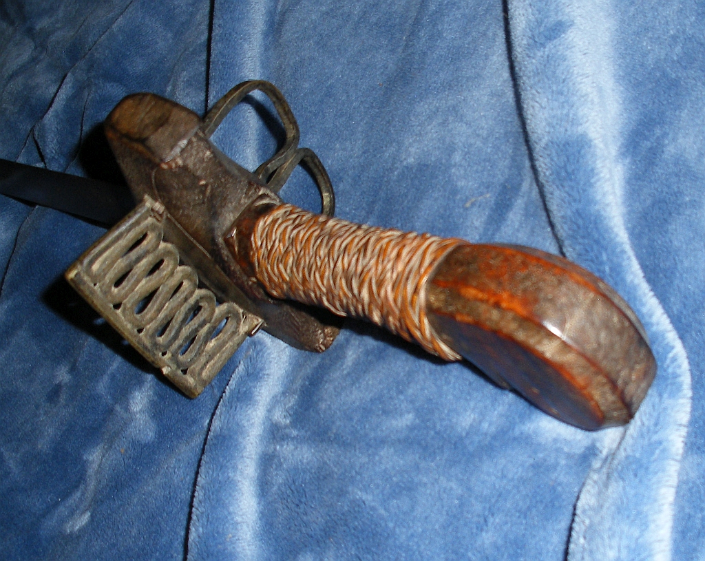

And question. What was likely using the second set of holes on the handle shown here? I'm
thinking a second piece of iron but worked with the series of vertical bends we commonly see on kampilan.

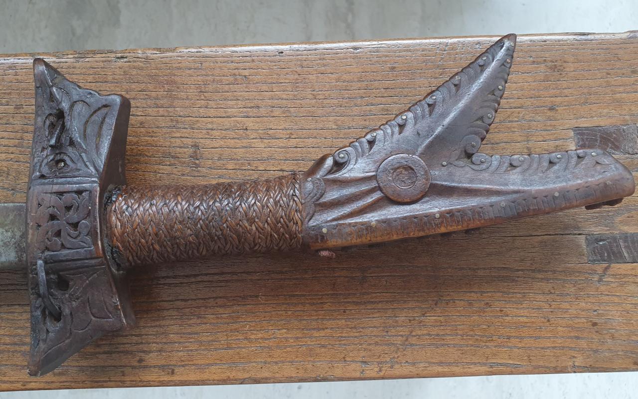

Also the complete hilt, note the brass pins that surround the pommel.
Old 18th October 2023, 03:56 AM   #3
Posts: 6,441
I think the holes were probably for another iron staple.

Hi Jeff,
Very nice kampilan and the etching shows a handsome blade. I agree with Rick that there was probably another staple guard in the holes that are now empty. As far as what the sundi may represent, we may never know because a lot of Moro symbolism is not explained to outsiders. The information is kept close to the culture.
Have you seen one with a double staple before? I'm tempted to replace the missing one but not sure what would be correct in terms of design.
Old 21st October 2023, 05:16 AM   #8
Posts: 6,441
Yes, I have one in my collection. The staples (for want of a better word) are made of brass rather than iron or steel. One of them is a cast piece and the other one is a simple hand formed brass staple. I have seen other Kamps with two guards but I haven't seen another like mine with a cast guard, nor have I seen another example with brass rather than iron guards.
The unusual handle is Banati wood and the cross guard is very hard dark Teak.
