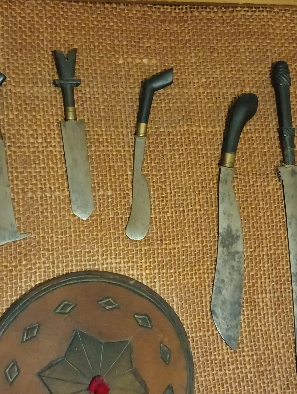

I have one like this un muy wall plaque.

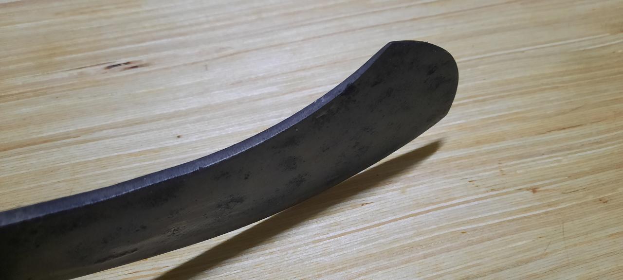

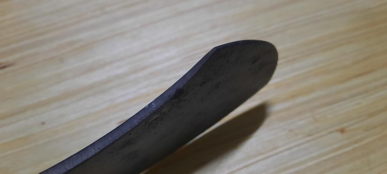

The cleaver-like blade is a little like the Lumad light choppers called purok bolos here but the rounded front of the blade and the distinctive badik-like bend in the handle would seem to have a specific function allowing both chopping and pushing. Is the rounded part of the blade sharp?

Yes, the rounded end of the blade is sharp.

I certainly don't consider myself to have expertise (just enthusiasm) but try to contribute observations to help keep the board lively. It is very exciting to see a new form posted that is one of a number of profiles found on the various "Weapons of Moroland" displays, such as Carlos posted, that we have not yet seen an example of on the forum. Hopefully folks come forward with additional examples to contribute to your post. This is known to happen sometimes years after the original post and is one of the reasons this forum is an amazing resource for simple enthusiasts like me and serious collectors and researchers.

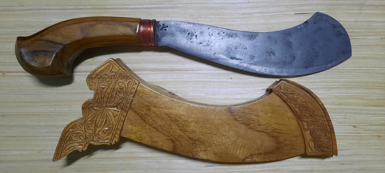

If this was indeed a Moro blade, it's probably a "janap", sometimes they also call it "utak" which is a cognate of the Tagalog term "itak". The edge seems to look similar.
P.S. The one at the top with rattan wrapping on handle is definitely an Ifugao blade, which is usually characterized by their socket handles, rattan wrappings and open scabbard. If it's pointy and has single edge, they call it "pinahig". If it's double edged, they usually call it "hinalung". Even then, these are general terms, but commonly used. As far as I know there are even more precise terms like "nauntukan", "pehlet", etc. because both pinahig and hinalung can have variations in blade profile, but my knowledge pales in comparison to those who actually know it.
Btw here's my janap, a recent sample from Sulu:

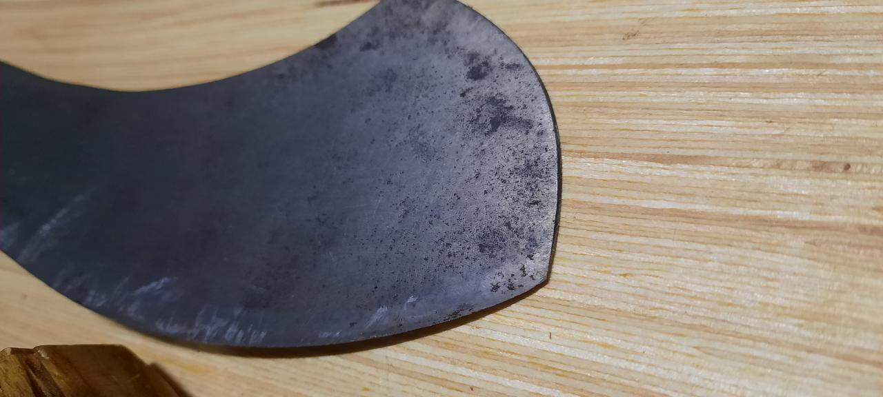

I'm far from convinced that this blade is closely related at all - the sharpened round tip seems to imply a specialized tool function rather than merely being a generic cutting tool. Also note the differences in the blade base as well as the hilt.
If this really is the modern version of the antique version shown above in this thread, it has seen a complete re-design like with the "modern pira" blades!

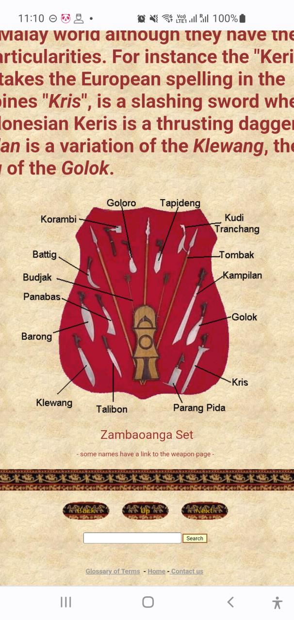

Just noticed that the Moro page on http://old.blades.free.fr/ has a labeled display calling that particular blade a gololo and defines the term as a heavy Moro chopper in the glossary of that site.
