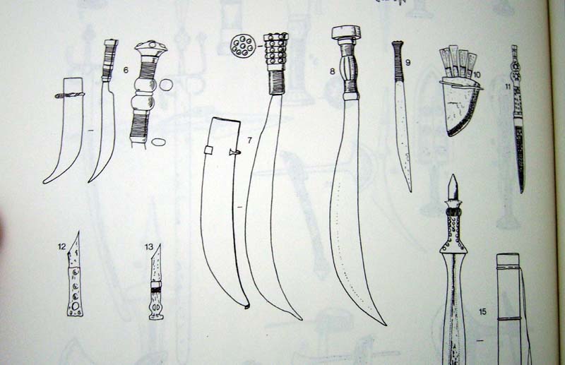

Tim, the attribution of the museum is right: the picture that Freddy shows is right attribuited to africa. Here is a picture from Westerdijk's book and the swords, that are very similar to the one shows by Freddy, are Hungaan (sud est Congo - Nord Angola). Anyway i think that Ian is right.

I think there is still room for discussion. These drawings are not really showing the same knife or details, yet we have two photos with the same form and details. Also the "T" section blade with similar details post by Ian.
