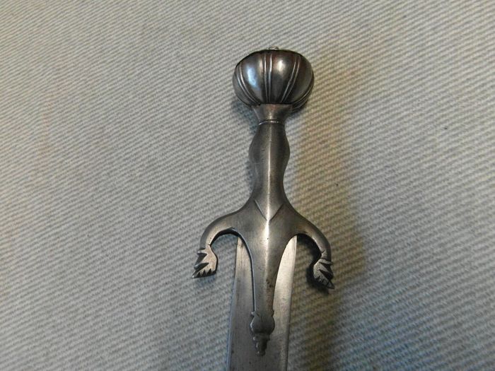

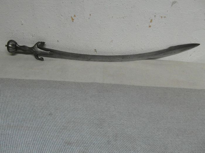

Just acquired this Pulwar from a collection in Germany, hopefully on it's way to me in a couple of days. Bit unusual blade with a short but pronounced yelman that looks sharpened. Haven't seen one quite like this before. No dimensions yet. Also no scabbard. eyelash markings on blade.
Comments please. Thanks in advance for any info...

I have several pulwars, most of them” with”unusual” features. But I can’t recall such an unusual yelman and double “jaws”.
On the other hand, “ oddities” are practically expected: Afghanistan did not have regulation weapons till the very end of the 19th century, all earlier examples were made in different arsenals and small workshops. The same is true about all other bladed weapons, from pseudo-shashkas to Mahsud ch’hurras. To a large measure this heterogeneity might be the most attractive ( at least for me) feature that vanished later on. It is a pity nobody can investigate this question and the identical twins of government-regulated ones somehow do not excite me.
If you do not mind, when I finally recover my post-omicron energy I might add some of mine to your example for general discussion.
Meanwhile, my congratulations together with a not insignificant dollop of envy:-)

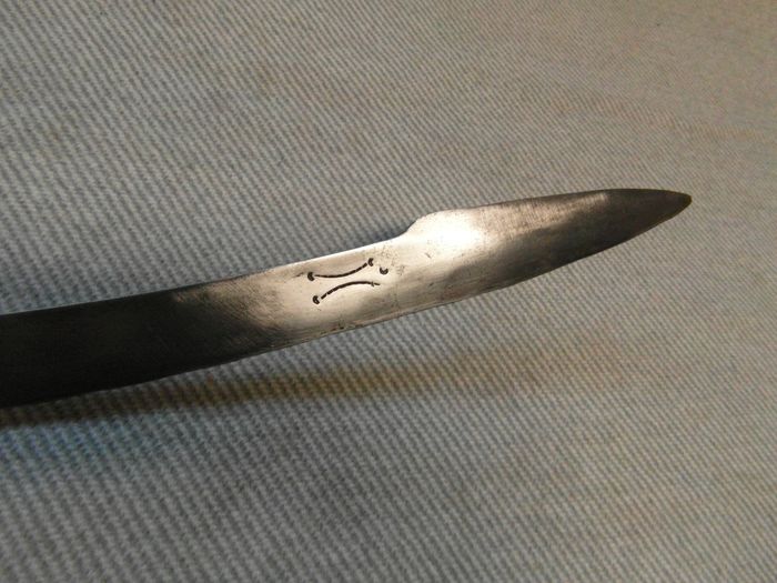

Perhaps the tip has been modified/shortened.
Old 15th April 2022, 05:59 AM   #5
Very good thought.
Although if we extend the curved line of the edge and the straight “spine line “ of the yelman, they will intersect at the most 1/2-1 inch from the current tip.
Would be interesting to know what is the current actual length of the blade. Then we can compare with the unquestionaly intact blades.

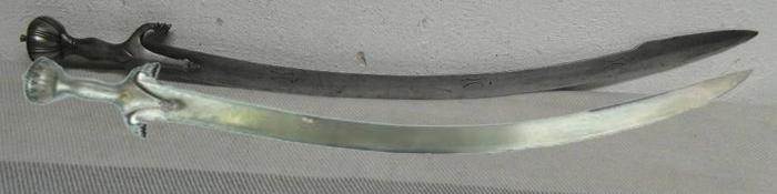

Until it arrives & I can measure it better, here is a pulwar from another thread superimposed on mine, using the grips to equalize the size. Seems to match fairly well.I considered that the tip may have been shortened. But .

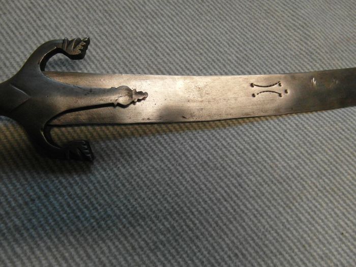

Blade is 30", 5mm thick, no distal taper until the 6 in. yelman, then distal tapers smoothly to the tip. no sign of shortening, blade is 1 1/2 in. wide at the langets, 1 1/4 in. wide at the start of the 6 in. yelman. the spine of the yelman is not sharp but has been made with about a 1mm 'edge'. Main edge is sharp, convex profile, and polished - no distinct bevel. Not hair popping sharp tho. Balance is about 8 in. from the guard. Weight is 1080 grams. Some small bits of black tarnish, but mostly polished bright. may have been renwaxed.No red rust at all.
The three sets of stamped eyelash dashes (jaws?) are terminated on the ends with a small crescent 'moon' and there is a single small moon in front of each. Did a small patch etch with vinegar/lemon juice after an alcohol degreasing, does NOT appear to be wootz or laminated steel. Of course if renwaxed, the acids wouldn't etch.

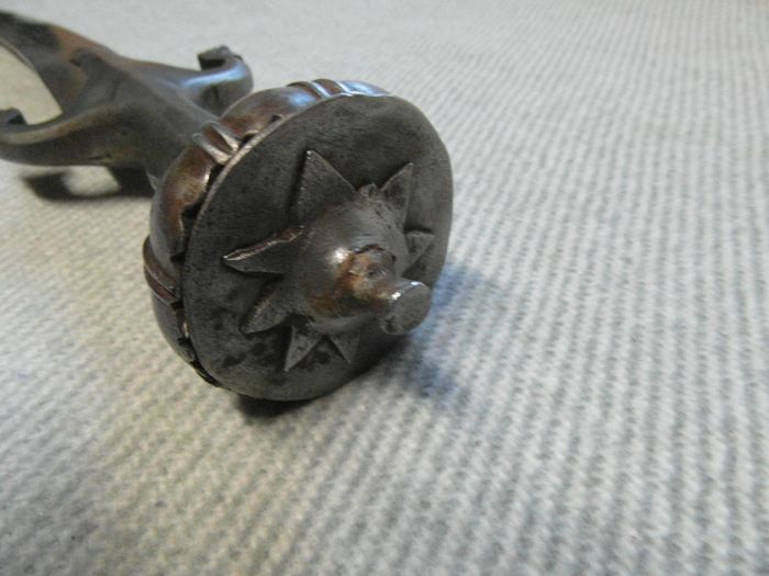

Grip is tight, undamaged, more comfortable than a tulwar, pommel is peened, and has some bits inside the hollow that rattle if shaken.
