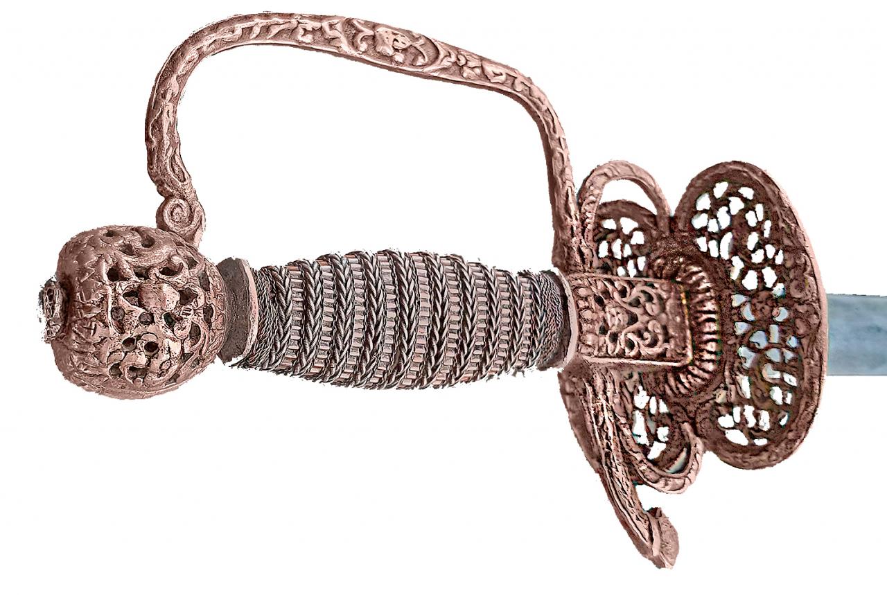

I recently acquired this Shotley Bridge smallsword.
During the six years I have been researching Shotley swordmakers I have only ever seen three (including this one).
The hilts of the other two were also brass but not figured and pierced.
When I was photographing the sword I discovered that the lower surfaces of the hilt were copper plated. At first I assumed the upper surfaces had not been plated and they had achieved a two-tone effect, but closer inspection revealed that some of the upper surfaces in areas un-rubbed were also copper plated.
I believe, back then, they referred to this copper plating as Japanning, and it was vicious process involving the burning of a mercury substrate with consequent poisonous fumes.
In keeping with the copper bindings it is now obvious the entire hilt was copper plated.
Is this a common effect on smallsword hilts?

Default copper plate
This is what it would have looked like new:

Or maybe not. The copper finish is more likely the result of surface enrichment . This occurs when an alloy suffers from corrosion which etches out one element of the alloy ,in this case the zinc leaving copper on the surface Not suggesting your sword has ever been buried but aggressive chemical cleaning can have the same effect. Lavatory cleaner used to be popular. Good for cleaning very dirty brass but can leave a superficial coppery finish easily removed with steel wool and polish.

I believe Raf is onto something. In the past I've cleaned brass and it resulted in this effect. Using acids can also transfer the colour onto steel components. The sword is far too early to have a copper base before plating with nickel etc. I believe plating began in the 1840's.

If you look at the earlier 'genuine' image of the sword hilt (before I photo-shopped it) you will see the areas of copper plating predominate in the lower surfaces and the areas where little to no contact has been experienced.
As far as I am aware, but I hasten to add I am not an expert in this field, copper sulphate or maybe copper oxide, I don't know which, was mixed with mercury and applied to the brass which was then baked so the mercury evaporated leaving a copper plating behind.
This was the same process used to gild those blue and gilt blades that became so popular.
Obviously, this was a hazardous process and life expectancy was poor, which was why it was a luxurious finish.
Electroplating was not established until around 1810.
My suggestion is that it was done for time at sea, apart from the excellent look.
You will also note that the colour I used to 'plate' the image was taken directly from the existing copper finish.

The other giveaway is the copper binding on the grip: the way it looks perfect against the copper plate finish but odd against the brass.
My theory of nautical purpose would actually account for the high copper content of the brass.
I've been thinking about this and looking at the use of 'Naval Brass' which apparently has a 70% copper content.
If the zinc is leeched out of the surface then what you say is highly probable and the reason the copper finish is restricted to untouched areas may well be its removal by wear and/or polishing of the surface.
Yes, I see what you are getting at.
Pity, I rather liked the copper finish and, as I say, it blends well with the copper binding. That, of course, may again be due to nautical purpose.
Thank-you Raf.

With regard to the suggested copper plating of the hilt of my sword, I am now firmly convinced that Raf if correct in ascribing it to 'surface enrichment'.
I know this will horrify dedicated collectors but I am tempted to re-create that look.
Raf mentions lavatory cleanser by which I assume he means Domestos or Clorox bleach... hmm.
It can always be removed, can't it?
