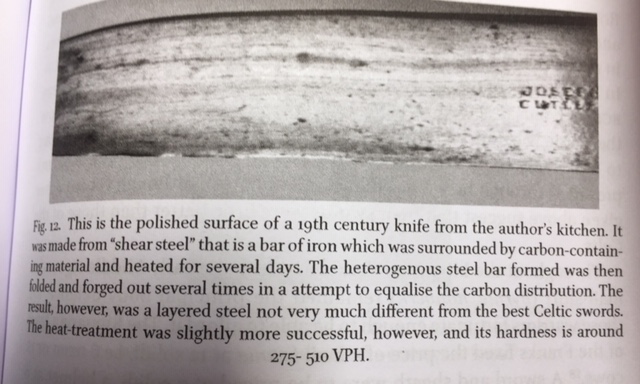

Developments by Huntsman in the 1740s reflected refining shear (blister) steel in crucibles. In following decades, we see a fair amount of sword blades made from these refined steel ignots. These differ from wootz cakes but are still a crucible process. Until Bessemer comes along, this cast steel was a superior cutlery (and spring) steel as an option. We still see "best cast steel" listed for drop forged tools well into the 20th century and indeed, lots of steel is listed as crucible steel.

The billet may well have been "fluid cast steel" but it went through a forging and rolling process, which doubled it's length, halved it's thickness,and gave it a better grain, and more resilience. Even so blister steel aka shear steel was still being used for some blades right into the early 20th century.

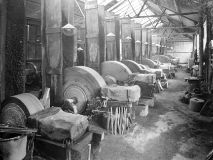

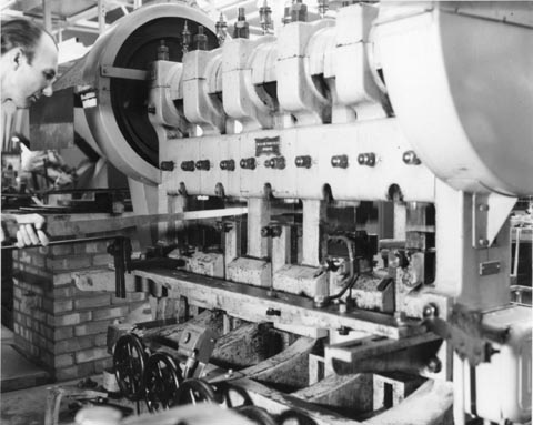

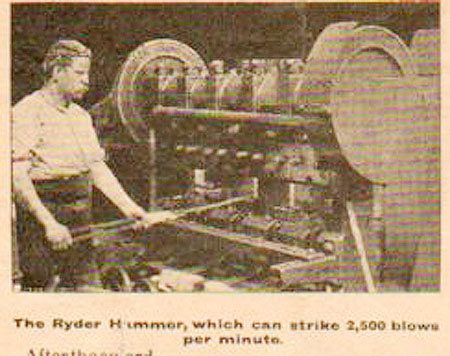

Some bayonets were made by "drop forging" but still not cast. Below are pictures from a sword factory of automatic hammers and grind stones used in the forging of blades in the late 19th century.
I think if you want to back up the casting of blades theory we now need to see some evidence, video, photo or documentary.

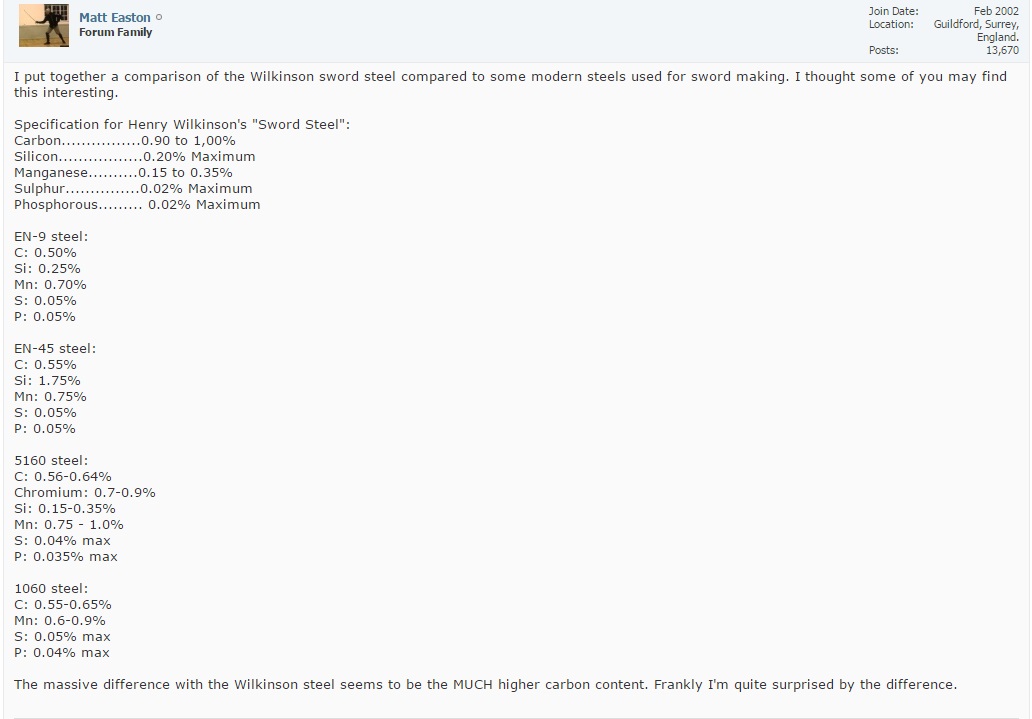

I can't quote figures here but I can say that the iron in the Wupper Valley had a very high Manganese content which reputedly accounted for some of the reason for fine blades.
I notice that the WS manganese content is very low compared to the rest of the steels.
Did Solingen eventually need to import their ore?
