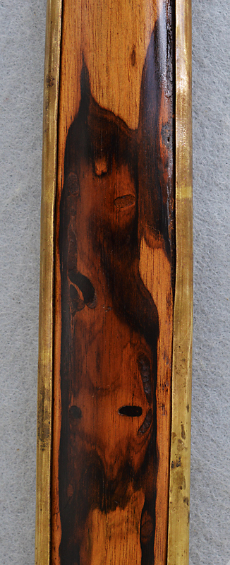

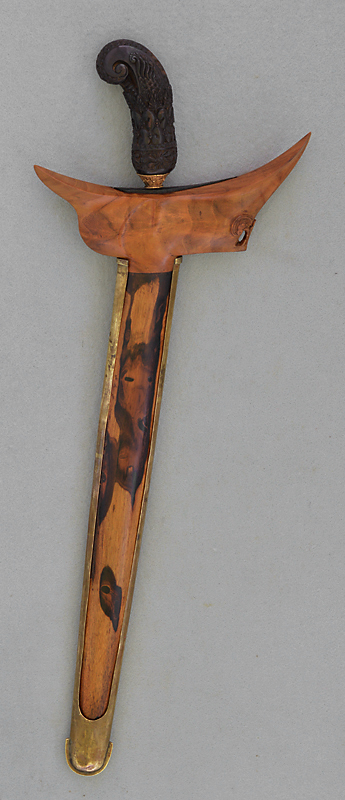

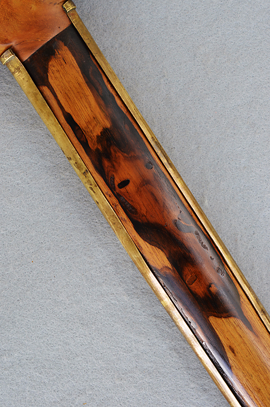

![]() I think i would hesitate to say that such patterns in the wood are on a "equal" footing with pamor patterns in terms of significance and importance. The blade is always central to any keris regarding such things. But certain wood patterns are indeed highly prized and do hold a certain protective status. Here is an example from my collection that displays what is known as "Dwi Roh" motif on the gandar of the sheath. This means "Two Spirit" and refers to the two ghostly faces that can be interpreted in the timoho wood of the gandar. This is a rare motif that is considered to be a protective device. In this case this motif was considered important enough to preserve and was fitted to a newer top sheath (gambar) of kayu jati gembol (burl teak). I am not sure how the vertical Adeg lines of your gandar should be interpreted, but probably not in the same way as when we see such a pattern as pamor in a keris. We tend to see the horizontal lines that appear on your gambar more often. But it is probably fair to assume that they are deemed as protect devices in some way or another. |

very beautiful and absolutely “ spooky” image on the Gambar (or Gandar as I’ve hears it called over here).
Of course the blade or wilah is central , however since it is someone’s choice how to dress it , I thought there may been some similarities . Incidentally one of my krises has also an “ image” in the blade resembling (to me, others don’t see that) one of a skull or something like a face, probably not more than the shape that one sees in the clouds, yet, what the augurs saw in anything which they used to predict the future was also probably something of this nature. ![]() |

![]() Quote:
![]() When we see figures or faces in pamor patterns these are generally unplanned events and considered to be talismanic and powerful because they are "Acts of God". It is called pamor Raja Guntala. These pamors can have different significances dependent upon what they seem to depict. Never heard of them being used to predict the future though. |

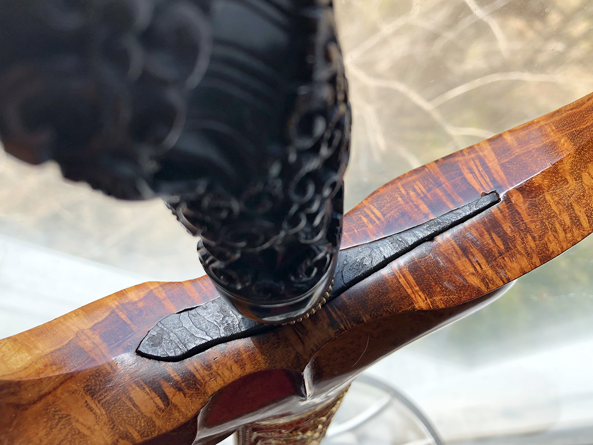

I will add that sometimes the choice of specific patterns in choice woods might be done simply for decorative purposes. Here is another example from my collection of wood grain that seems to be positioned to match the pamor pattern on the bottom of the gonjo. I don't believe this was done with any esoteric intention in mind, but rather to create a more complex ensemble feel.
It will be interesting to see what pamor pattern hides underneath the rust in your blade. If it turns out to be an adeg pamor there might be some connection to why the vertical lined wood was chosen for your gandar. Though more often than not i believe that people were more inclined not to want to reveal what pamor lies within their sheath, so maybe showing it publicly on the surface of the sheath would not be a popular idea. |
