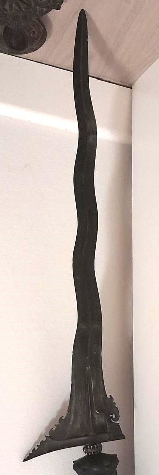

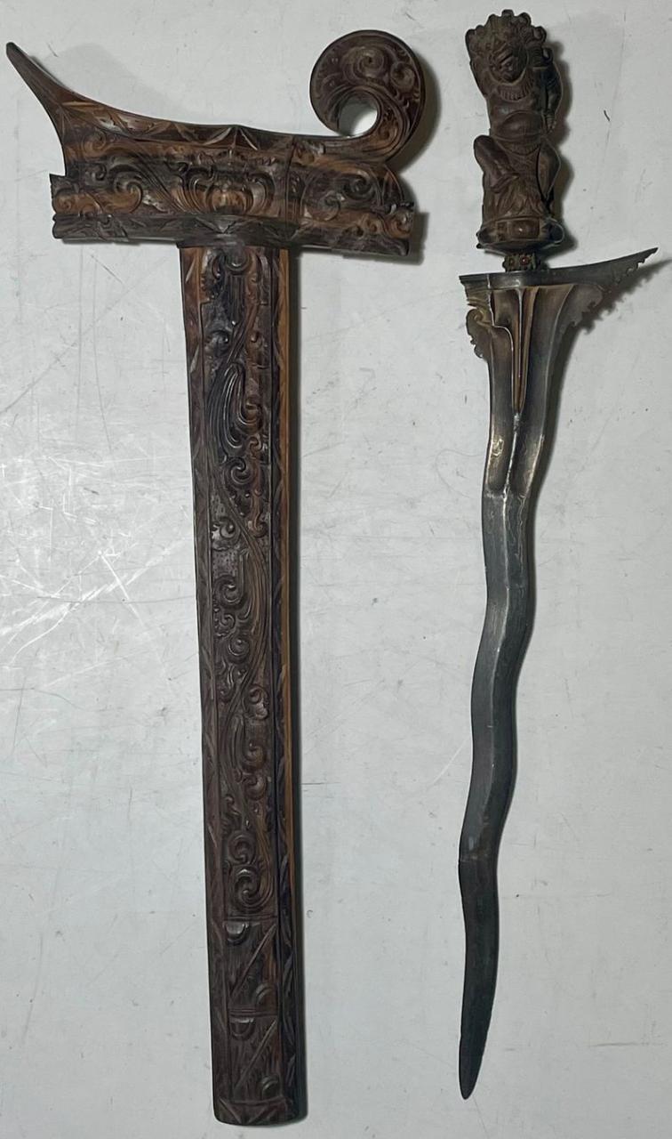

Good morning dear members,
I wanted to ask your opinion please on this keris,
It seems not too old.
I'm not a specialist but
I have already seen this model several times, souvenir keris '' for tourists'' and often of really poor quality but this one caught my attention : large model: 65cm long/25,6 inches .
the blade is heavycand seems of good quality and the handle is very finely detailed.
what do you think please ?
Kind regards

Old 15th December 2023, 09:15 AM   #2
Posts: 7,134
Good blade, dress for tourists.
Re-dressed it would be a very nice thing, but re-dress might not be so easy.

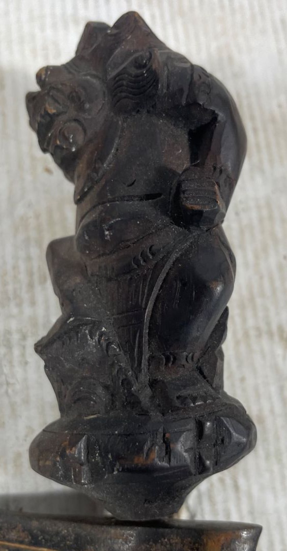

Old 15th December 2023, 01:37 PM   #3
Marius66
Join Date: Jun 2019
Posts: 131
Thank you for your message !

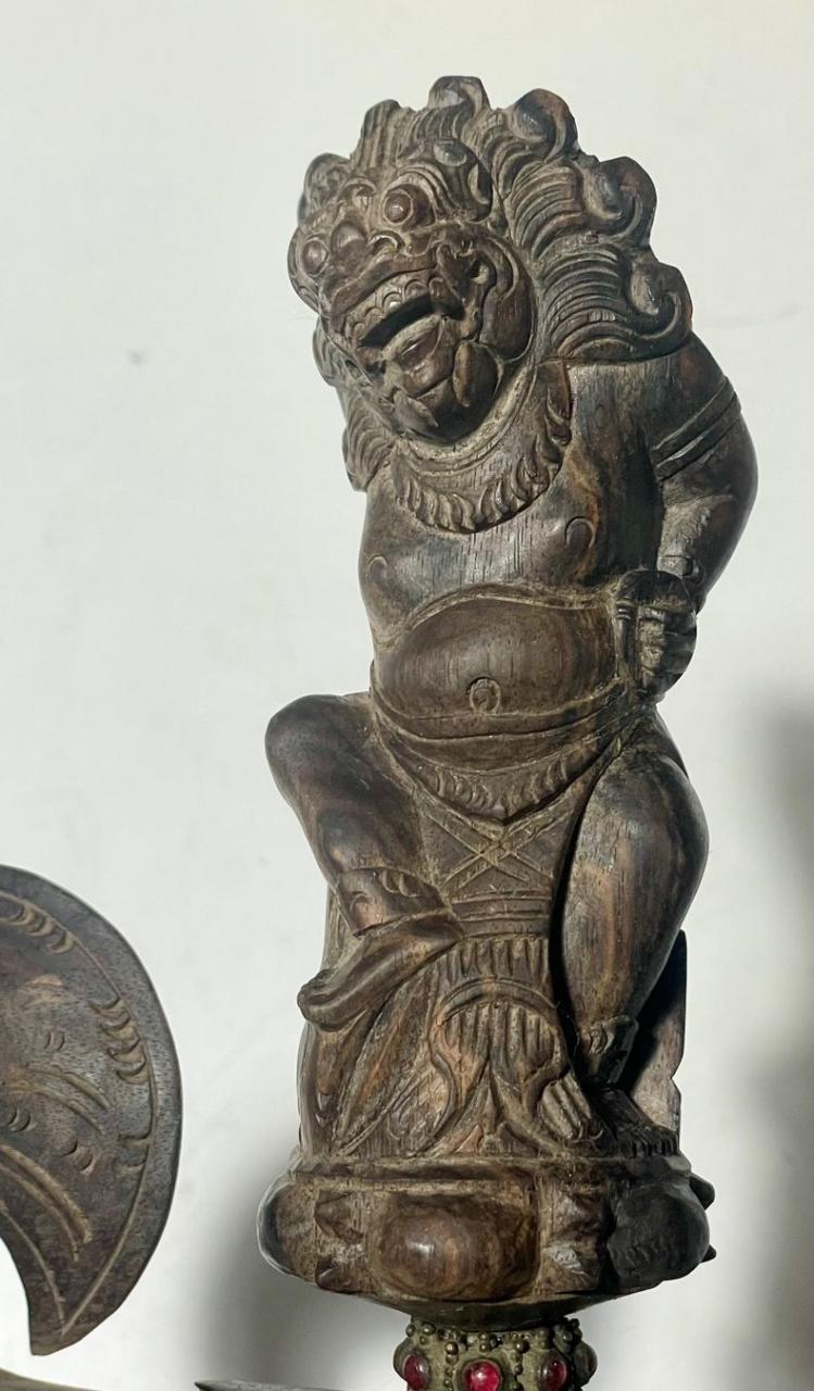

Even the hilt is a bad one ? I find it is carved really carefully in comparison with other
'' similar'' tourists models
Can the blade be an old one ? I will post other pictures.
Kind regards

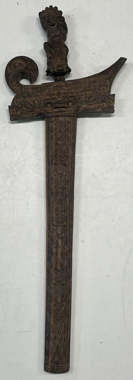

This one for comparison is a cheap basic made for tourists hilt model

Old 15th December 2023, 08:57 PM   #6
Posts: 7,134
Gotta sleep sometime Marius, Saturday, 6.37am here, what time where you are?
The blade is old, pre-1900, how much older than that i cannot say from a photo, & maybe cannot say at all, but it was definitely made as a keris, by a pande, & for a Balinese man.
The dress is early for this type of keris, post 1960, pre 1980. I'm guessing here, I know the story of the origination of this dress style, but it is difficult to put a precise commencement date on it. Certainly the style came about because of the tourist flood, and that did not really begin until late 1950's. There were tourists into Bali from not long after the puputans, I think around 1920 would be a good start date, by the 1930's it was certainly on the international bucket list, then there was WWII, the Merdeka struggle, things were still pretty fragile into the 1960's --- tourists generally like to stay away from places where thousands of people are being put to death in very bloody ways.
The consolidated opinion of most informed people seems to be that the last "good year" in South Bali was 1982. After that Bali began to become the Disneyland for adults --- which it now is.
So, dress, 1960 - 1980.

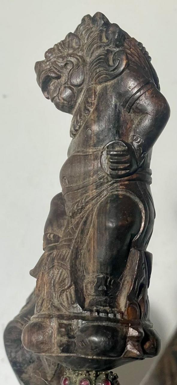

The quality of the carving is pedestrian, not done by an 8 year old child, it was done by an experienced carver, but he was in a hurry.
This type of keris has now become a valid collectable in its own right, and this one is a pretty fair example of the style. What it is not is a fully traditional style that could be worn by a Balinese man.

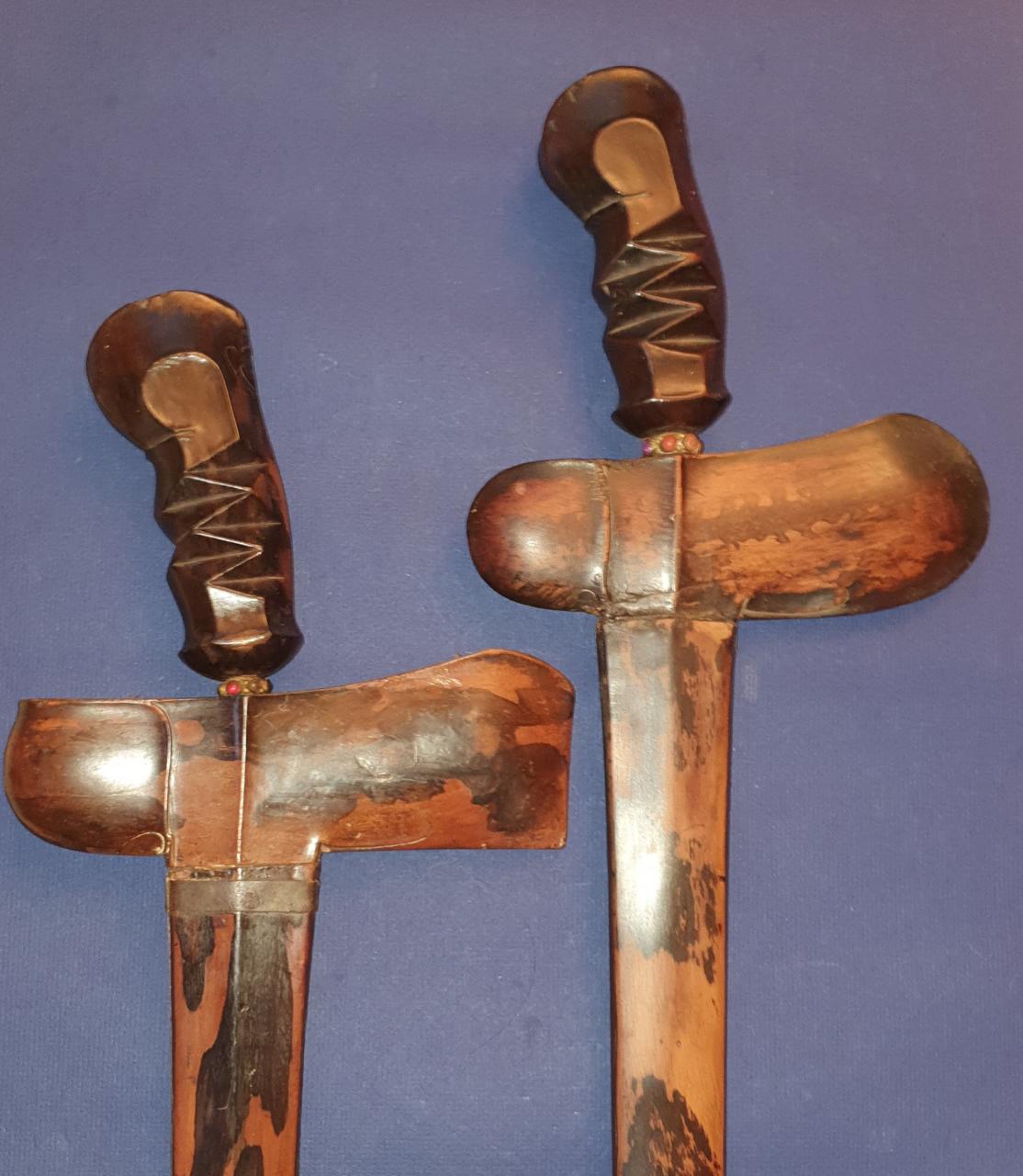

Old 18th December 2023, 04:31 PM   #14
Posts: 9,498
Hello Marius,
When you plan to give the blade a new scabbard I would use for this blade one of the two shown examples.
BTW, sometimes you have to wait much longer than a few hours for a comment!

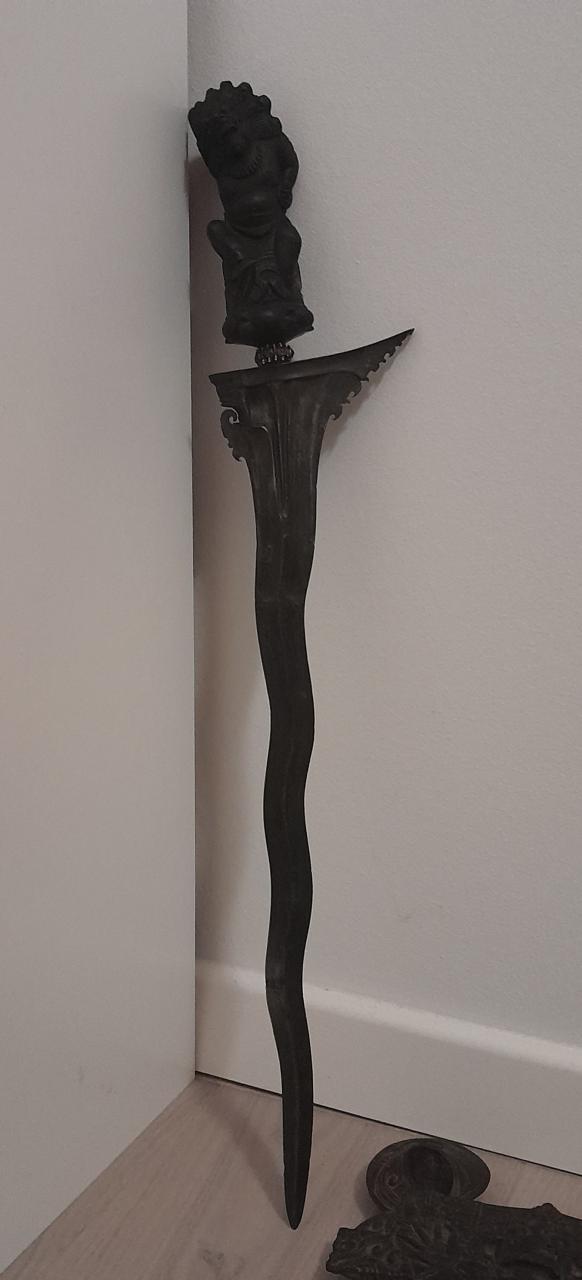

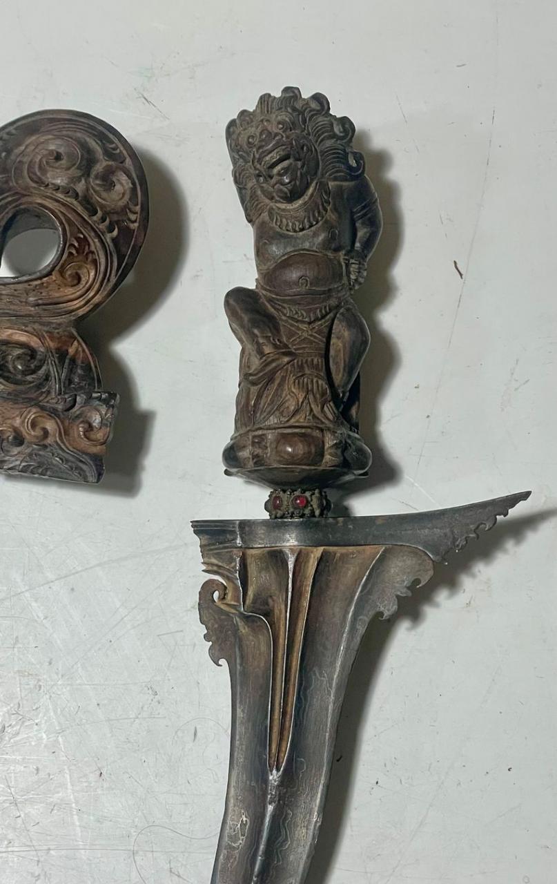

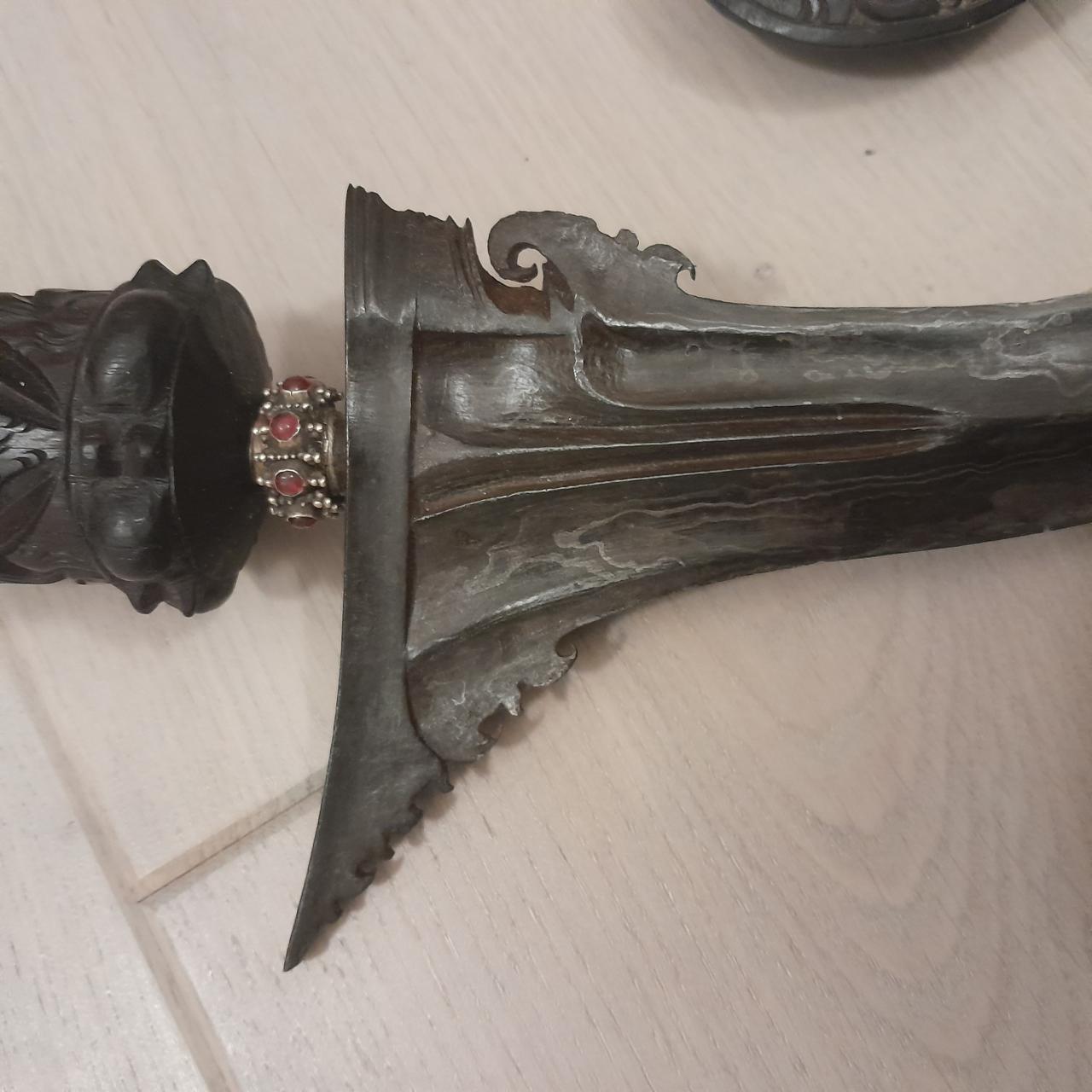

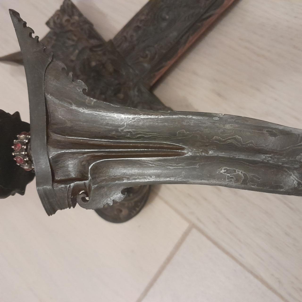

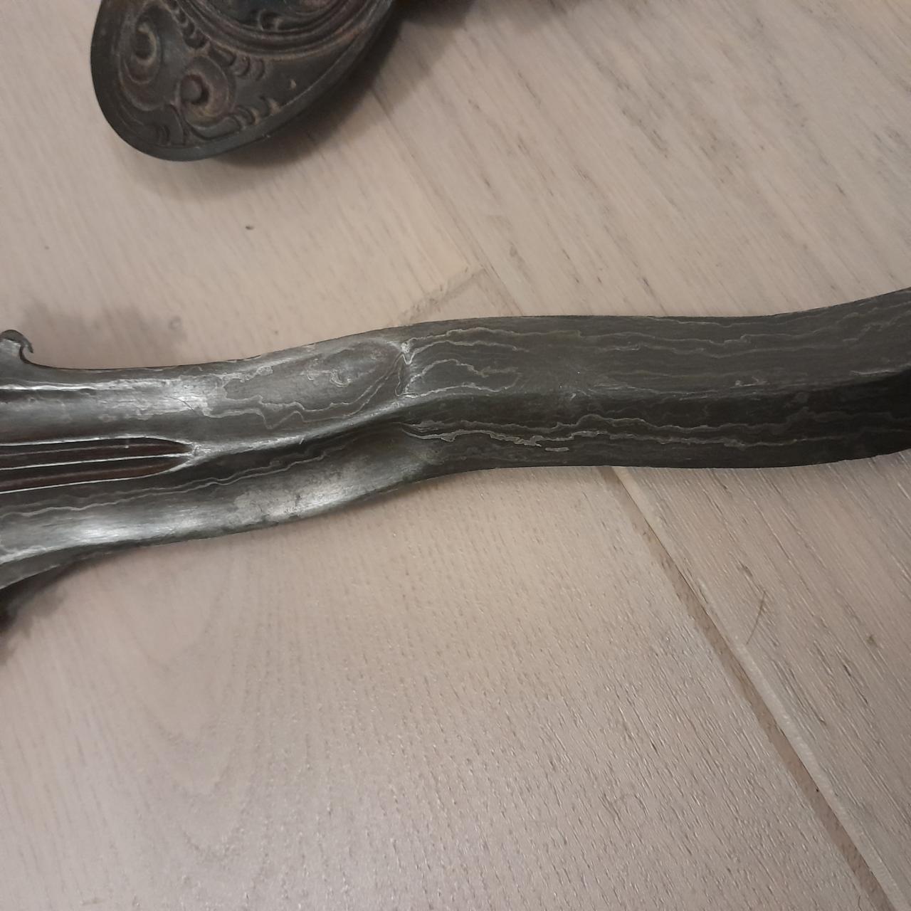

Here are some other photos I took of the keris,
I cleaned the blade a little with 1000 grain with WD40 (surely there's something better to do?) the Mendak, I think that's its name, doesn't look bad I think ??
What do you think ?
Marius66 is offline   Reply With Quote
Old 21st December 2023, 01:51 PM   #16
Marius66
Join Date: Jun 2019
Posts: 131
Here a global picture,
Without picture zoom , the blade is almost black
Old 21st December 2023, 02:45 PM   #17
Posts: 9,498
The blade looks good after your cleaning. And the uwer (mendak is the Javanese term) looks very nice, I guess that it is from silver.
But like others have said, I would look to give the blade a better handle and an other scabbard, I think the tip from Milandro is a good one.
Sajen is online now   Reply With Quote

milandro
Join Date: Jan 2022
Location: Netherlands
Posts: 498
looks like a nice blade
I personally wouldn't touch it with abrasives and would ask a person to use Warangan to clean it further with traditional methods
milandro is offline   Reply With Quote

Posts: 7,261
I agree with Detlef. Your clean-up looks pretty good. And that uwer is a nice one now that you cleaned it up. It does appear to be silver. The stones might actually be low-grade rubies, but even if they are glass it still looks like an old quality uwer.
You could take exacting measurements and trace the blade from all angles on paper and hopefully find someone in Bali to make you a new sarung if you are really keen on changing out this dress. You would undoubtedly need to do final adjustments if you did, so i would ask that they send it to you before attaching the gander.
As for warangan, you might have some difficulty finding someone who can do a good Balinese warangan job. This keris still seems to retain some of it's old Balinese stain. I might choose to simply preserve it as is considering this.
As for abrasives, i wouldn't worry too much about doing any damage with 1000 git paper or 0000 steel wool.
Looking at the cleaned up blade i would say that it is of a fairly decent quality. Competent, but not what could be considered high end. In other words, i wouldn't spend more money than the blade is worth redressing it.
