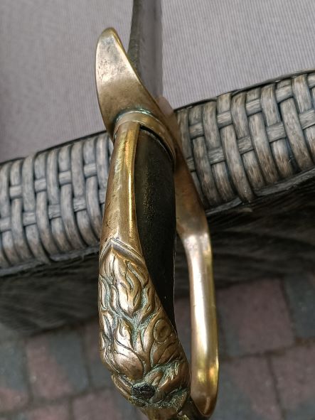

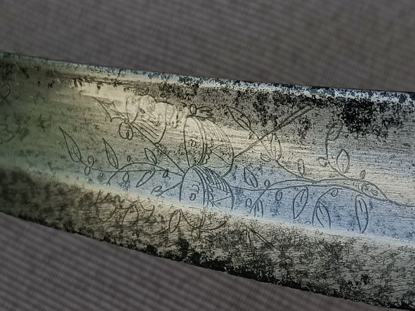

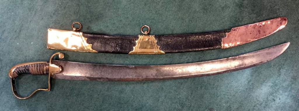

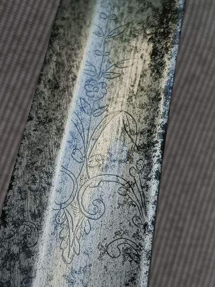

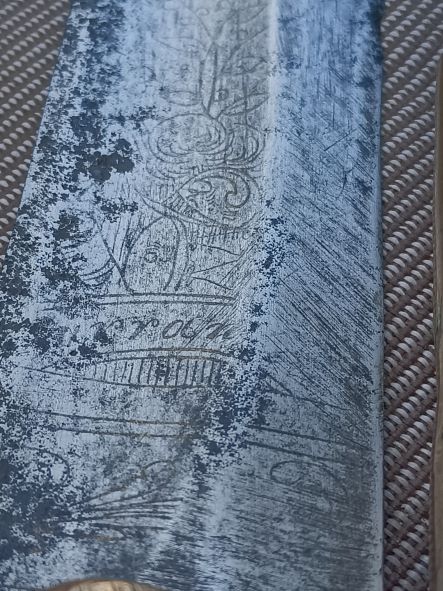

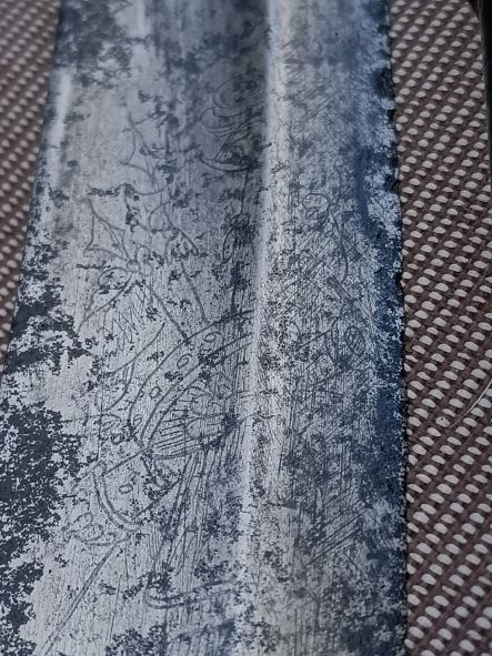

Hi, I have this little sabre what looks like a 1803 pattern infantry officer sword. Not sure what to think of it but maybe someone knows what it realy is?! The length of the blade is 55cm. Overall length without the scabbard is 66,5 cm. Despite the wear It is still razor sharp. Floral motives on the blade with some traces of guilding.

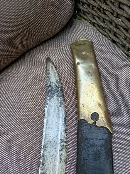

The handle is simply wrapped in black leather wich seems original to me. The scabbard has an old repair on the locket and a later repair where it probably broke in two. Overall, it has seen better days.

A flank sword with only 55 cms, cel7 ?
Must be something else ... i am afraid .
Can't you figure out what some the letters on the blade say ?
Let us hear from the members !

I think that the text says "warranted" That makes it plausible that it is British. But you are wright Fernando, probably no 1803 pattern sword.

The 1803 flank officers sabre had a slotted hilt guard rather than a simple stirrup so this is definitely not an 1803.
However sabres became popular with British infantry officers in 1796 when the much maligned spadroon was introduced and a wide range of sabres and hangers were carried unofficially. The British military recognized the issue and passed orders allowing flank officers to carry sabres in 1799 but no official pattern existed until 1803. What you have could well be one of the unofficial 1796-1803 sabres.
It is worth noting that some regiments "standardized" their non pattern sabres and continued to use them as regimental pattern after 1803.

I would not discuss the pattern of this sword. I just find it rather surprising that the blade of a cavalry sword, or a sabre, even the flank version, would measure 21,65 inches .
Old 15th August 2021, 11:06 AM   #7
Posts: 4,285
A short-sword, or hanger. Naval officers fighting sword?? Police of the period carried hangers on occasion. An overall photo of the sword and the point is usually informative regarding it being shortened. Engravings like shown are moire typical of pre-pattern swords.
Old 15th August 2021, 11:14 AM   #8
David R
David R's Avatar
Join Date: Jan 2011
Posts: 1,161

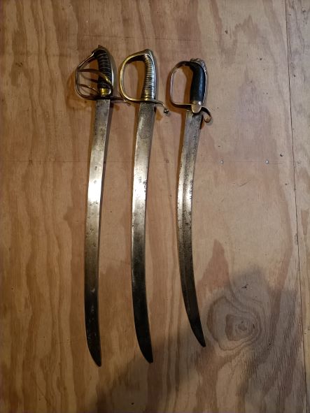

It certainly is short, even for an infantry officer and more like a hanger or sabre briquet, but!
In preparation for the war with France in 1794, all ensigns under eleven and all lieutenants under fourteen were removed from post. There were some very short officers in the British army.
Myself I think it most likely to be a drummers or bandsman's sword due to the lack of gilding and other detail.
