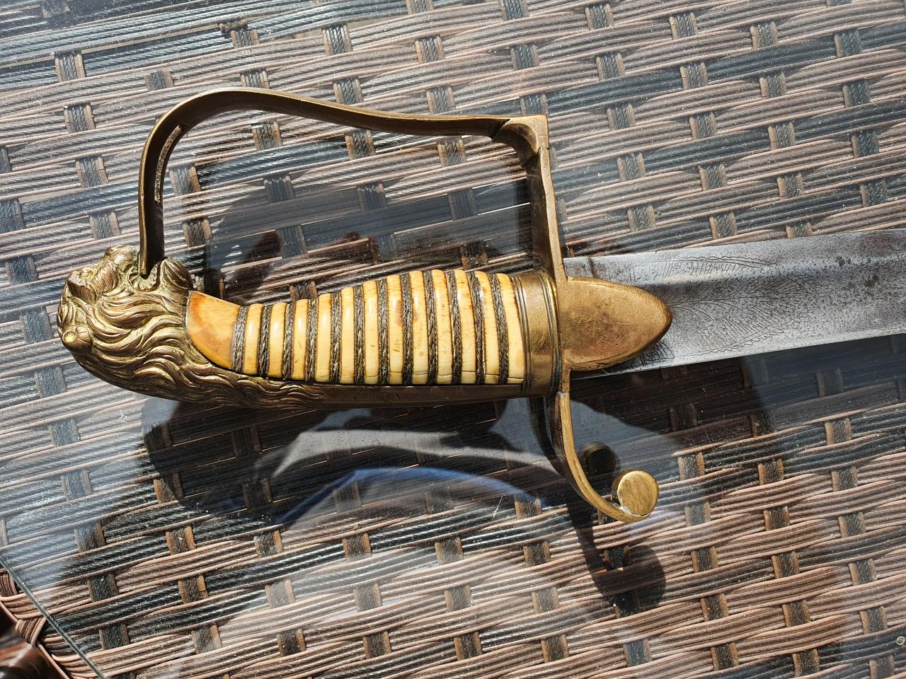

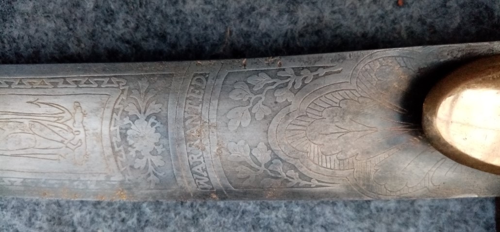

Hello!
I am curious about the depicted sabre. Unfortunately no scabbard..Grip seems to be of ivory and the stongly curved blade is etched with British coat of arms and "Warranted".
What exactly was under the warranty? Blade of course, but in what aspects?
Hilt has traces of guilding and also the blade.
Any other information about this is highly appreciated.
Best regards/Ulrik Sjöberg, Sweden.

Interesting Georgian saber probably c. 1804, the lionhead resembles the M1803 British infantry and flank company officers sabers but without the pierced knuckleguard w/ cypher.
The grip reminds me of naval officers swords of this period.
The 'warranted' was of course to the blade, and arose with the 'sword scandals ' of the late1780s where Thomas Gill of Birmingham challenged the German imported blades which were dominating the contracts for East India Co.
There were tests on the blades and he was joined by Henry Osborn and James Wooley. These makers took to marking the blades 'warranted' (Gill used 'Warranted Never to Fail").
It seems Osborn often used the warranted word alone, not sure on Wooley.

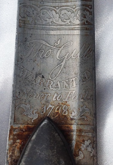

Below is a photo of Thomas Gill's full warranted spiel on a 1796 light cavalry officer's sabre.
Cheers,
Bryce

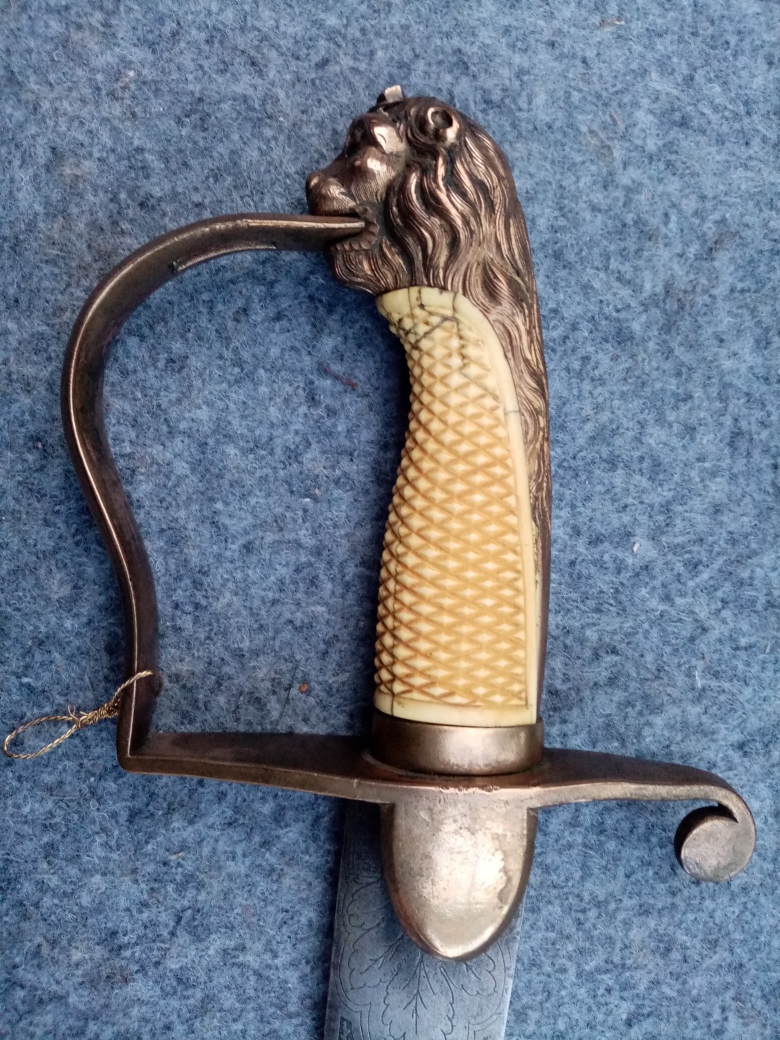

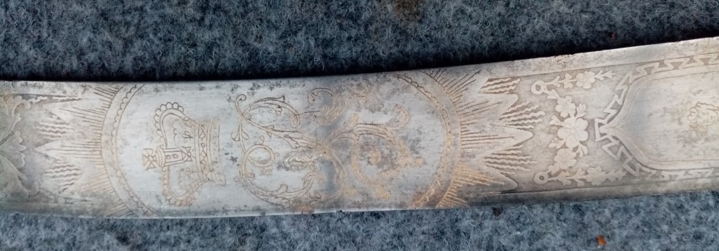

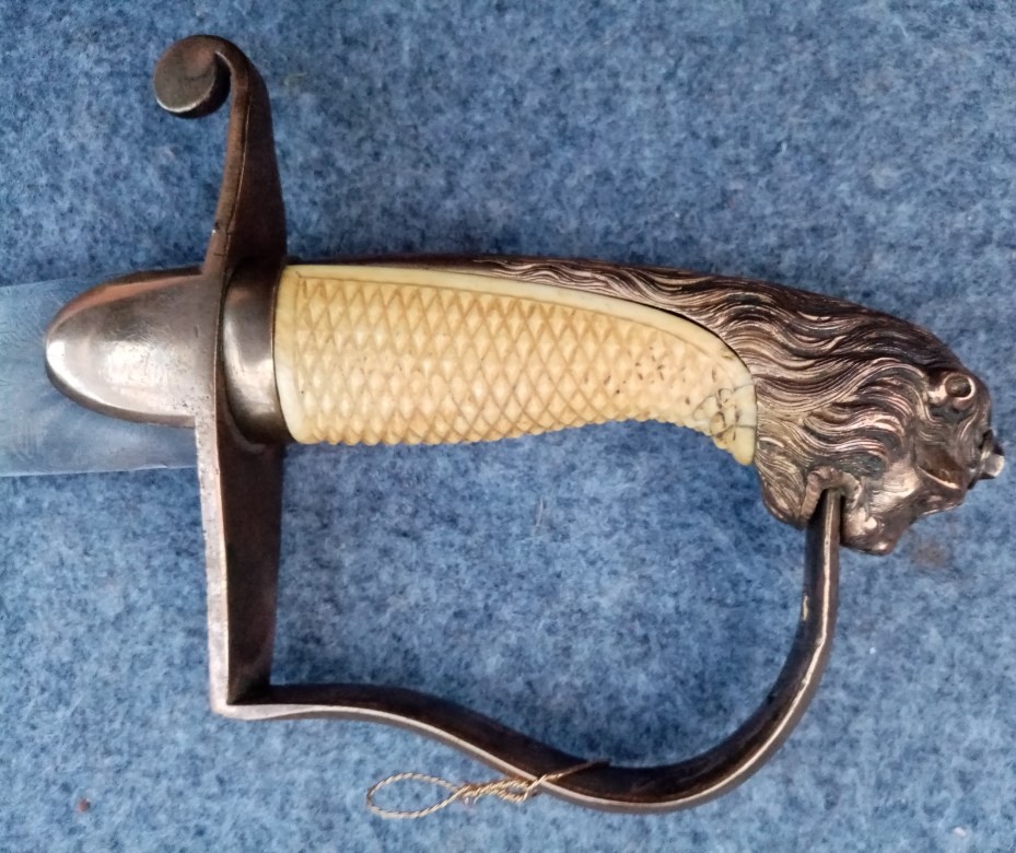

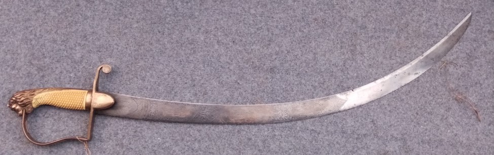

However, the idea is, I want to know the sword will prevail BEFORE I take it into battle. There had been long periods of terrible blade making in England, and Gill et al, decided it was time to stop depending on Germany for blades and build the English reputation.

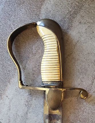

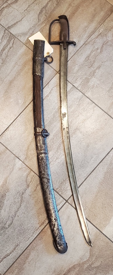

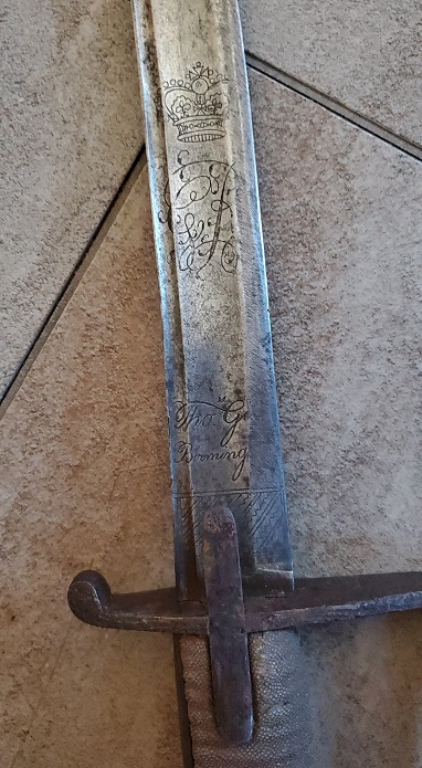

First three pics are a Thomas Gill M1788 cavalry saber, warranted on blade back.
The ivory hilt saber is M1796 yeomanry officer with curious saber knot bar near cross guard. These yeomanry officers had even more latitude than regular regiments officers so the individuality was notable.
These examples are not in great condition but just illustrations of the forms.
