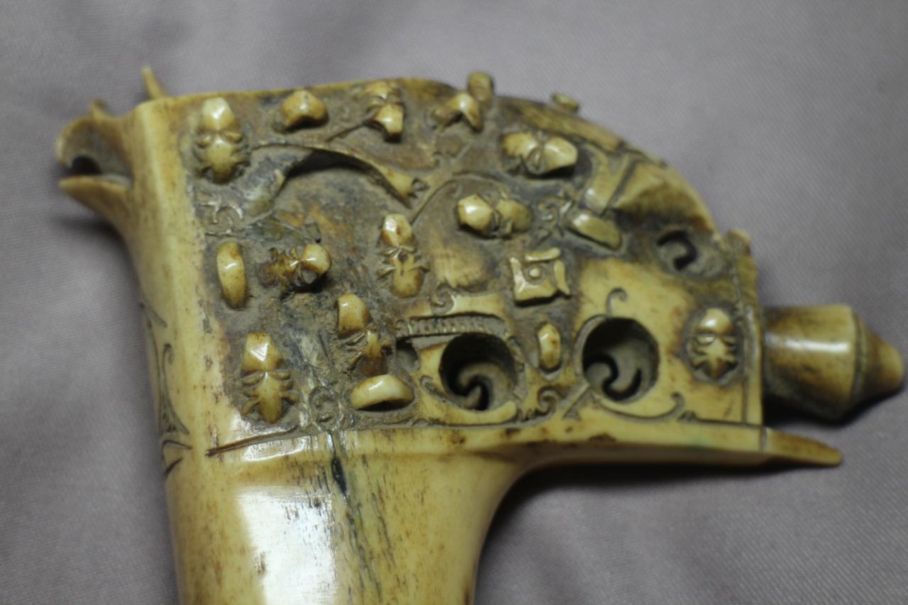

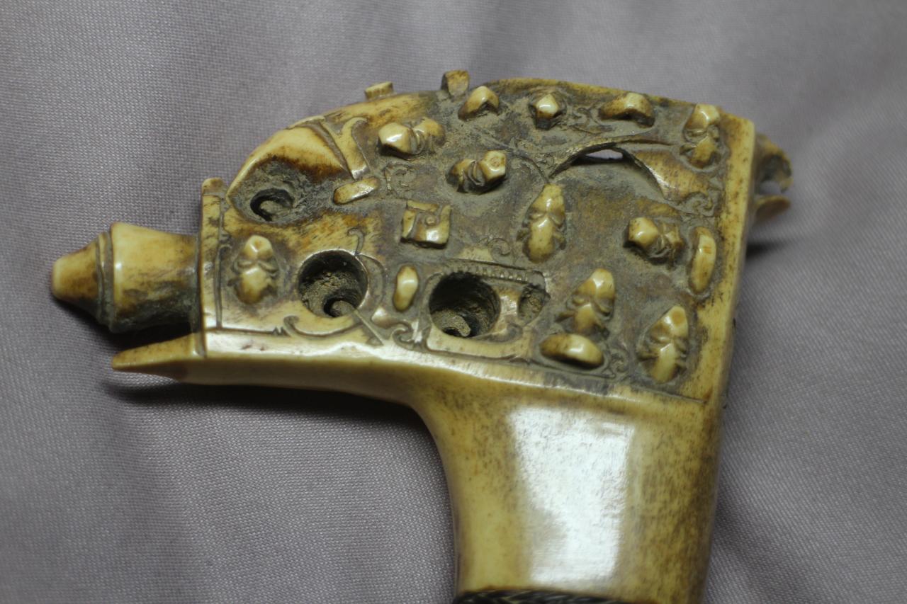

I have this mandau hilt with motifs that I have not seen before. On both sides of the hilt surface, there were several carvings that Look like little heads/skulls?
Are these merely whimsical decorations or are they also some form of cultural symbols/meanings like lemantek (leeches) or Aso?
The hilt has a good patina and probably quite old.
Can you fellow mandau lovers/experts give comments and also which dayak tribe/region this is from?
Thanks in advance for your comments.

I think they are little dragons (aso's) surfacing. Very nice.

Hmm, I don't see aso here - no teeth? Could you please explain or show similar motifs?
From the available pics, I'd lean towards heads (or aliens ).
Nik, could you post close-ups of the pommel with better resolution, please? (You may have to throw more light during photography for better results.)

I also don't think these are aso, and they look like little heads.
I will try to take close up pics when I'm back home sometimes next week.

I mean aso heads, I see a nose , 2 eyes and 2 ears.
