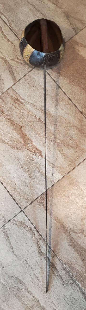

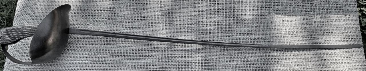

This is an extremely esoteric topic, and while this is not 'ethnographic' it is most likely 'miscellaneous'. While it is 'associated' with the 'use' of swords, it is not permitted in that venue for discussion as not officially a weapon, also it exceeds the 1900 year cut off for arms permitted to be discussed on the European forum.
As an item of interest, I hope it will be permitted here.
In about 1856, the British army began using old M1821 heavy cavalry swords with unfullered, rounded point blades mounted in them for practice.
By about 1869 there was a practice of selecting the worst 30 swords in the unit and these were rebated for practice. By about 1889 specific 'gymnasia' swords were created.
This example is described in "Swords of the British Army" (Robson, 1975) but no photo was available, presumably as these are remarkably rarely found.

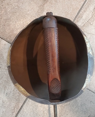

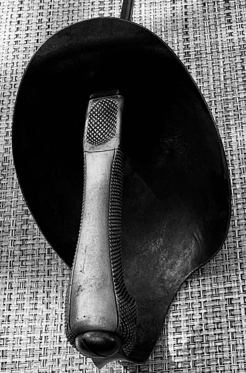

Note the aluminum bowl with the M1908 cavalry sword grip. The blade is a thin, fencing foil type blade,

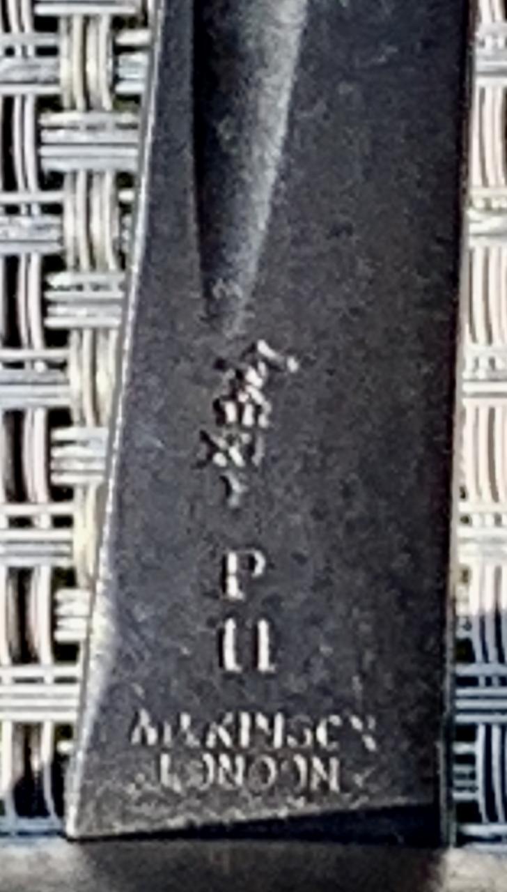

These are known (per Robson) as Practice Sword Gymnasia, Pattern 1911,
MK1,
I cannot recall the exact circumstances of acquiring this, probably about 45 years ago, but it was so weird, I could not resist.

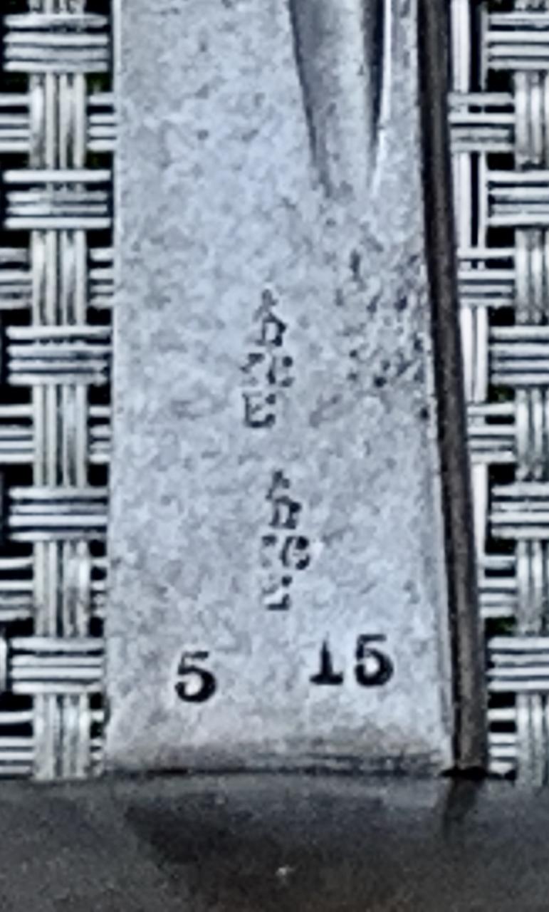

Jim I have not seen one like yours, with the wooden grip it could suggest use in India. I have P11 made in May of 1915 which is odd because the 1908p sword is not a duelling sword but basically a spear and gives the same reach as the 1868p lance. The blade on it is curved and fullered and flimsy.
Old 2nd August 2021, 09:36 PM   #3
Posts: 10,281
Hi Will,
Thanks very much! I had not been aware of these being made as with your example, and very good point that the wood grip may well indicate India provenance. There was of course an Indian M1908 with wood grips as you note.
It is indeed curious that these practice swords have a fencing type blade as it does not seem these were ever intended for any sort of sword to sword combat, and were simply a thrusting weapon.
As far as I have known the M1908 was indeed used in combat, mostly in Mesopotamia in WWI (as described in "Charge to Glory" James Lunt) where they were colloquially termed 'Allenby swords' (Gen. Allenby in command).
The American 'cousin' , the M1913 Patton sword with the same concept and overall gestalt was however never used in combat.
I really appreciate seeing your example, thank you again!

Jim over the years I've seen less than five of the sword I have and none of the one you have. Possibly Gordon Byrne may know something about your sword?

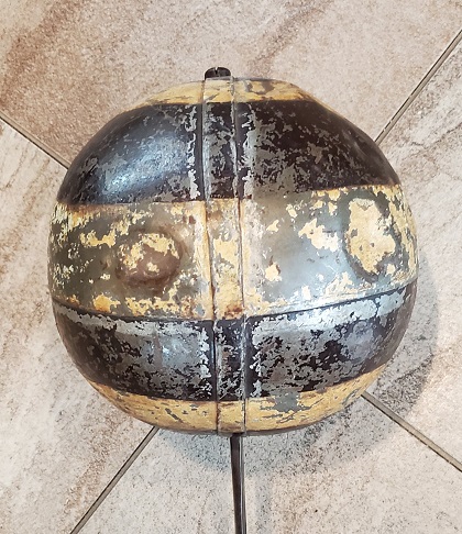

The black and white striped bowl must have some reason for this particular design. It does give us something to look for in period photos.

Hello Jim, Foil swordplay goes back to the mid 17thC. tHE KEY WEBPAGE IN THIS REGARD IS https://www.leonpaul.com/blog/the-de...f-foil-part-1/
I recall seeing this black and white decoration on Foil target equipment but I cannot remember where.. I shall keep looking!

The white painted band if painted around the handle of a British bayonet indicates 'Drill Purpose' so its possible that is the reason in the case of this sword .
Thank you so much for this information! That definitely would secure probable military use. Much appreciated
