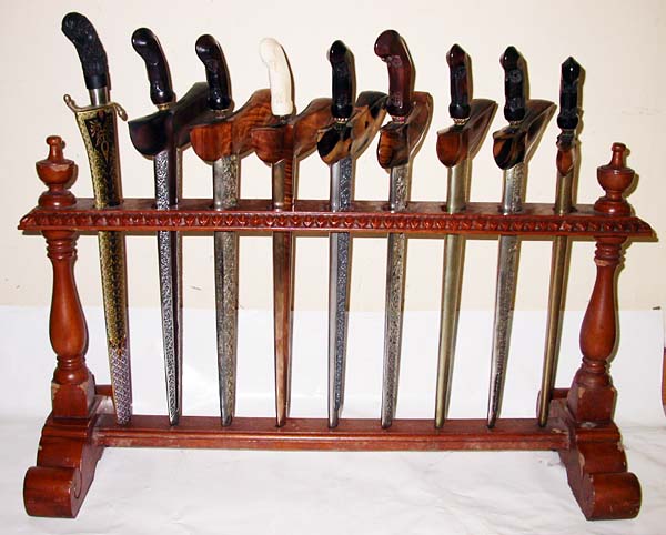

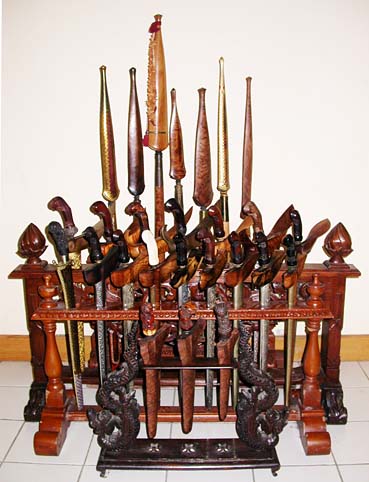

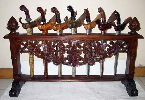

It depends on the space available, and also the consideration whether it is a fixed preservation or moveable. This is examples of preserving in a moveable manner. In a wooden "ploncon" (keris or short spear stands). Not wasting too much space, and still moveable. You may use also, as David said, with "blawong" (wooden carving for putting a single keris in the wall)...
Ganjawulung

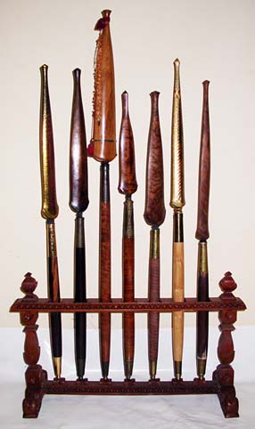

I do have a number of tombak in the house, 7 on display shafts in a ploncon, 4 or 5 on full length shafts placed in various corners. These tombak are not consciously displayed, but kept as they are simply because it is convenient for me.

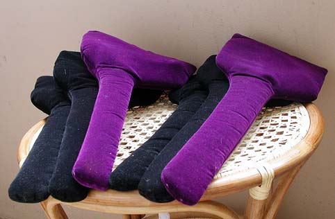

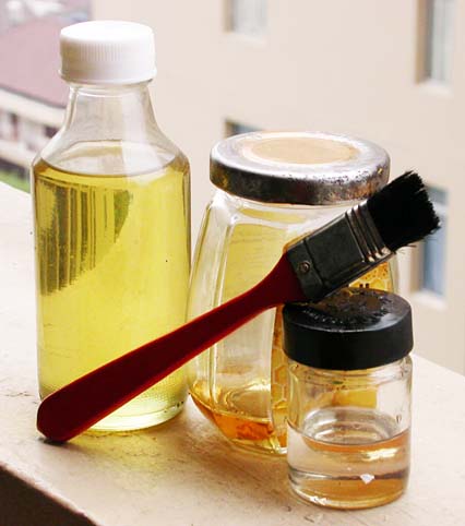

Of course, this an unfinished info yet. And this is not of course, a "court way" but "personal way" to store kerises. Ploncon (pls spell it: plonchon) is very useful to place kerises after the are oiled with "keris oil" (Alan has said about that kind of oil). Keris oil, is very personal. In Jawa, every keris people has their own scent of keris oil. Sometimes, from smelling the oil of keris, people can guess who is the owner of the keris. Or, people recognise well, somebody's keris oil by scenting it.
Why ploncon? Because it is safe to "stand" or to place the wet-oiled kerises before they are put in "singeps" (like 'thermo-bag' for tennis-racket), or in "cinde" (Jogja's specific model of singep, made of "kain cinde" or a kind of scarf-cloth). The keris oil will flow to the tip of the blade. And after quite dry, then you may put them on singeps (see picture).
Ploncon, of course, it is not a permanent display. It is useful for drying the keris oil, or for displaying for your personal occassion: in your living room, or private room. Yes, the special keris board is better, to store your kerises in singeps horizontally. It depends on you, where you will store your personal kerises.
Ganjawulung
