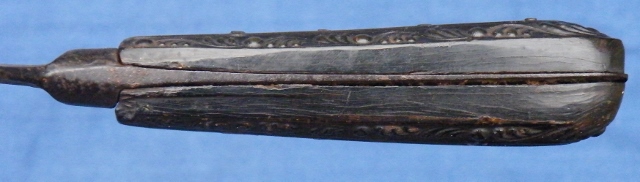

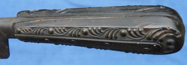

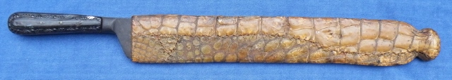

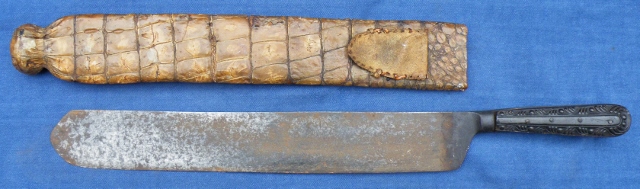

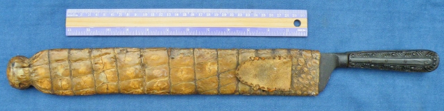

I am posting this recently acquired weapon in this section, as the blade is of European origin. I believe however the knife/short sword was used by tribal peoples in the Cameroon Grasslands area of Western Africa.
After posting in the Ethnographic section of the forum, suggestions are regarding the blade ... that it is/was a very large cake knife, with the hilt scales possibly made from "gutta-percha". The knife on its own is 50cm long and the point has been rounded off I think. I can see no markings to the blade. The maximum blade spine width close to the hilt is approx. 4mm and the blade is only slightly flexible.
Can anyone provide more information on the knife blade and its origin ?

Thanks Mark, glad you like it. As you say, strange there is no maker's mark to the blade, unless after removing the rust something will be revealed.. Given the size of the reptile scales, I am reasonably sure the skin is from the belly of a crocodile.
Presumably, the knife was a trade item that found its way into the interior of the African continent. Coastal West Africa of course had continued contact with Europeans and their manufactured goods early in African history.

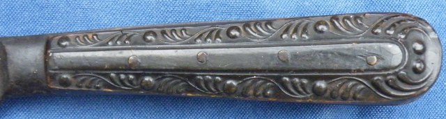

Finally got round to cleaning the blade on this piece and it has uncovered the remains of a mark to the blade... looks like a horse ? running wolf ? Does it ring a bell with anyone ?

Thanks to Jim for his helpful and informative posts, above. So, its quite likely the mark represents a "Bushy Tail Fox" or "Running Horse", and probably of English manufacture...
Regarding dating, as the hilt scales are made of gutta-percha, this precludes a date of manufacture prior to the mid 19th century. I should also mention that looking closely at the blade, there seems a fair chance that the profile has been rounded off to form a spatulate end, rather than coming to a point, at some later period ?
I have had a good look over the internet to find a similar knife, but without success, although the impressed design to the gutta-percha is quite typical for the Victorian period. Can anyone find an image of a comparable piece ?

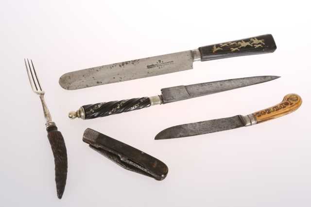

I found some examples of serving knives in "The Wallis Collection" (Mann, 1962) but will note that these are profoundly OLD! These are apparently 15th-16th century vintage, but it would seem the traditional form would have extended much further, given the simplicity of the form and the convention of continuing such styles fashionably for centuries.

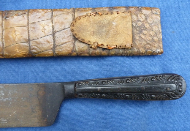

Further, it would seem the most pertinent news that this scabbard is not crocodile, as appears in photos, but 'gutta percha' which is a latex type material produced from sap in Malaysian trees from 1850s+
As this is a faux crocodile hide scabbard, and clearly of Victorian context, why would we presume this item of flatware to be African?
Much of flatware produced in these times used exotic or colonial style motifs, horn, hides, staghorn etc. so is it possible this very atavistically styled serving knife might have been made recalling these early forms? and if Shotley or other northern cutler might have produced it?

As noted in previous posts, it is the hilt scales (not the scabbard), that are probably made from gutta-percha. The scabbard is made from crocodile skin.

Trying to find an exact match is difficult. Look at antique icing knives and spreaders. Also antique cake decorating knives. Google farrar and tanner wedding knives to see modern examples.

See examples in post #9, which illustrate antique forms. These are obviously 'ancient' in comparison to Victorian antiques, however the Victorians favored notably antiquarian styles (i.e. Gothic etc.).
It would seem variations would prevail as with any form, however the 'spatulate' shape remains somewhat consistent as its purpose is to lift and serve a portion of food.
Old 7th June 2021, 07:05 PM   #14
Posts: 6,012
A picture from a long ago auction site. The hunting scene handle is nice.

well it definitely is an african sheath made of crocodile skin. but the knife i suspect is in its original form. it may not be a serving knife as im pretty sure that style was well out of favour for other narrower styles. based on those grips its 19th century.. but could it be a vetinarians knife instead, one for disction of larger animals.
