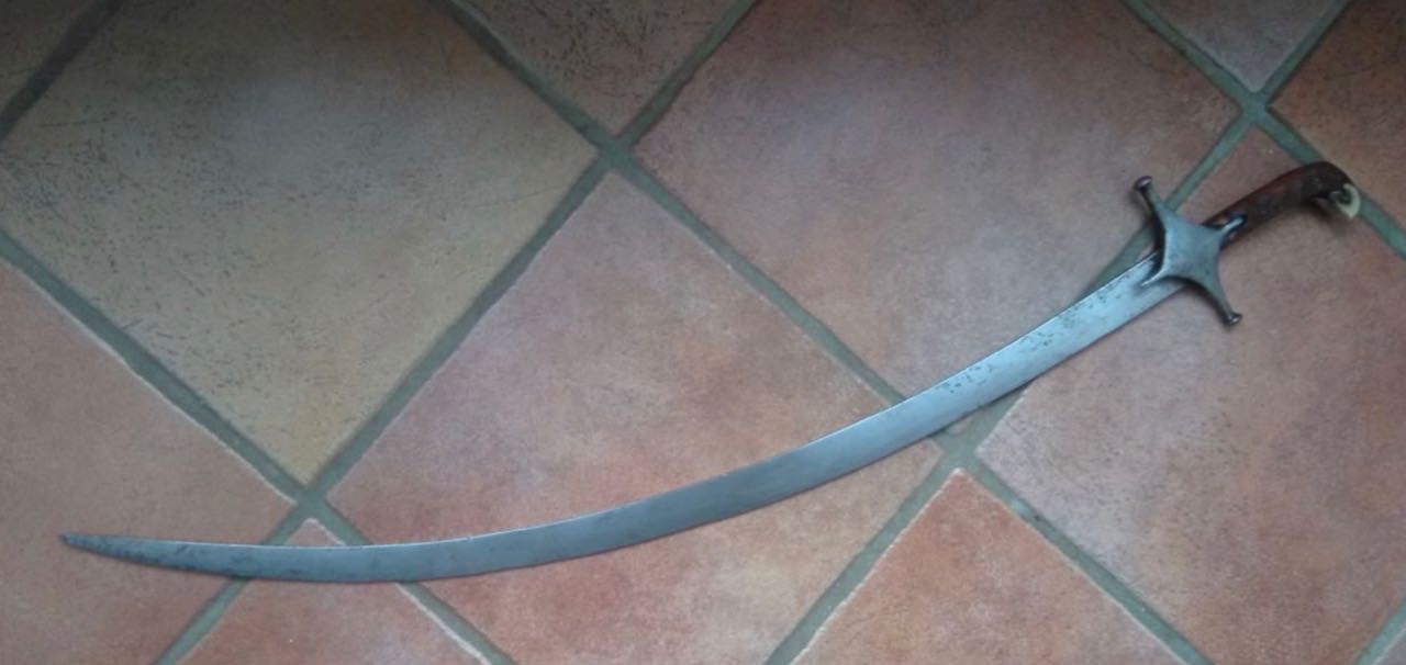

Nothing better than an example:

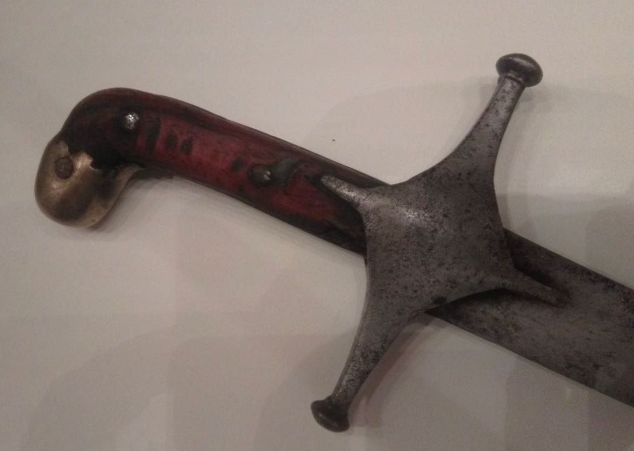

Not talking about money but this all rusty shamshir I have per example,
bought less than 80 Euros couldn't stay like that...
now I can sell it for a fair price but I prefer to collect...

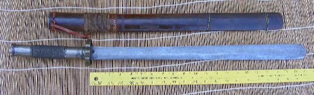

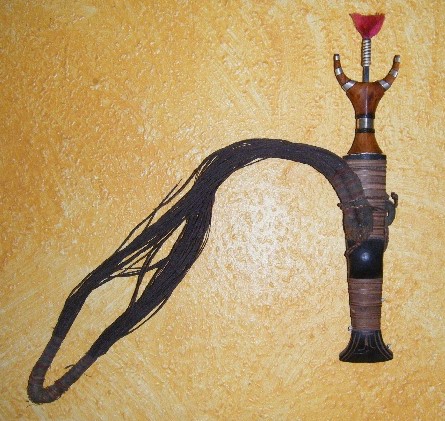

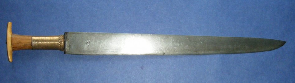

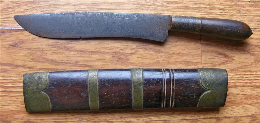

I personally see it like with old cars, either bring it back to former glory or bring it working and in a usable condition. Who wants to collect wrecks?

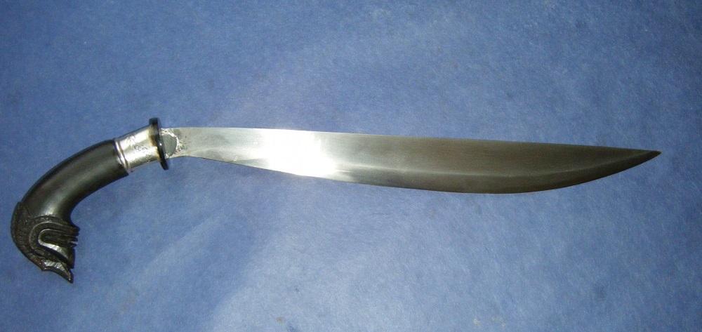

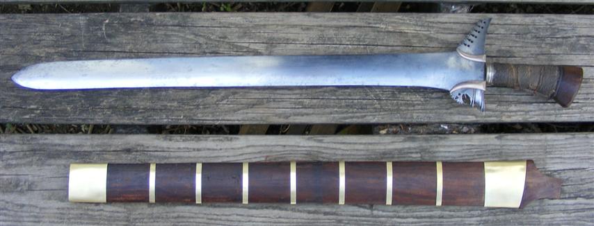

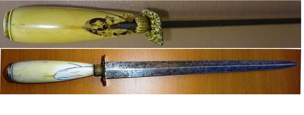

Some samples of my collection before and after, choice by self!
Old 24th January 2021, 02:13 PM   #8
Posts: 9,762

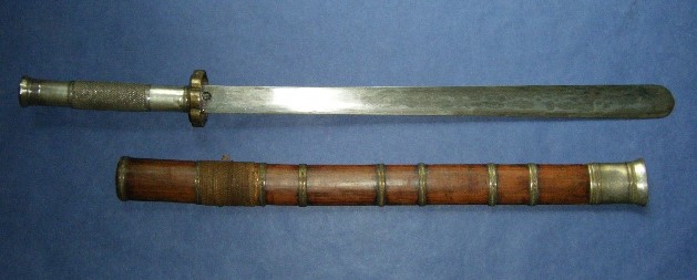

A few more. I would be able to show several more examples.

Ethnographic weapons are not coins or stamps. I would go more with oldtimer cars, either restore them to former glory or bring them to working condition and functional and repair what needed to get repaired, for example a broken hilt or scabbard. I've shown several examples, choice by self!

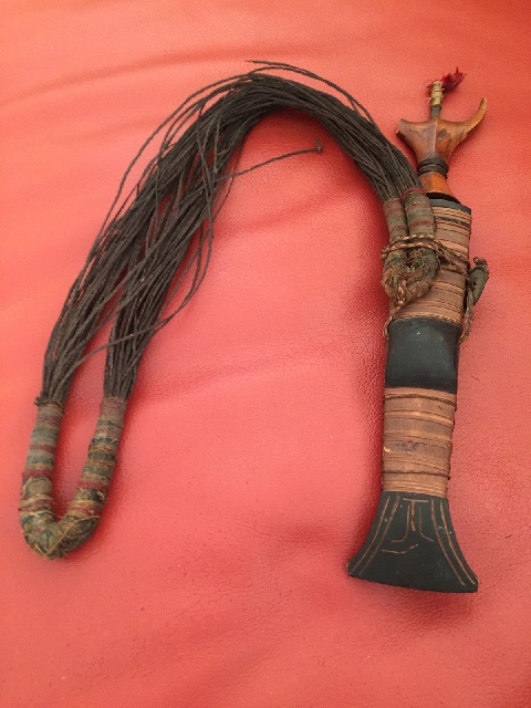

Don't worry Sajen; the thread has not yet ended. And while some non weapons restoring considerations took place, be sure your examples are being appreciated .

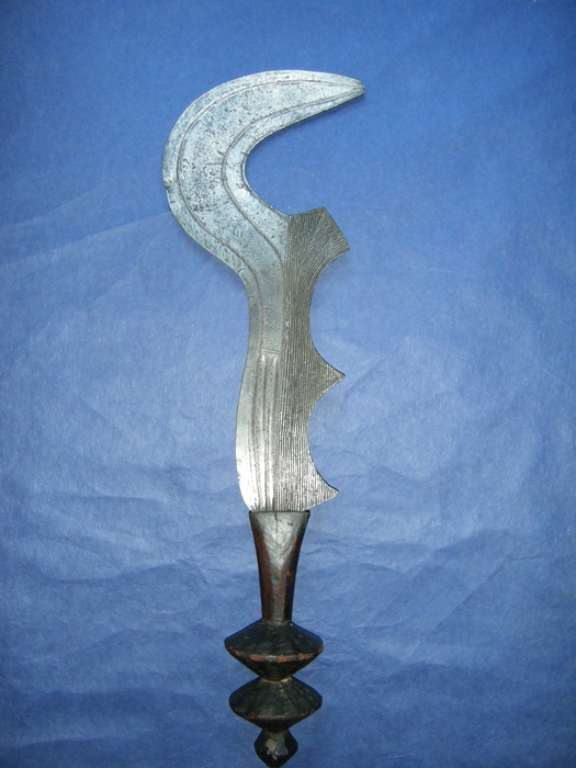

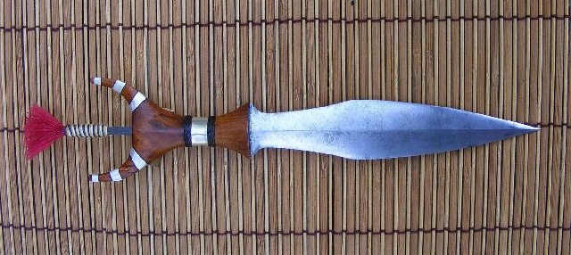

Default Just curious ...

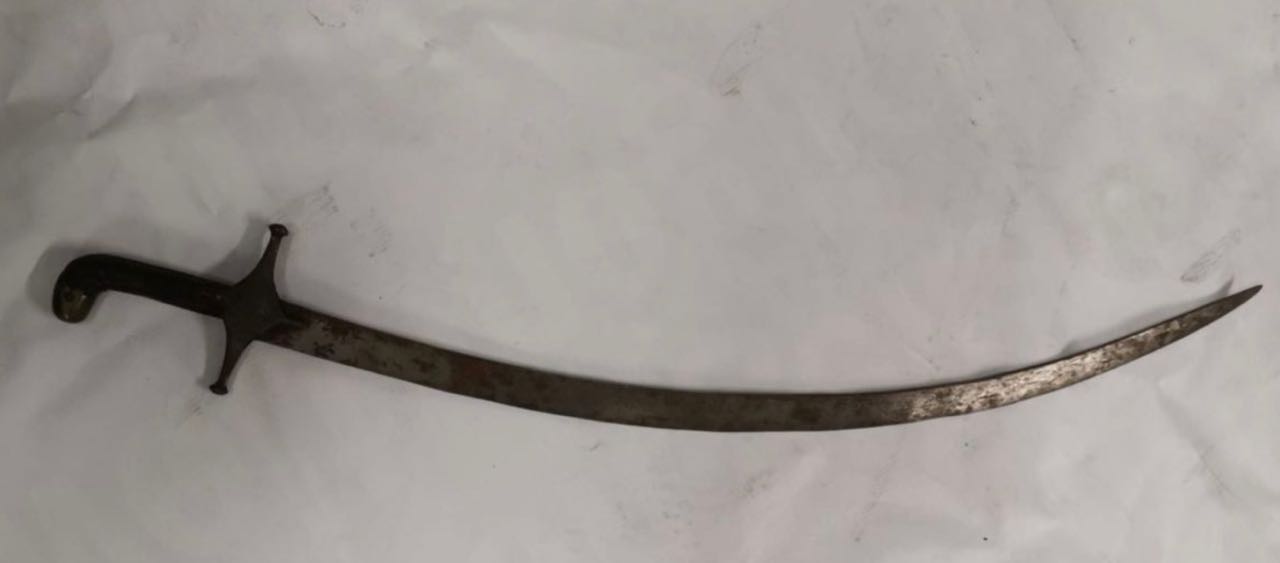

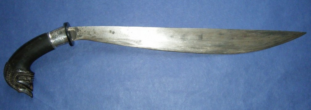

Would you Gentlemem say that this kind of restoration should have not taken place ?

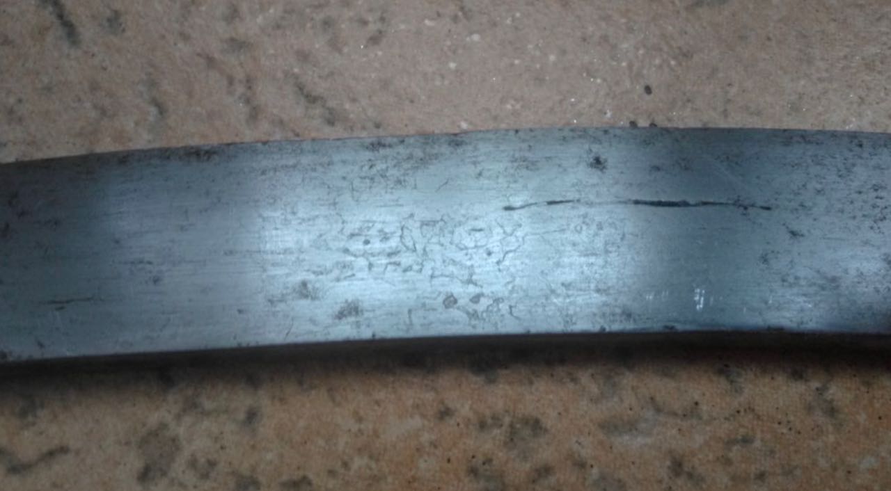

A real problem with amateur restoration, even cleaning the red rust with 250 or 400 or 600 grit can smoothen an edge (I mean, an edge of a fuller, the two edges of the back etc...) when it is normally sharp. I have seen a lot of «*cleaned*» things, finally harmed more than cleaned. I would say that the best to clean active rust is to use dear antler and oil. And let the black rust and pitting to professional

Posts: 9,762
Originally Posted by fernando
Would you Gentlemem say that this kind of restoration should have not taken place ?.
Definitely yes, restoration exactly like this. Restored to the original look!

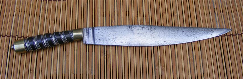

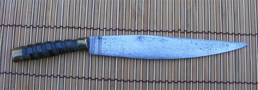

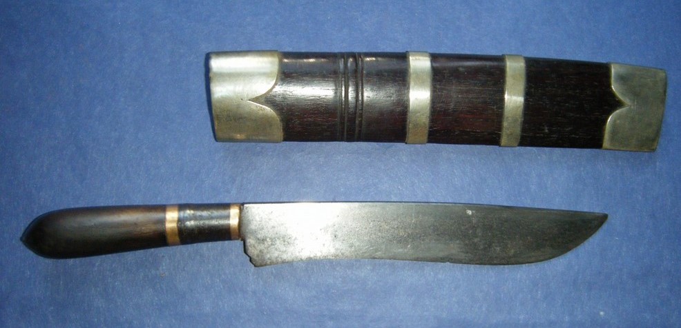

Yes, this I see similar! I've learned by my first job education to file a set square from a piece of iron so I know what I am doing and what I am not able to do I give to people who are able to do it, see here: http://www.vikingsword.com/vb/showth...t=visayan+kris I was sure that this blade was ruined by a real amateur restorer but a good friend was able to give the blade back it's original shape.

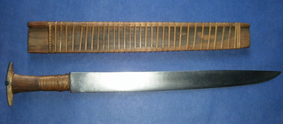

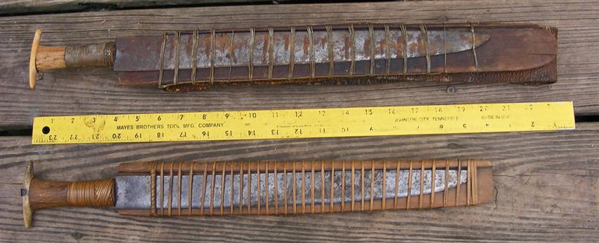

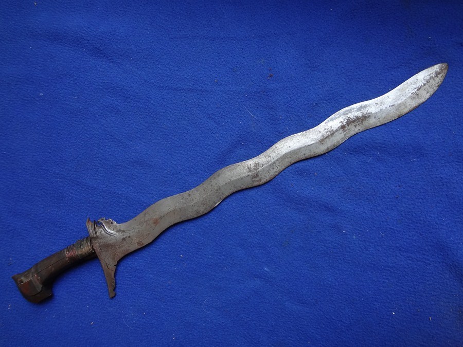

Another example is this Visayan knife which seems ruined by an amateur but Roland (our member Roland_M) gives it back the typical beveled edge.
very beautiful done. Question: as the blade looks like new now, what about the grip? Do you do something with or to the grip or leave it as is ?

Hi Gunar,
I don't know about wich blade you speaking, the Visayan kris or the talibon similar blade in the pictures. And yes, both blades received a polish.
All bone, horn, ivory and wooden parts get linseed oil when I receive them. I have nearly closed a big crack in an ivory handle by long bath in linseed oil.
the Visayan knife is a beauty !Cantik.

Wow, Sajen, great swords, and really nice restoration work!
