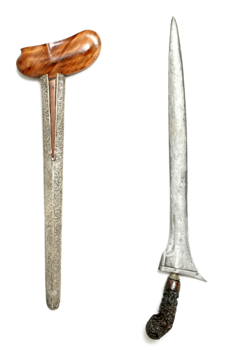

This is an example of a suitable scabbard and hilt for your blade, but they are difficult to find.
