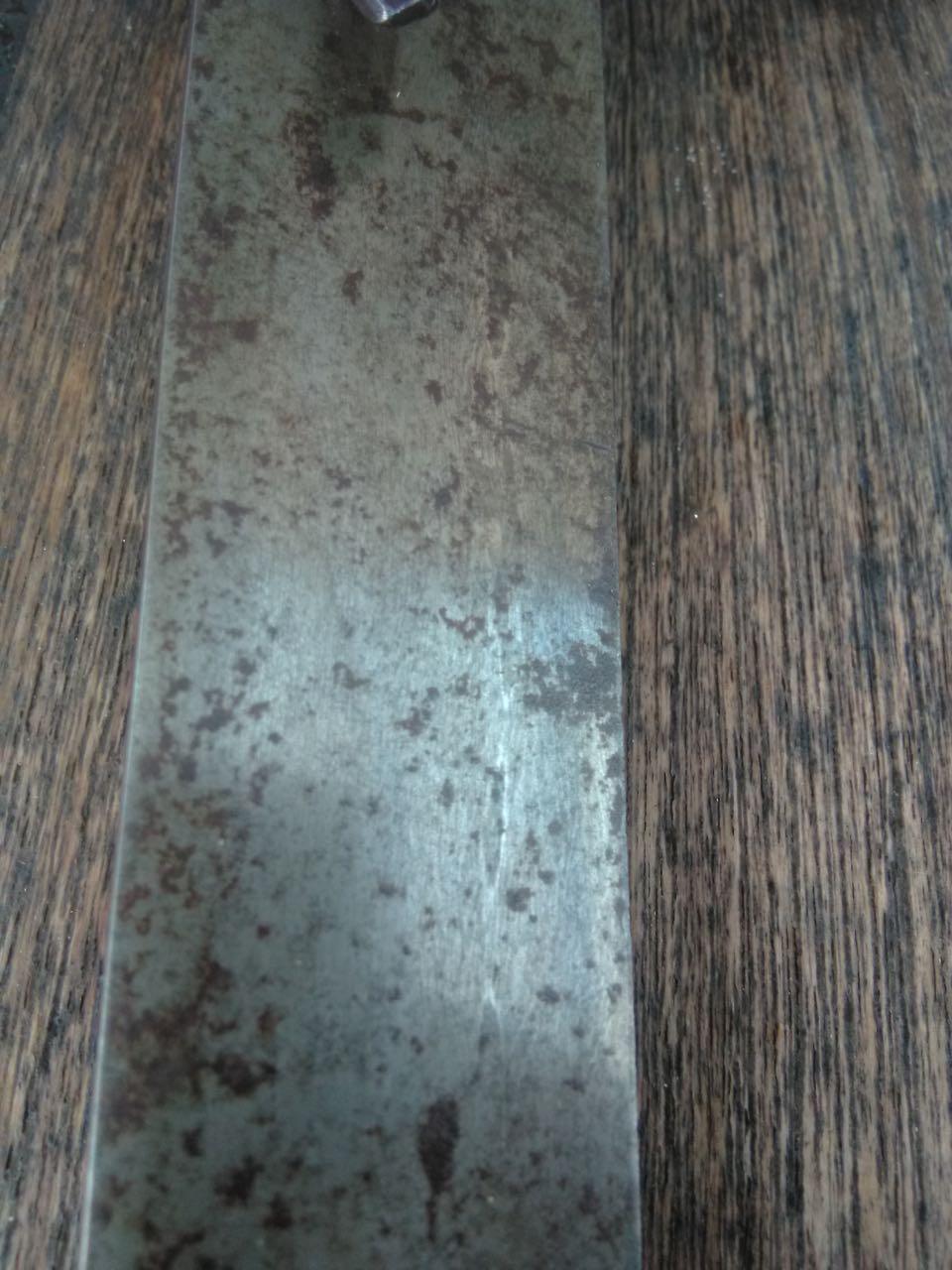

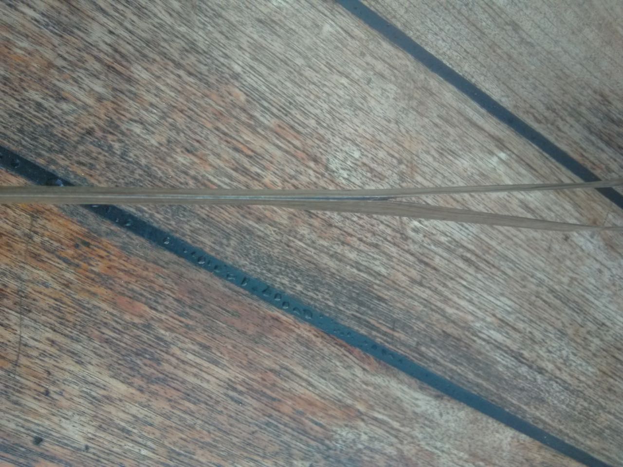

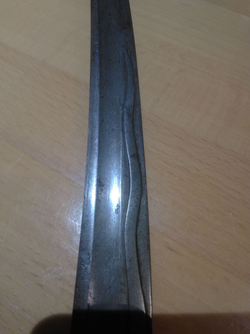

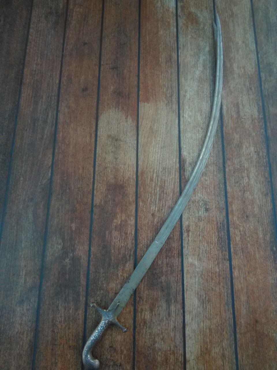

Hello everybody,
For share/ discuss,
I got this zulfikar sword,
the blade is split in two parts, the work is really well done.
I found on internet some Zulfikar blades cut in that way with a long engraved snake on the blade but I wonder how rare they were ?
The few I know is that they made these for the mythical symbol and sure it loses battle efficience with this shape.
So I wonder why they did it with such a good steel, ( wootz I think ) as found on other like-that sword if it was just for deco ?

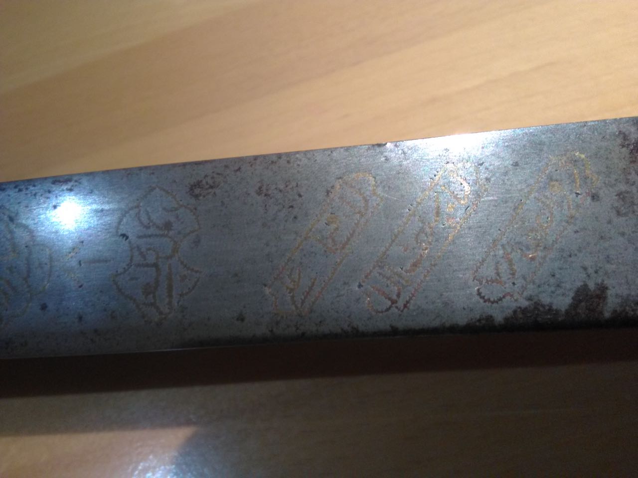

There is a cartouche, I think a copy of Zulfikar and Asadullah marks...
Persia ? late 19th century ?
Nice surprise for the cartouche, first the blade was all rusted...

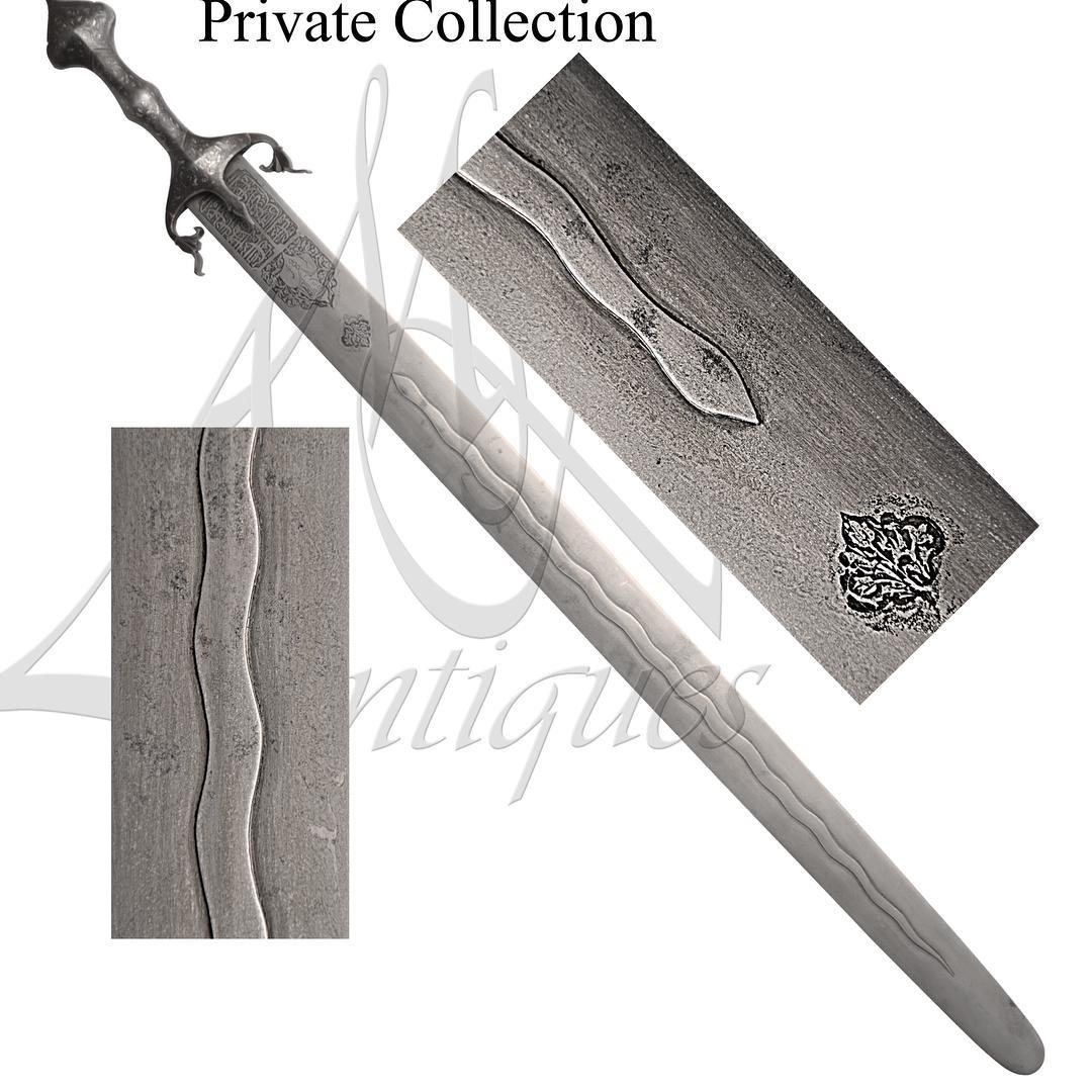

Very high quality blades, more likely early 19th
Look at
http://www.vikingsword.com/vb/showth...=snake+persian

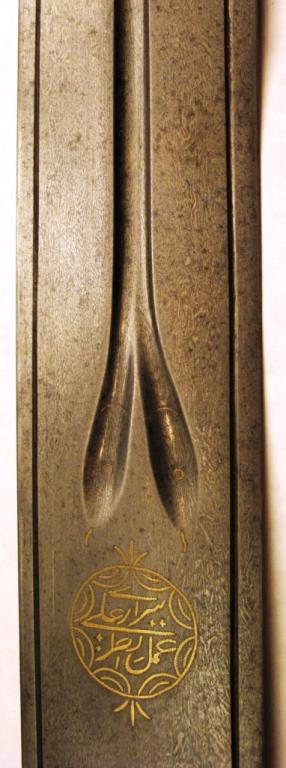

The maker's cartouche reads kalb'ali. These engraved snakes can be found on quite a few 'extravagant' qajar era persian sword blades, mostly wootz tooas far as I have seen

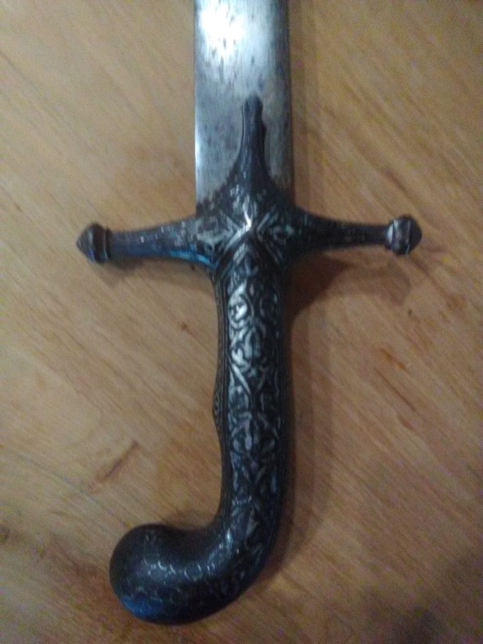

francantolin
Posts: 948
Really thank you all for your precious comments !
Thank you Jim for all history and the use of wootz explanation !
Thank you Kubur for the links for old threads, they are really interestings !

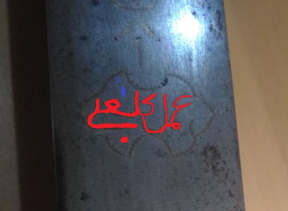

Gepi, you read kalb'Ali for the maker's cartouche ? is it the one with a floral-drop shape ?

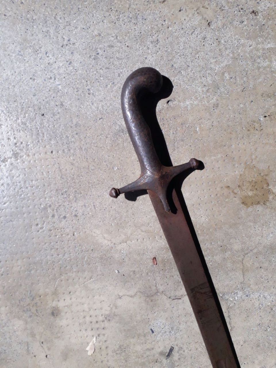

Here other pictures of the sword, on the hilt remains of silver koftgari,
the all sword picture is better like that ( holy daylight !)
it's a big sword, almost 1m05 / 41,3 inches long
A '' close up'' picture of the final two blades,
Interesting how the cut the blade in two parts...
Kind regards
It's this one (عمل کلبعلی).

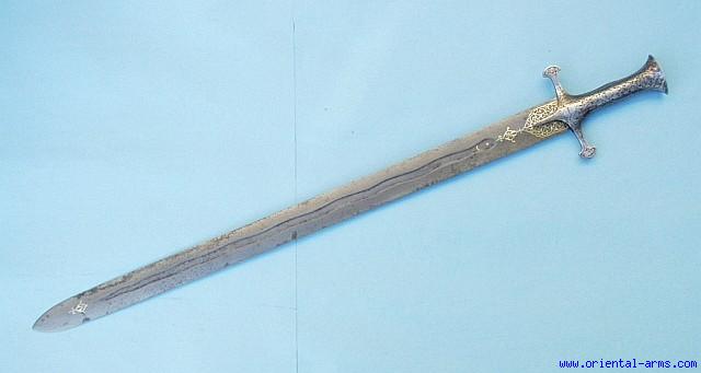

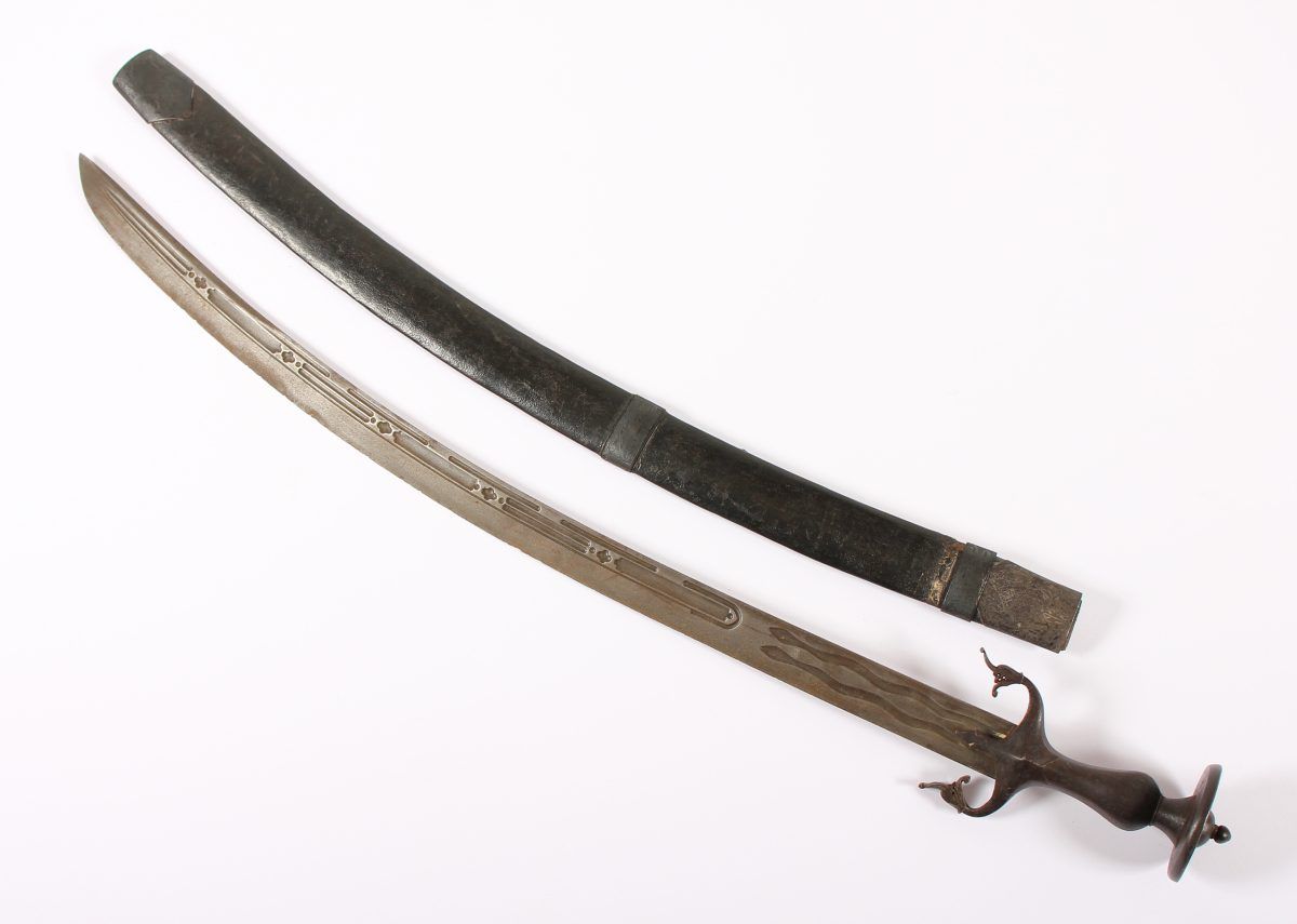

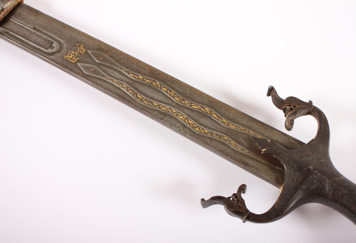

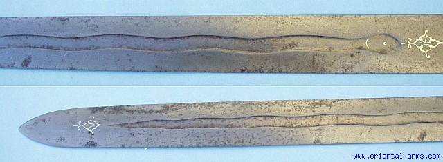

Also some more swords with snake motives which I think are all Qajar Persia, even the one with the disk pommel I believe:

I also think the cartouche above says "bandeh-e velayat shah Abbas", as you would expect, but the calligraphy is not great and the picture is a bit blurry.
