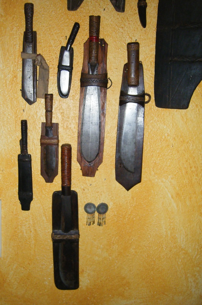

Hello friends,
I bought this bolo around 5 years ago. While travelling from Baguio(Benguet) to Sagada(Mountain Province) I stopped on a reastaurant to have some lunch halfway between the two areas (Baguio and Sagada). While taking a breather after a hearty lunch- I chanced to see a local very old guy with this bolo on his waist (along with an antique pendant called ling-ling-o). To go right to the point, I bought the 2 items.
1) some blade traders/artisans from Ifugao say that this is a pinahig. But this does not have the traditional 'puhog' or the navel (see picture for reference) as traditional Ifugao blades must have. The handle/hilt is from a style known as 'inipit' and not the hollow 'nahalung' type.
And yet, some traders/artisans from Ifugao claim it is not a cordilleran bolo. So I say: but this was collected on site from a site located between Baguio and Sagada. If this is not Ifugao, must this be a blade from the Kankanaey tribe of Benguet or Sagada? or perhaps a bolo from the Kalinga?
Appreciate your inputs and keep keep everyone.
Yves

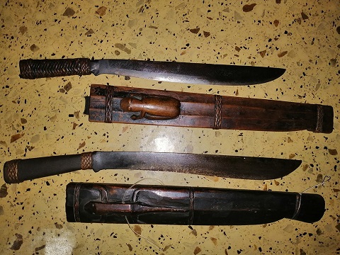

I've had the privilege of talking to an Ifugao bladesmith. He forges traditional Ifugao blades. This is what he shared to me.
My bolo is a peh-let (pehlet). The difference between a pinahig and a pehlet is that the pinahig has a sharp edge, thus for thrusting. The pehlet, on the other hand is primarily used for agricultural and or slaughtering of animals.
Here are 2 of my old pinahigs and a new reference pehlet for our referece.
Thanks and kindest regards from Manila,
Yves
Hello Yves,
Thank you very much for sharing this insight. This would mean that the two bolos on my picture (upper right & the one in down) are as well pehlet.
I see the difference also by the blades which are by a pinahig moore slender and the scabbards are closed instead of open worked when I follow the shown pictures, correct?

Originally Posted by Sajen
Hello Yves,
This is what I got from the bladesmith/ and other Ifugao sources-traders who has contacts with bladesmiths:
Pinahig - is a single-bladed bolo. it could be 'slender or a little stouter). But the prime characteristic of a pinahig is that the point of the blade (in comparison to a pehlet) is narrower. Most of the pinahigs that I have seen has the closed-type scabbards, but there maybe pinahigs having the the hikot type scabbards (open-faced).
With regards to your pictures, they may seem (to me) as pehlets. BUT, will share this picture with the bladesmith for comfirmation.
Thank you very much!

Old 19th April 2020, 10:20 AM   #14
confirmed by my Cordilleran contact. They are pinahigs with a hikot (open-faced wooden sheath/scabbard).
Hello Yves,
When you mean my both bolos I have to thank you also when I am now moore confused as before, frankly said I don't see the different from my both to maybe your example which start this thread!
