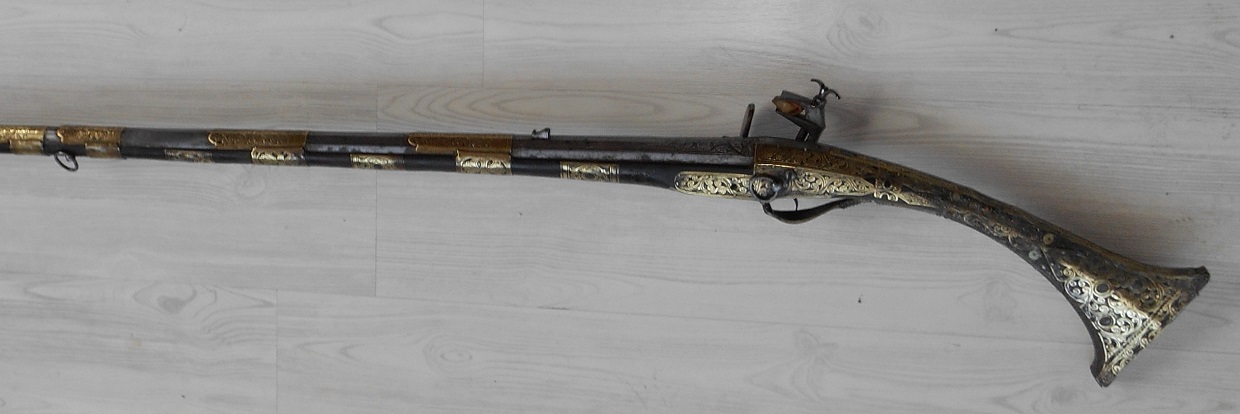

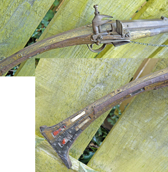

Lucky enough to find an attic fresh, untouched North African? Jezail this morning.
It's quite an elegant example with a slender stock but the thing that intrigues me most is that the entire construction is steel, apart from three inches or so, of wood set in at the base of the stock where it has some applied decoration. The frizzen looks as though it has at some time been re-lined, suggesting a fair bit of use in its lifetime. I think I can see some stamped markings on top of the breech but have not yet undertaken any cleaning other than a good dusting with compressed air.
I'll get round to some sympathetic restoration when my workshop gets a little warmer.
I've taken a few photo's and would welcome any comments.
Mel.

Your gun is actually Balkan, mostly associated with Albania, though it was used throughout the Peninsula. Nice gun, congratulations.

It's a Tanchika from Albania and / or Bosnia.
Look on the forum you will find plenty.
A Jezail is from Afghanistan
and a Moukhala for North Africa.

Thank you for a good start Teodor, that's given me a good starting point and I've done some looking, the name Tancica has appeared, does that apply here?
EDIT
I see that my question has been answered before I asked it.
Thank you Kubur.

Old 6th March 2020, 11:42 PM   #5
qusko
Join Date: Nov 2018
Posts: 62
Originally Posted by Kubur
STU
Have you seen the rings, one on each side, it seems to be standard...

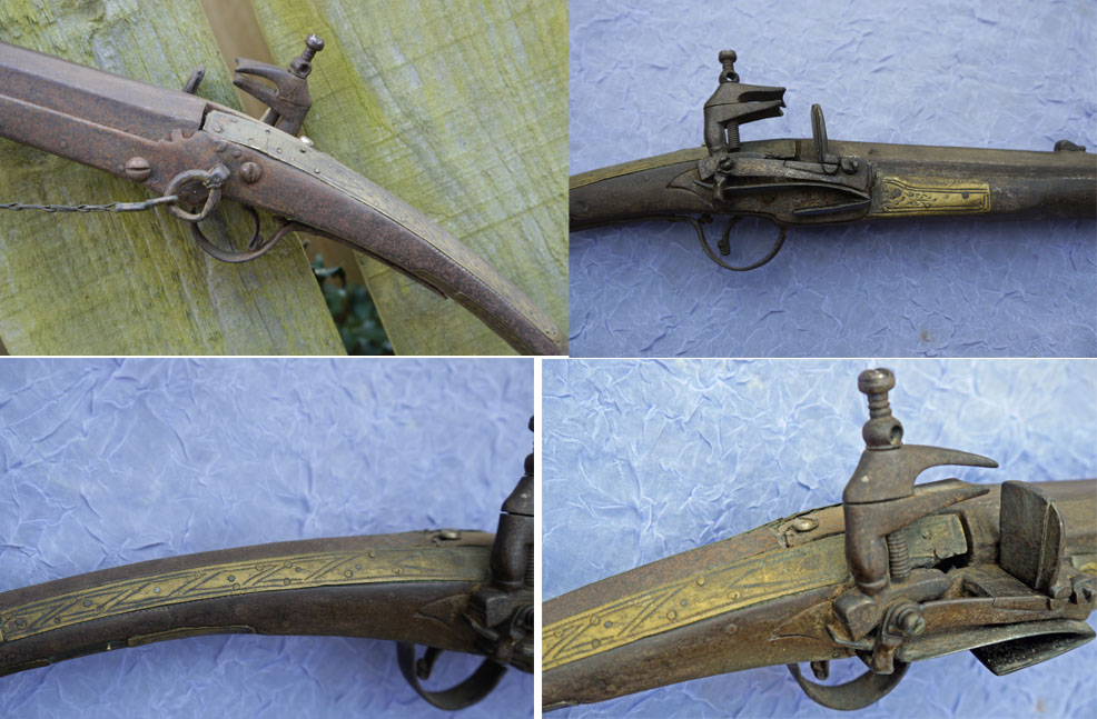

Hi Kubur, Stu,
Ring (in the middle of barrel) in this example of tanchika seems to be original, but maybe more preference of an owner. Usually both rings were on the same side. Attaching some example.

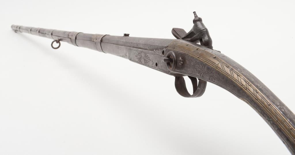

Old 7th March 2020, 07:10 PM   #7
Hi
Here is mine and rings are the same side...
Old 8th March 2020, 12:28 AM   #8
Posts: 2,789
I would point out that the issue of ring placement originated on the thread of the Boyliya gun http://www.vikingsword.com/vb/showthread.php?t=25695, not this one re the Tanchika.
As you will see if you refer to the thread above, the issue of the placement has been clarified due to my incorrect observance of the pic which was quite dark. Both rings are in fact on the same side.
The comment placed here however is quite correct in that the ring fitment on Tanchika seems to be able to be fitted either side, but most have them on the same side.

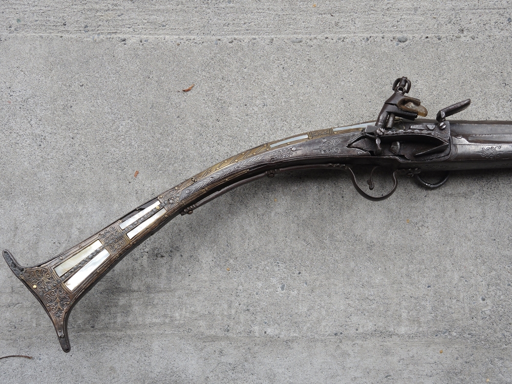

Pic attached showing Tanchika "in action".
Stu

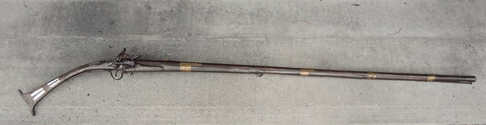

Old 8th March 2020, 01:22 AM   #9
Posts: 2,789
....and also a pic of my Tanchika.
Stu

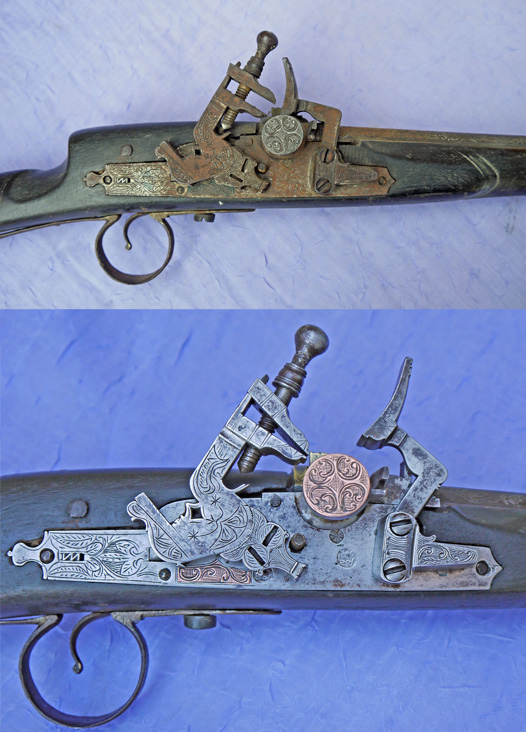

Hi Rick, It may be a while before I get this project started, there's a bit of a queue at the moment. Just to keep you interested, I've included a before and after of a rather nice Moroccan snaphaunce that I found a while since.
Mel.

Ohhh.....nice clean up on that Moroccan lock. You just never know what you will find underneath rust. LOL

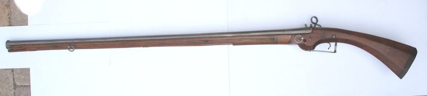

Old 29th March 2020, 07:16 AM   #17
Philip
Philip's Avatar
Location: California
Posts: 1,036
Default European antecedent: ring swivels
Here is an early miquelet-lock gun, ca 1630, fitted-up in Brescia (in Lombardy, northern Italy) in local style of the era, using an imported Ottoman barrel. The bulge on the bottom of the stock ahead of the angular trigger guard is a holdover from wheellock guns, here superfluous considering the shape of a miquelet lock.
Seen here on the left side are a pair of ring swivels for the sling. The buttstock profile is similar to that seen on a type of Balkan gun, common during the 18th-19th centuries, called a dzeferdar.
Note also that the barrel is affixed to the forestock by pins running through tenons dovetailed on the underside of the barrel, in a manner common to most European long guns of the era. This, as opposed to the use of capucines or barrel-bands characteristic of later Oriental weapons.
