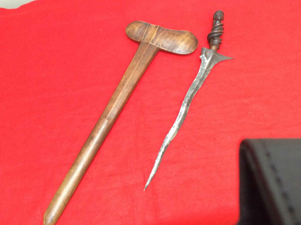

Default Unusual figural hilt

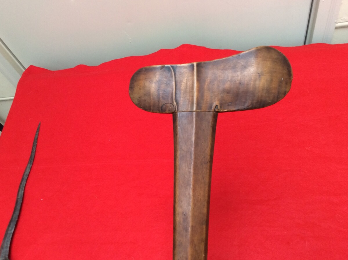

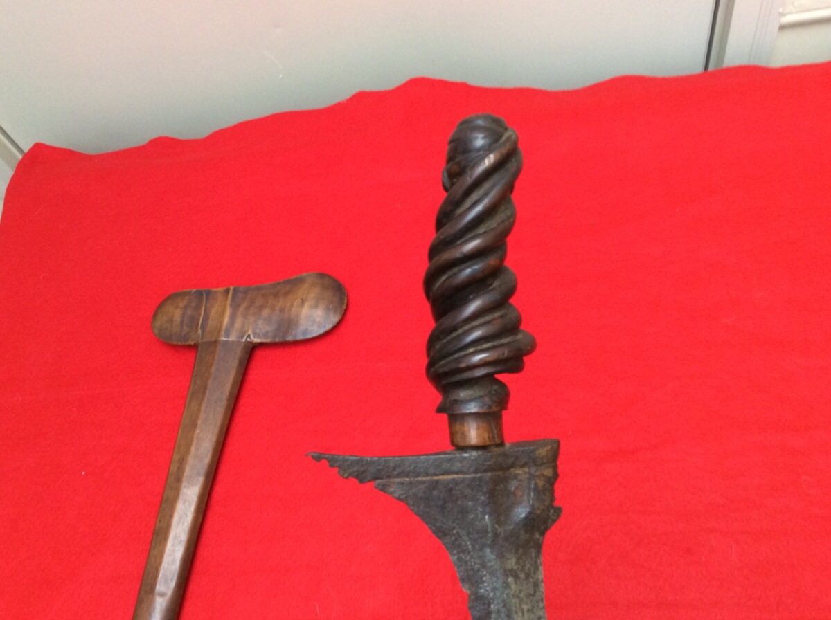

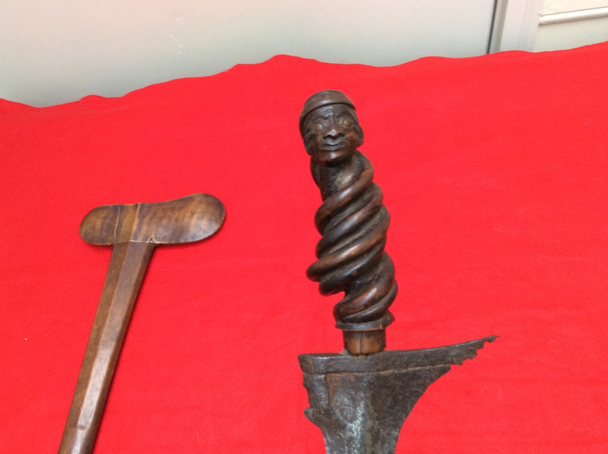

I shared this example on the figural hilt thread. Unusual handle with spiral body and head. Blade has seen its better days. Scabbard seems to be in the Balinese style but the blade is too short for the scabbard so I presume this to be a mismatch. Would be interested in any thoughts or comments about this piece.

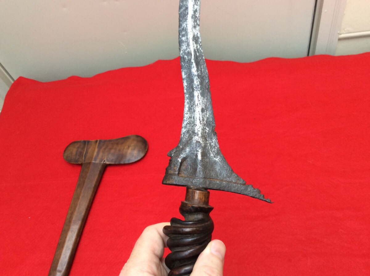

When I posted this one on the figural thread I had tagged it Balinese but you didn't think so. Don't know if the additional pictures sway you in any direction but what do you think?
Old 8th August 2014, 01:31 AM   #3
Posts: 7,255
Personally I doubt that it is a keris hilt.
A ferrule like this is very, very non-typical for a keris hilt. But it could be a keris hilt, a person who was outside the mainstream may have carved and fitted it.
It looks more like nondescript knife/dagger/tool handle than a keris hilt.
If I could handle it I could form a better opinion, from a photo these things are always difficult.

Agree, I think it is a repurposed handle; something about the carving of the face says more Java than Bali to me .

I agree with Alan and Rick. Any opinion about the blade origin, javanese or older balinese?

Well, the sheath is certainly Bali. Not sure on the blade, especially given it's current condition. Of course, even it the blade AND sheath are Bali that would not preclude a hilt being placed on this keris from a different origin. Happens all the time. I am somewhat of the same mind as Alan though that this is possibly not originally meant to be a keris hilt at all. It also seems that it is missing a ferrule ring which may or may not have provided a clue to its origin.
Old 8th August 2014, 01:17 PM   #7
Posts: 7,255
Yes, the ferrule itself is missing, but it has been cut so deep that I cannot envisage anything that belongs to a keris being with it.
The blade looks like it might be Balinese, again I'd have to handle it to be relatively certain, especially in the condition that its in.

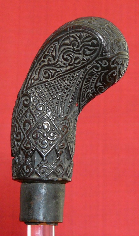

I attach the pic of one old (kris?) hilt specimen with a deeply carved base and fitted with a ferrule for whatever reason (damage?). The Solo nunggak semi hilts fitted with a selut also have a recessed base (but less deeply cut) for inserting the selut.
Best regards

Jean, that hilt that you have shown would originally have had one of those Cirebon style iron seluts.
The usual Central Jawa older selut has a scalloped rim. I have only ever seen cheap modern Jogja seluts with a straight rim.
Do we know of any hilt anything like this one from Cirebon?
Do we know of any Balinese hilt that uses a selut that would require deep cutting into the hilt?
If we do, then maybe we can give a "possible" to this hilt as a keris hilt, but the geometry of it looks much more like a generic sword/knife/dagger/tool hilt than a keris hilt. The only handle I've seen that looks something like this is a Lombok pelecok handle, but this hilt is not from a pelecok.

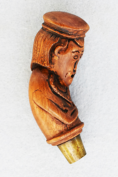

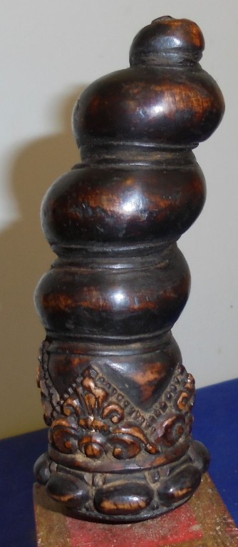

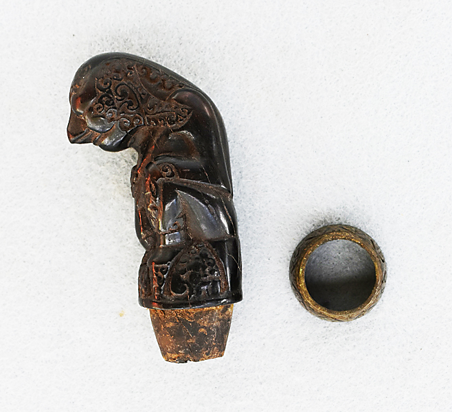

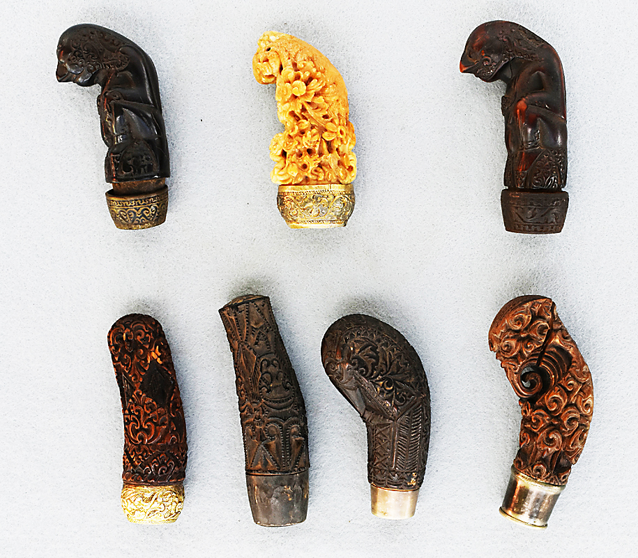

Here are some pics of North Coast hilts with seluts & ferrules --- sorry I've forgotten the correct Javanese name for a ferrule used on a knife or keris handle.
The image with 7 hilts has two hilts with ferrules in the middle of the bottom row.
In the image with two hilts both have heavy seluts, one of brass, one of iron.
The image with a single keris hilt & the selut detached from the hilt demonstrates the setback required for this type of selut.
The handle showing a Dutchman is from a pelecok and has a ferrule. This handle is intended as a visual joke:- the Dutchman is working for the user, not the user working for the Dutchman.
