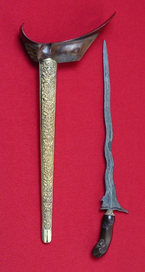

Hi Marco,
Like "Karna Tinandhing" (two sekar kacangs in one blade), this type of dhapur is also reflecting the brilliant idea of the creator -- combination of keris with luks and straight blade... Combined in one nice curving bottom lines of "ganja wilut" I have one, but not as good as yours. In Yogyakartan sheath too... GANJAWULUNG |

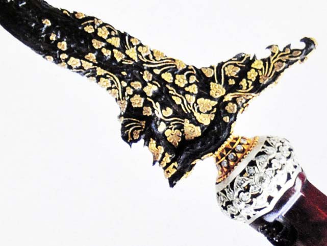

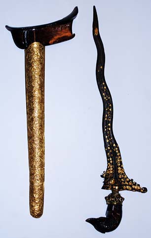

With pleasure, Alan, I try to describe it. This dhapur is one of my favorite for a long time. And one of the best Megantara (or Megantoro) I've ever seen in my hand is the one in the collection of Mr Haryono Guritno (as you may see in his book, "Keris Jawa" on page 319 and 358 -- picture below). A Megantara with tinatah emas (gold ornament) "wadana sawelas" (ornaments in eleven surfaces of the blade) in Yogyakartan dress of timoho gayaman ('ngingrim motif'), gold pendhok with diamonds... A truly elegant keris pusaka of Yogyakarta.
IMHO, from what I've seen from other Megantara kerises too, it is the type of "medium sized" keris. Mine is 33 cm length without pesi (almost 7 cm), compare to most Javanese kerises that usually measured 35 cm without pesi. All has "wilut" (double curve, or it is more precise -- "kelap lintah") ganja. And it usually has details of sekar kacang "pogok" (not full sekar kacang) but in a specific form of "kecambah" (sprout?) or even at a glance -- as cock's head.. Other details -- it has always seven luks, with one jalen, one lambe gajah, pejetan, tikel alis, greneng with curving end, and must have a kruwingan until 3/4 of the blade... It looks more feminine blade, than masculin... Why always seven? It might be traced from its name "mega" or sky. In "candra sengkala" sky also reflect "7" score too. Also in Indonesian expression, we know this paraphrase of "... sampai langit ke tujuh" or 'until the seventh sky'. I don't know who created this dhapur. But from what I've seen, at least from the pusaka of Yogyakarta in the hand of Haryono Guritno -- the tangguh supposed to be Majapahit... GANJAWULUNG |

So, would an accurate list of the ricikan that are found in keris dhapur megantoro be:- luk tujuh, gonjo wilut, ada-ada, kembang kacang pogok, lambe gajah satu, jalen satu, kruwingan, greneng ? Is there anything that I have ommitted? Yes, I agree with you that this seems like a tangguh Majapahit keris dhapur, well, East Jawa at least. |

Yes, Alan. And the last luk is longer, and even straight at the tip of the blade. So, always combination of keris with luks and straight at the tip of the blade... Perhaps Empu Supa's style, IMHO...

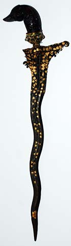

Will it be exagerated, if I supposed that this popular Si Ginje in the collection of the National Museum of Indonesia also was made by the same Empu? Empu Supa of Majapahit kingdom? Or which Supa? Look at the style and ornaments of this Sumatran keris...

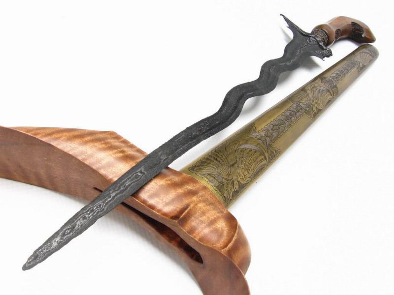

oke sorry mister maisey look to this one I think this one is also a megantara
#19 |
Join Date: Jun 2009
Posts: 1,347
Semar, I am afraid this one has zero kembang kacang...

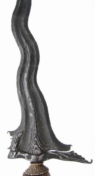

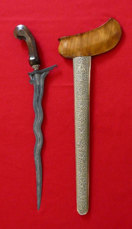

Two more keris megantara from my collection and to be shown in my new book. Sorry for the picture quality. Best regards Jean |
#23 | |
Join Date: Jun 2009
Posts: 1,740
This dapur does not match with any known Javanese type but could be specified as Jarang Guyang with some exceptions (the only dapur with 7 luks and without kembang kacang). Best regards Jean |

#25 | |
Join Date: Jun 2009
Posts: 1,740
In my kris book pages 73 (picture) and 179 (description). Again your blade does not fully match with dapur Jaran guyang, it has no greneng especially. Best regards Jean |

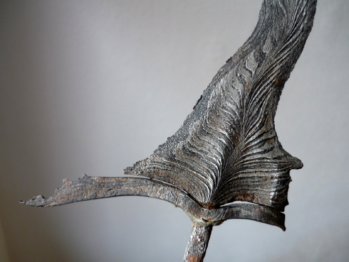

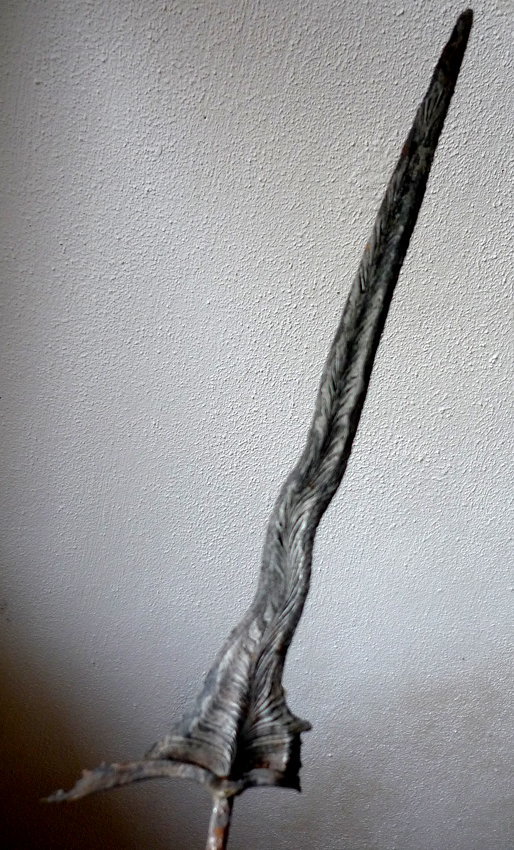

Wonder if my blade is a MEGANTORO...personally I would say it is.
Deep central groove and the (worn) kembang Kacang Pogok but it is not 7 luk blade ( which is part of the parameter?). Wonder how old this blade is and the feather pamor type of pamor? The MEGANTORO dapur is often seen in East-Java / Madura region? |
#27 |
Join Date: Jun 2009
Posts: 1,740
I noticed this odd and worn blade at the recent Czerny's auction (replaced ganja?). Yes, the dapur could be identified as Megantara luk 5 although this is not a standard dapur. Dapur Megantara is not included in the reference book Dhapur (Surakarta pakem) but it is mentioned in the book Keris Jawa. The pamor pattern could be identified as Blarak Ngirid or Bulu Ayam.
