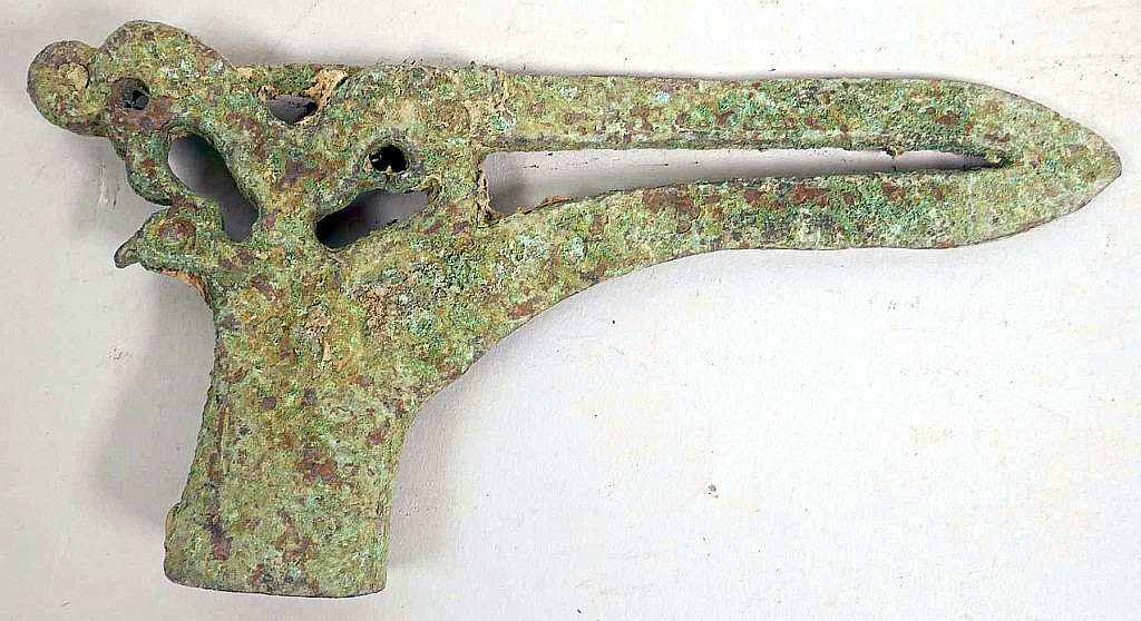

Just aquired this from an auction here in the UK, It's a chinese warring states bronze age pole arm weapon. Comes from an old collection estate sale, so with luck not a recent copy.
Hopefully will clean up the verdegris w/o destroying the patina & I'll find it in good enough condition to mount it on a pole as it would have been. Don't recall seeing many of these here, if any. they were the pimary chinese weapon for a few centuries. Later versions incorporated a spear point to the pole and eventually to the Ge portion as one unit.

It's always possible this is a new repro, it's illegal to ship a real one out of china. I'd never buy it from e-pray from china, either they start at more than I can pay, or so low they must be fake. I'm especially leery of the pretty carved jade ones i've seen there with sockets instead of tangs.
Mine is coming from a reputable UK dealer who was liquidating a collection of asian artefacts from a deceased collector. That too could be a fake statement, but less likely as their rep is on the line and I know where they live. Thankfully no reserve and no one else bid. Don't think the punters knew what the heck it was. Got it for less than £50, so even if it's a fake, I'm not out much. It's cost me less than a fake would .

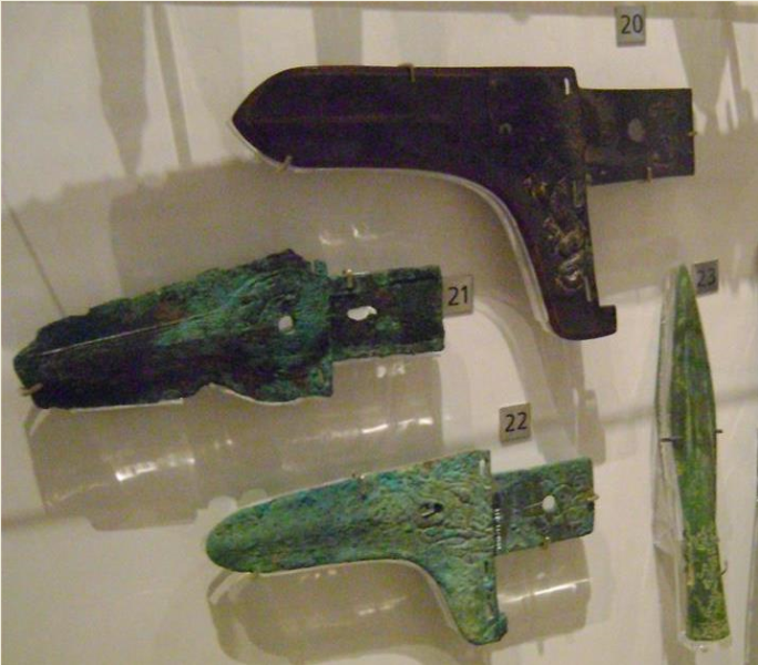

Speaking of their rarity, they have a vast collection of these at the Royal Ontario Museum ... hopefully authentic ones.
(My pictures ... lousy as can be),

I know the chances are slim w/o a full metal composition analysis and some objective method of dating, which I can't afford,but I can dream...They said the coelacanths were extinct millions of years ago, but you can still catch one occasionally! If I knew it was a real antique from the warring states era I wouldn't brush it off. They literally made millions of them then tho, and bronze survives well, so I can fool myself into thinking a local UK Officer from the Boxer siege of Peking in 1900 brought it home as a souvenir.
The pics are great, thanks!

p.s. - mine was really cheap, tho it could indeed be (and probably is) an antique in it's own right as a 'ceremonial' copy from the 19c Qing or earlier. China prohibits the export of real antiques, but I'd bet they still get smuggled thru. Money talks.

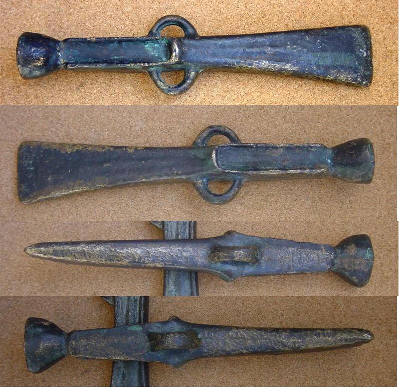

Wayne Kröncke,
Look at this pair of Palstave axes. This is an actual challenge to test authenticity. Even a certain expert, judging by the pictures, told me they were good. It took me a zillion demarches (museums and all) to end up finding out they were a fake. When one day i showed them to a well known local collector, he recognized them and told me they were the result of an attempt by some skillful guy in that, he bet he was able to reproduce his axes originals, so well that such wouldn't be noticeable.
In vain i tried to sell them with no profit;then i tried to return them to the local original seller ... with success. Mind you, he never tried to deceive me; he just sold me something he assumed not knowing what it was.

A socketed bronze form of the Ge dagger-axe, which were used later that the tanged ones just sold on a famous online e-site for a few hundred pounds UK.
Another similar one just sold on a UK Auction house real time online auction for around 12% of that
I'll have an easier time mounting it on a pole than the earlier one I posted.
(Yes, I bought the cheaper one)
No provenance on this one, real or not. I'll assume it is fake tho after all the above...
At least the Auction house knew what it was.
