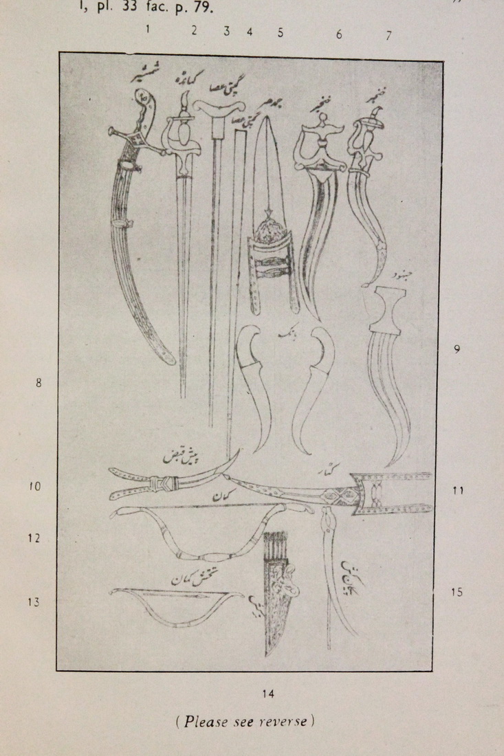

This is not an invitation to start a new 'game of the name', but I find it interesting all the same.
In Arms and Jewellery of the Indian Muguhuls by Abdul Aziz a plate with weapons is shown from A' in-i-Akbari (Akbar r. 1556-1605) - see the plate below. In this case it is nos. 5, 10 and 11 which is of interest. The text to these three numbers goes like this.
No 5 jamdhar, no 10 narsingh-moth 8 (according to Blochmann, in the plate the name is pesh-kabz) and no 11 katara.
All three we would happily call katars, but in the 16th century things seem to have been more complicated. It is interesting to see how little a weapon had to change before the name changed - especially when it comes to nos 10 and 11.
Pant wrote that a katar is not a katar, it is a jamdhar, and this seems to be correct, but only when it looks loke no 5.
Maybe it was Egerton, or maybe not, who 'collected' all there different daggers, and used the name katar.
As we dont know all the different names used for these daggers, my suggestions is, that we go on using the names katar/jamdhar and no other names, as it will only make the confusion bigger.

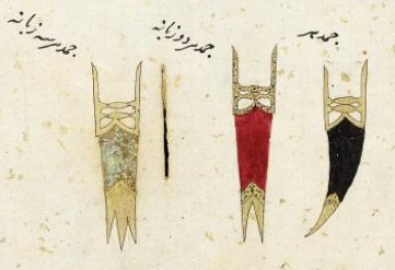

I agree with Ariel, it's definitely interesting that we have a few odd names (categories) that have survived to today, yet no native terms to distinguish straight and curved katars, even though arguably one of the most basic variations you could make to a katar (blade-wise) is to give it a curved blade.
For reference purposes, the surviving, clearly defined terms I've found are:
Bara Jamdadu - a "hooded" katar
Pattani Jamdadu - a katar with a long, straight (pata-style) blade
Jamdhar Sehlicaneh - a katar with a three pointed blade
Jamdhar Doulicaneh - a katar with a two pointed blade
All of these are recorded by Egerton, along with a number of other weird terms, however the ones listed above are the only ones with clear definitions that seem to have lasted, being reproduced by numerous publications since.
This is a fantasy picture from A' in-i-Akbari edition of late 19th. Like the inscriptions on it

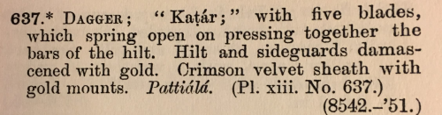

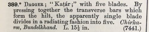

Again, these 'katars' (jamadhars, whatever) with often innovative blades such as one point, two point, spring loaded expanding blades, spear/arrow point etc. leave me wondering......just HOW were these supposed to be used?
While the standard methods of slashing cuts, or the thrust (often katar is termed a punch dagger)...seem possible with a normal katar blade, these other anomalies seem to defy logical use methods.
The idea of the spring loaded expanding blades worsening a wound is not feasible typically as it could not expand within the body in any degree, at least as I have understood.
The double or triple points would impair penetration overall, and multiple blades would be even worse for either slash or thrust.
So I wonder just what these unusually bladed weapons were intended for?

In regards to how they were used, I think there is no doubt that conventional katars are well documented as being nasty punching (stabbing) weapons. I've thrust (punched) mine into some thick foam before, just for fun, and the "wound channel" that was generated was quite impressive. Just a theory, but curved katars might have been created to capitalize on soldiers that felt more comfortable using the standard style of swinging a weapon in India; keeping the wrist stiff and slashing at an opponent instead of punching/stabbing them. No doubt a curved katar - or even a straight katar - functions (cuts) just like a really small pata. A curved katar might = a better cutting weapon, but any difference in that regard clearly wasn't important enough to create a large amount of them. It's possible that being so out of place in regular society made them not important enough to be named. Though I don't doubt that if you asked an Indian to give a name for a curved katar back in the day they would have just respond with (x) jamdadu/jamdhar. This given the whole thing that the "pattani" of pattani jamdadu - a long straight katar - comes from the (old?) root word "patta", a word used to describe a long, straight blade of grass (I believe Elgood notes this in Hindu Arms&Ritual). I think one of us really just needs to learn Hindi and then we can come up with our own specialized terms for these katars .
Regarding the actually unusual styles of katar, this is rather puzzling. Personally, I think having a multi-pointed katar (not one with multiple blades, just points cut from a single blade) is actually somewhat viable. Of course the points spread out the force, but assuming one can punch well with a regular katar, the force generated should still be sufficient enough to embed all the points into a target. To get a bit graphic, in regards to getting stuck on things (bone), a regular punch to the chest with a katar would maybe punch through bone, but more likely than not be redirected between the ribs. Depending on the angle and force applied, the widening of the blade could also push apart/cut into/crack nearby ribs, causing further damage. In regards to a katar with multiple points, just imagine the aforementioned, but the blade is wider, and (with a heavy maybe on this one) might be a bit more massive so as to do more percussive/bone-messing-up damage. I suppose realistically, my "thesis" here is just that more points should equal a more graphic, gory wound.
Multiple blades should, in theory, work the same, but with them all being so thin I can see them also being relatively easily damaged.
As a side note on the bifurcated Rajput-style katar (an example being one in Jens' catalouge, pg 134-135), I could see this one as either being an early tourist attraction kind of invention, or, again, a valid type (the construction of the blade - which splits into two only after the forte - seems relatively solid) that could create a more violent wound if used correctly.
"Scissor katars", IMO, are a total joke. Regardless of parrying possibilities, they seem to be so flimsily constructed that it seems to me a hit anywhere on the weapon would disable it's silly "amazing expanding blade action!" It also seems to me that if you want to ever actually use (punch with) a katar, you have to first squeeze the crossbars to adequately hold onto the thing, meaning the blades would always be open; ready to dent, chip, or break off as soon they get hit with an actual weapon.

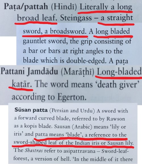

Originally Posted by Mercenary
The pata-sword and patta-leaf have different spelling and pronunciation in Hindi...
In any way they are different words with different meanings.
Well, yes, this is inherent in having two different words that mean two different things. Obviously pata-leafs and pata-swords are not interchangeable words, but that doesn't mean that one can't originate from the other.
Further supporting the whole patta/leaf thing, just look at the sosun patta, whose name literally translates to lily leaf, a reflection of the shape of the blade. The pata, it would seem, is the same way. A pata blade looks like a patta leaf, so the weapon came to be called a pata. The oldest phonetic spelling of the word, as per the 1860 Tanjore inventory (shown in Elgood Hindu A&R), is "puttah", which is way closer to "patta", clearly showing the transition between the two - or at least that's my take on it .
Either way, at least with the sosun patta, it's clear that swords could be given leaf-based names. All I'm arguing is that it's the same with the pattani jamdadu, which shows, in turn, that names can be "customizable" i.e. changed based on the characteristics of the blade/form or the weapon.
Pattani = pata/patta, a long straight blade
Jamdadu = a punch dagger (katar)
Pattani Jamdadu = a punch dagger with a long straight blade
Attached is a silly collage of definitions from Elgood, with the relevant bits highlighted. From Hindu Arms & Ritual and Rajput Arms & Armour, Vol II.
It is need to use Elgood's glossary very carefully. And descriptions of items too.
Sauasan. Arabic. Sword-leaf-forest. Very good stories for gentlemen in pith helmets
I met term "sosan" used for such a kind of sword but only in the second half of the 19th. Not early.
One never could be originated from the other.
It is in English "pata" and "patta" sound the same. Because in English there are only one character (and sound) "t". These words have different characters, sounds and the roots of the word: patta-leaf has root "flat", pata-sword has root related to "to strike".
Mercenary is offline   Reply With Quote
Old 9th June 2019, 03:39 PM   #22
... in English there are only one character (and sound) "t".
Not a good example: “ t” is pronounced differently in tank, mother, matter, notion , theater ( two different sounds), thistle ( one is altogether silent), thus, city, natural, not pronounced at all, and then there are other blasted exceptions:-)
G.B. Shaw quipped that the word “fish” should be written “ghoti”: gh as in “enough”, o as in “women” and sh as in “mention”.
I strongly suspect that multiple languages of India have their peculiar phonetic differences, rules and exceptions.

Originally Posted by ariel
Not a good example: “ t” is pronounced differently in tank, mother, matter, notion , theater ( two different sounds), thistle ( one is altogether silent), thus, city, natural, not pronounced at all, and then there are other blasted exceptions:-).
Thanks a lot. As I can see it is impossible to originate word "matter" from "mother". That's the point.

Elgood did his best trying to transcribe words of one language into another. This is a difficult and thankless task that is opening the “transcriber” to criticisms . I have no idea how the Indian words sound and what would be the best phonetic rendition of Sosun? Sausun? Sauason? Sossun? On top of that the sound should conform to high-class British English. To his advantage he was doing it while staying in India, surrounded by native speakers and professional linguists.
So, guys, perhaps Jim ‘s comments have a grain of truth, and your sniping criticisms reflect not so much phonetic shortcomings of Elgood’s work, but your limited knowledge of languages? Nothing offensive, that can happen to anyone.
Matter ( as substance) and mother come from the same Sanskrit root “ma”,
And BTW, it was Carl Jung ( who by all accounts was not a dummy) who said that the root matter is the mother of all things.
As to the apparent impropriety of using “leaves” in describing “blades”, please recall that leaves of grass are called blades in English, and Walt Whitman is my witness:-)

On a different note, I was doing some reading in the old Egerton today (mainly because I got a copy out of my local library that is due at the end of the month), and I noticed a few peculiar things.
The most concrete-ish one is the term used to describe a late (as I understand it) form of katar - the Garsoe katar. I've asked Jens about this type previously (in private messages) and I know that he hasn't got a clue as to the origin of the "garsoe" part. Logically I suppose it was just the local name for the type, but what it actually means is of course the big mysterious part.
Even more curious is that at least twice I've found listings for five-bladed katars! They're described as functioning like regular scissor katars, only with two extra blades! Of course these would mostly only function as extra-special status pieces, but their existence in and of themselves is just, well, curious! I'm pretty sure I've only ever seen three blades on a katar, spring-loaded or otherwise.
Relevant pictures attached.

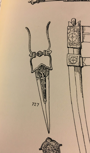

As Nihl has noted in previous post, the curious 'Garsoe ' katar/jamadhar which appears in Egerton (p.138, fig. 727) image attached, defies any definition as to 'why' it has been given this term, or for that matter, why its sidebars are scrolled or undulating.
As I previously mentioned, Jens has an incredible knowledge of the katar, pretty much unparalleled, and if he has not found an answer, it is so deeply hidden that possible no accurate solution may be discovered.
We know that seemingly, Egerton made the first reference to this form of jamadhar/katar and decribes it as with 'curved side bars' (plate XIV, #727) as a 'garsoee katar'. ...and from Bhuj, Kach.
These regions are in Ghujerat, with Bhuj a major city and Kach (Cutch) also a key province. Sind (now in Pakistan) is situated north of Gujerat and separated from Gujerat by the huge salt marsh known as the Rann of Cutch.
It does seem that these regions have given us another distinct weapon, commonly called elephant sword (for the fixture on the hilt using that figure) but often termed a 'bhuj'. This is a hafted dagger often seen used by Sindhi horsemen(picture attached).
It would seem that this curious curved bar katar was perhaps named for the place from which it is known(or tribe?) given the propensity to term a weapon in that manner (i.e. bhuj).
Whatever the case, the Egerton(1880) term (again) stood and was perpetuated by other writers. This carried to the great conundrum which was discovered by Jens in research he was doing on this about 15 years ago (seen in posts by him in 2006).
In "Contribution a l'Etude des Armes Orientales" ( Holstein, Paris, 1931, vol. I, plate XIII, #19) a curious extremely simple transverse grip dagger is illustrated...….it is attributed as 'GARSOE KATAR' from Bhoudj, Catch, and from the Henri Moser collection in Musee d' Berne.
However the curator of that museum insisted that no such dagger in the collection (now in storage)existed. It does seem that in Holstein another dagger with the curved bars was shown in the plate. Obviously this must have been a captioning error (?).
While not offering a solution to our dilemma, it seems clear that even by 1931, nobody knew what 'garsoe' meant.
Pant (1980) shows a Garsoe in fig. 489, but reference on p.173 simply refers to the illustration, saying it has already been described.

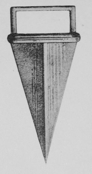

The images:
1) the Holstein (1931) image of a 'katar' described (apparently wrongly) as garsoe katar, #19, plate XIII
2) 1827 map of Sind and Catch (Kutch) in Gujerat, the water area (in appearance in the huge Rann of Kutch salt marsh (seasonal).
3) Sindhi cavalier wielding bhuj knife (from Haider)
4) the Egerton (1880) entry for garsoee katar (#727,)
