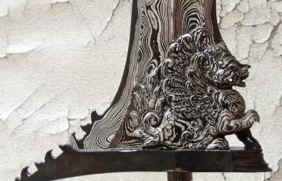

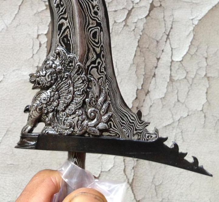

This is my new commissioned Balinese keris. I would like to seek comment, should gold plating be done on the motif or it should be left as it was in current state.
My impression was Balinese keris are always 'colorful'. I would like to try to stick to the tradition and originality if possible.
Thank you.

Hello Anthony,
I can see no reason why not to put gold on that singa...
Make sure that all rust gets removed first though. Please post better pics once you receive this keris!

Yes, strange to see what appears to be rust already setting in on this brand new blade. I agree with Kai. As a newly commissioned blade i think it is certainly your prerogative to add kinatah to this blade. But definitely be sure the rust is completely removed first. Also, for my tastes i would stain the blade darker.

The gonjo seems to accept the warangan better than the blade. It already seems to be a bit on the dull side, too.
If it were mine, I'd request:
(0. Finishing the scabbard first; )
1. A complete and thorough cleaning of the blade (with removing all rust and staining);
2. A thorough polishing job on the blade;
3. Verifying the blade;
4. Applying the kinatah;
5. Another approval step;
6. Warangan done quickly (not by soaking the blade) - actually, I'd prefer to do this myself;
7. Neutralizing and thoroughly drying the blade;
8. Amply oiling and wrapping the blade;
9. Checking pics again (and shipping all pieces unmounted).

Thanks for advice, i almost overlooked on that part about rust and mention it is not final product.
This is not the final bilah condition i assume but i will ask. Currently it is sent to get warangka made and also a Balinese painter needs to paint on the scabbard etc.

I am not sure as I saw most Balinese keris with kinatah is actually more colorful and has floral motif around it. This keris only has a motif. I saw most motif only keris of Balinese tradition is not coated with gold.

Thanks GOD that I decide not to put GOLD plating in the first place orelse it will covers the beauty. I left it as it was and it is awesome.

I agree Anthony. The pamor looks beautiful within the winged singo. It would be a shame to cover it up, even with gold.

I love how the pamor makes the wings on the beast look feathery.
Also the eye seems to be looking at the viewer on this side of the sorsoran. Can we see the other side of the blade?
