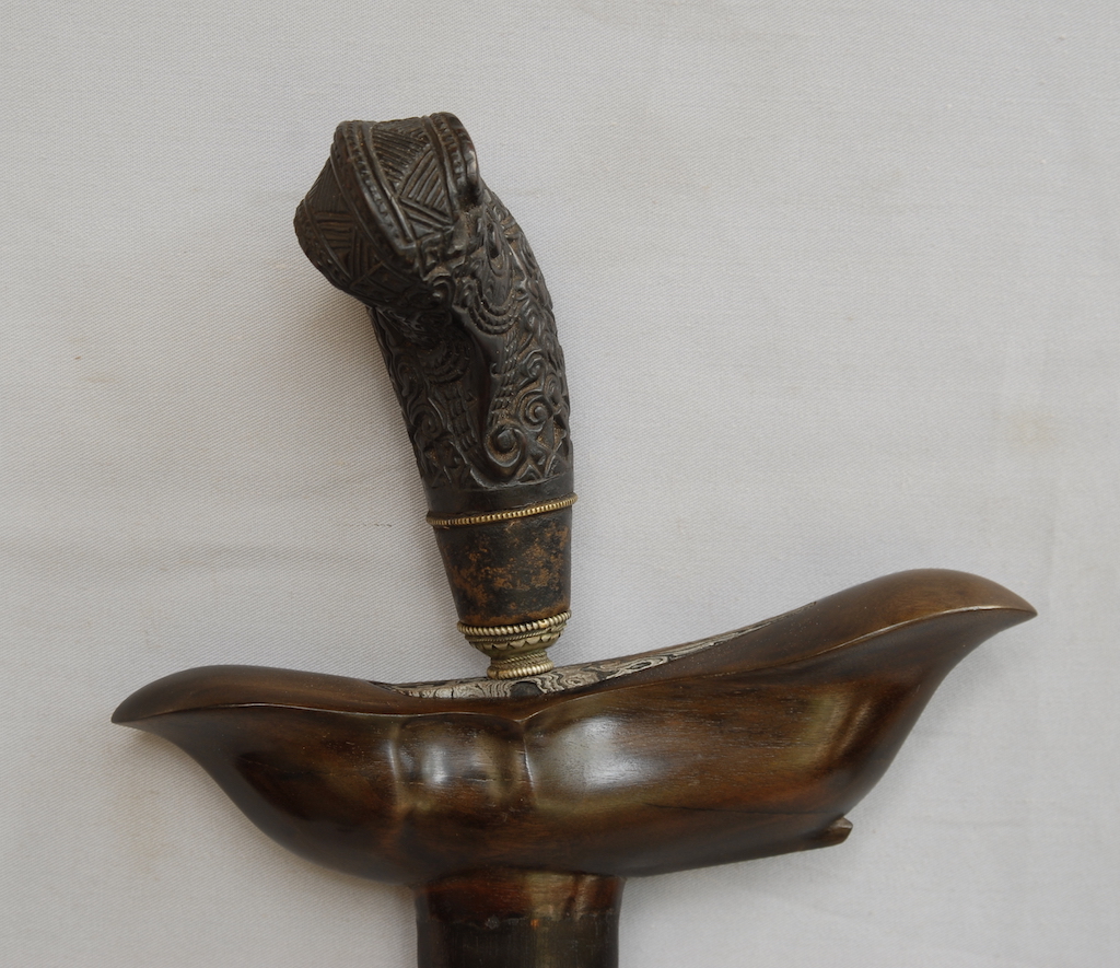

has run its course, so here is another keris for comment.

So what can you tell us about this particular form of wrongko Alan. I am presuming it is Cirebon. What era does this form originate from and did it serve a particular purpose (it seems more formal than everyday to me)?
Hello David,
I would place it a little bit more to the East, Tegal. Handle and wrongko are typical.
PS: nice fitting sarung!

Thanks Detlef. Tegal and Cirebon are often a bit of a confusion for me as they seem to share some similar dress styles.

Area of origin is Tegal.
I do not know the name applied to this wrongko by the people who used to wear this style, in Solo I have heard a number of people refer to it as "Teratai", "teratai" means "lotus/water lily", it is Malay/BI, rather than Basa Jawa, so "teratai" is likely to be a dealers' name or collectors' name rather than the name used by the people who made it or wore it --- something like our previous "caping/capil".
The hilt is a stylised Ganesha.
Tegal is located in North West Jawa Tengah, near Pekalongan.

Among European collectors this style of wrongko is said to have "hanging ears" on the sides.

Yeah, well I guess it has got hanging ears, so there's another option for a collector's name:- "wrongko kuping gantung".

I am still curious, however, if you know if such a wrongko would have been suitable for formal dress or was is more for every day wear?

Kuping gantung is a nice name for this wrongko style!
David,
I only can guess but the few I've handled have looked as they have been for every day wear.
Old 26th March 2019, 02:00 AM   #10
Posts: 7,256
David, I've never been to Tegal and I do not know anybody who is keris literate who comes from there, so I am not able to provide a valid opinion. However, based upon the fact that the style of this wrongko is low and rather durable, I would guess that it is the Tegal equivalent of a gayaman.
Detlef --- remember where you heard it first when somebody tries to sell you one.

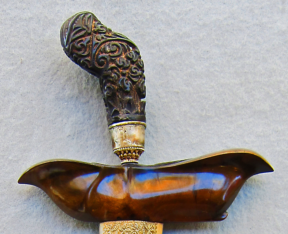

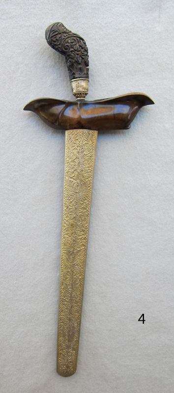

Another sarong like the others ( not mine .... a mine Javanese friend has this keris)
