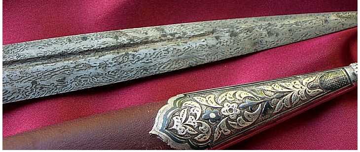

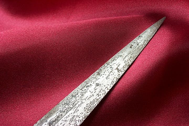

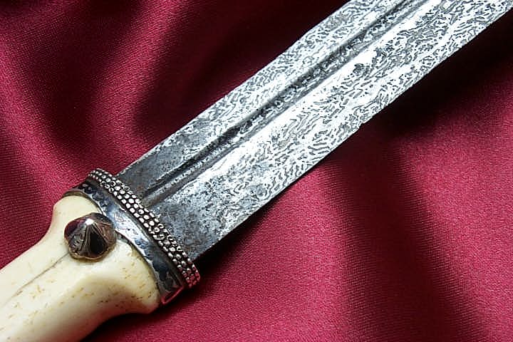

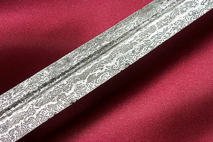

Dear All,
Very unusual kindjal. I alway wondered what is it - damascus, sophisticated etching or something else.
Thank you very much in advance.

Hello Rivkin,
This is acid etching to simulate a damask, it was probably done in Tiflis.

Old 17th May 2006, 07:10 PM   #3
Very nice job. It has certain chaos in it, as opposed to the "fuller job" that is so often seen, and it imitates damascus so well that even Kirill was uncertain

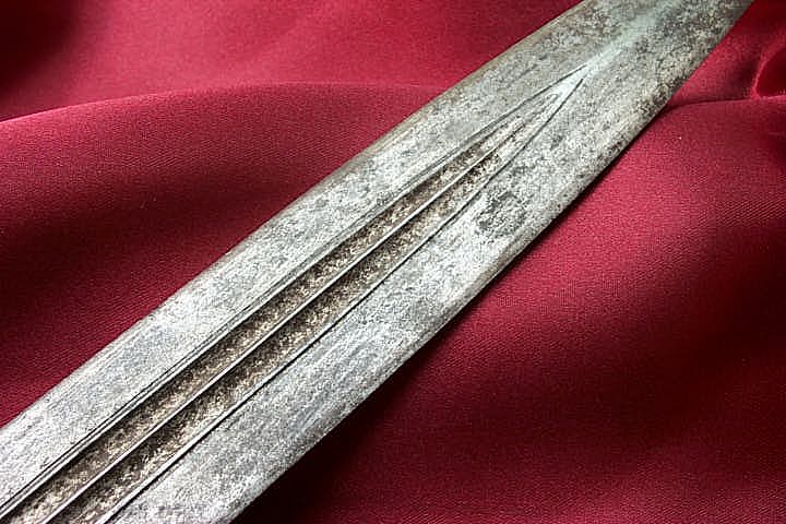

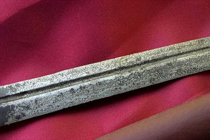

Ham - excellent, right on target. Kindjal is indeed from Georgia, but I was truly puzzled by the technique. Thank you very much.
Ariel - well, not all of us are senseis , plus I really suck in understanding the metalwork.
Attached are kindjal's pictures.

Posts: 655

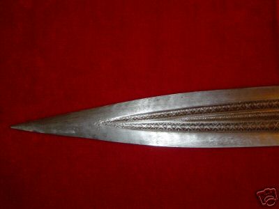

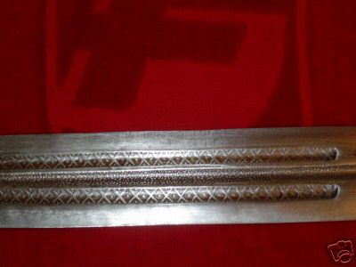

To continue our kindjal's discussion - the first is an interesting georgian (?), even more precisely imeretian (??) speciman. The most interesting are the fullers - inside them one can see a set of extemely small dots, creating a highly unusual pattern. I have no idea what it is, it is far smaller and spatially irregular, i.e. the dots are very small, than any etching I have seen.

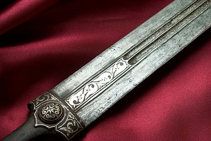

Rivkin
Posts: 655

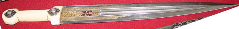

And finally - sorry, these are the only pictures I have on this one. Sort of way too expensive for me. My take would be that it is something from eastern, probably south-eastern caucases, seen many of them with similar motiffs.

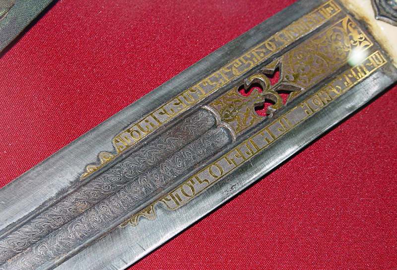

Rivkin
Posts: 655
I almost cried. Kindjal, I would say Tbilisi, armenian work, 1800-1830.

Old 2nd June 2006, 05:41 PM   #10
It is also etching.
Can you read the inscription?
I wonder why all the pieces with Armenian inscriptions come from Georgia. Sure, I know that there were many Armenians living there. But, why nobody, to my knowledge, refers to any centers of swordmaking in Armenia proper?

Posts: 1,099
In my opinion, the last Kindjal posted with the walrus ivory grips, the pattern in the fullers is the result of twist core pattern welding and not an acid resisted etch. You can clearly see the line of demarcation down the center(albeit, it is not perfectly straight, nor should it be) in both fullers. The pattern is a classic "Turkish Ribbon" style of pattern. You see this particular starry night pattern as Ariel put it on some Yataghans, some Chinese blades, some Moro stuff and if you go far enough back, you see it in some Viking blades as well.
