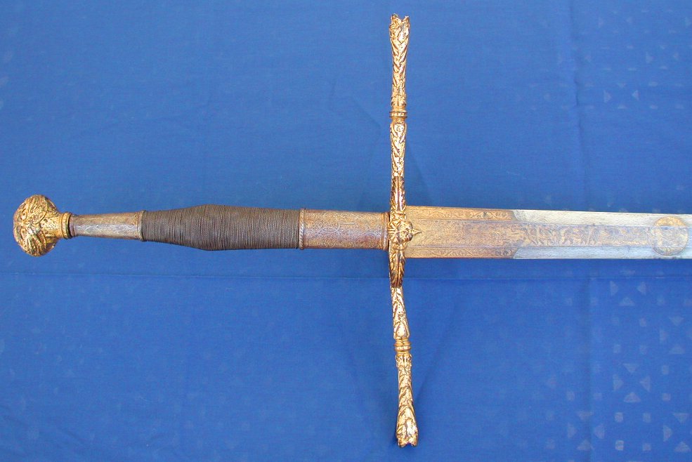

Two Hand Sword
Italian and German, about 1550
Steel, iron, gold, wood
Dimensions: length overall, 57 3/4 in. (146.7 cm); blade length, 44 1/8 in. (112.1 cm); weight, 5 lbs. 10.5 oz. (2565 g)
Description:
Two hand sword with gilded and chiseled iron pommel and guard, and a straight double edged steel blade decorated on each side with an etched and gilt frieze and roundel. The pommel is in the form of a flattened sphere and is chiseled in relief with a stylized leafy leonine mask that repeats on both sides. The matching guard has straight quillons and a large horizontal side ring extending out from the center of the guard on both sides. The quillons are chiseled with symmetrical acanthus leaves, have a baluster-like swelling at the midpoint and expand slightly at the ends, where they terminate in a lion head with an open mouth (the stem of a tongue remains in one of the mouths). The side rings are similarly chiseled and have knop in the center. There quillon block is chiseled with a crossed leafy branch motif and has a short triangular extension (ecusson) on both sides. The grip is in three stages: a tapering cylindrical collar of etched and partly gilt iron at the top; a carved wooden grip wrapped in iron wire at the center; and a straight sided flattened cylindrical matching collar of etched and gilt iron at the bottom. Traces of red textile fringe are visible between the edge of the bottom collar and the top of the quillon block. The blade has a short ricasso and a long flat fuller extending to the tip on both sides. An etched and gilt frieze decorates the upper 9 1/2 inches (24.1 cm) of the blade, including the ricasso, on both sides. Each frieze contains a battle of naked men, wearing helmets and armed with swords, clubs, and spears. At the end of each frieze there is a roundel: on one side it contains a man on a leaping horse, probably representing Marcus Curtius; and on the other two figures on foot. Just beyond the roundel on one side the blade is incised with the running wolf mark of Passau. A small deep star-like mark is stamped near the edge of the ricasso on opposite sides of the blade.
Condition:
There is wear to the gilding on both the hilt and blade. The etching on the grip collars is slightly rubbed. Otherwise the condition is very good.

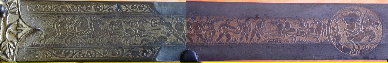

Decorated swords from the early to mid-sixteenth century are rare and decorated two hand swords of that period are rarer still. No sword of this type and of comparable quality has been on the market since the early 20th century (the only comparable sword in the Metropolitan Museum of Art entered the collection in 1904 when the Museum acquired an Italian two hand sword [04.3.290, currently on display in gallery 371] as part of the Duc de Dino Collection). Although both the Erbach sword and the Dino sword have very attractively etched and gilt decoration on their blades, the Erbach sword has much more intricate, lively, and original chiseled ornament completely covering the surfaces of its pommel and guard. The motifs and the style of its ornament are reminiscent of a series of elaborate sword hilt designs by the Mantuan artist, Filippo Orsoni, as recorded in albums of his designs dated to the 1540s and 1550s. The etched decoration on the blade of the Erbach sword, while Italian in style and execution, is based at least in part on engravings by the Nuremberg artist, Bartel Beham (1502-1540), particularly his Battle of Eighteen Nude Men (Bartsch16; Pauli 25). The sword grip is a replacement that includes sixteenth century German fittings. The grip may have been added to the sword anytime from the late sixteenth century up to the mid-nineteenth century. Overall, however, it is very likely that the key elements of the sword - pommel, guard, and blade - have been together since the sword was created. This is indicated by the fact that pommel, guard, and blade decoration all appear to be of Italian workmanship of about 1550; by the precise fit of the blade to the guard; and by the superb balance and form of the sword as a whole. It is very unlikely that all of the elements could have been so successfully combined and harmonized in a composite made for the art market in the late eighteenth or early nineteenth century. This sword is further distinguished by its Erbach provenance, one of the earliest and best documented Gothic Revival armories in Germany and the source of important pieces in various museum collections, including three in the MMA's collection: the horse armor dated 1548 and made for Johann Ernst, Duke of Saxony (32.69); the armor of Emperor Ferdinand I (33.164); and a Dutch chiseled steel rapier of ca. 1650 (1995.51).
I, and others, had done a fair amount of research on this weapon. Stuart Phyrr, of the Met, is of the opinion that it is a Medici piece. He is doing work on the Medici archives and has his eye on trying to nail down a provenance. The iconography is classic and probably listed from a German master. I have scoured the works of the German "Little Masters" whose work was appropriated for decoration of other objects. I got it in my head that it was from the Saxon court, because of the medallions on either side of the blade. This was poo-poohed for reasons that I cannot discern. Still think the idea has merit. The medallions match those on the helmets of the royal guard.
Anyhoo, I'll start posting some pictures now.

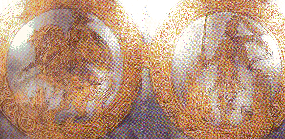

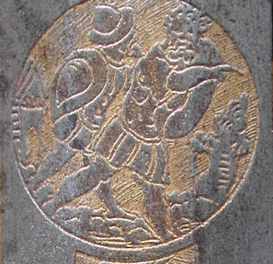

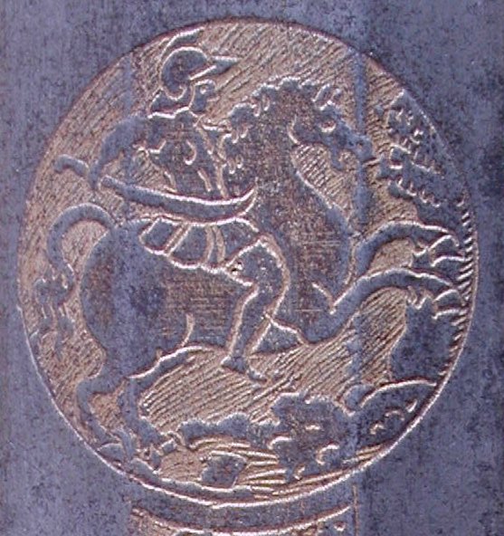

These engravings show a classic 16th century battle scene with a medallion of Marcus Curtius descending into hell.
For completeness I am also showing the medallion from the other side. This shows Gaius Mucius Scaevola putting his hand into the flames. These were two popular and inspiring images at the time and they both appear on the helmet of the royal Saxon guard. The helmet was in the Higgins Armory Collection and kindly made available to me by Kent Russell, curator at the time.
