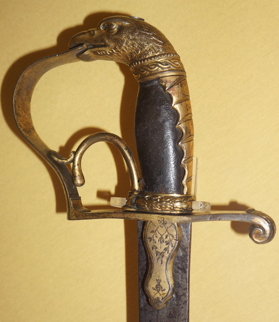

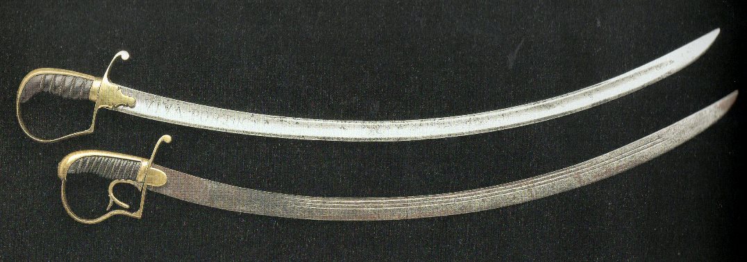

I Saw this saber on a antiques shop, don't know this model, anybody recognise it ? It was no visible marks.
Tks!
BV

This is obviously a stirrup hilt of M1796 British light cavalry form but the langets are compellingly similar to those on Indian tulwars (Indo-Persian form hilts) and may well have been for units of cavalry in British service in India. The M1796 while one of the first 'regulation ' pattern swords for Great Britain, seems to have had quite an array of variations as private contractors producing them responded more to demands of the colonels purchasing them than to strict pattern design in certain elements.
This sword 'pattern' itself was much favored in the Indian army and remained being produced (again in variant interpretations) well through the 19th century after the succession of the 1821 patterns which followed the 1796.
Interesting example, and the only such variant 1796's I have seen were some in brass, also with Indian style langet which I believe was for EIC native forces after Seringpatam (1799). I have also seen steel shamshir type hilt with tulwar style quillon terminals and langets.....with British M1788 blade.
I think all of these may fall into an EIC category of private purchase arms.

The 'Flank Officers', of the light infantry, skirmishers and rifle companies used to screen the sides of the Line regiments, favoured the more highly curved variants like the one in post #1. Private purchase officer swords frequently did not have the riveted backstrap 'stirrups' that the troopers had. The wire wound grips were not used on troopers versions.
The Indians were offered the 1908 brit 'sabre', but it was unsuited to their preference for the cut, so they kept a 1796 style hatchet point blade with slight improvements and a three branch 1821 style steel guard as Model 1910 until the UK forced them to use the 1908 for ww1 in Europe.

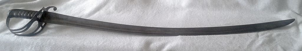

Mine: Slightly wider at the blade/guard junction, a tad shorter and a bit lighter than my 1796 LC. It's also a bit handier.

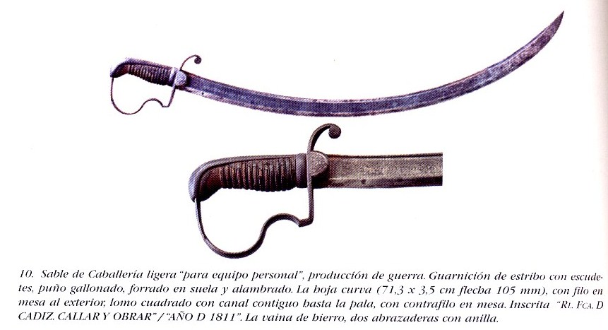

Bruno, do i recall correctly in that you told me you have a copy of AS ARMAS E OS BARÕES by Eduardo Nobre?
If you hit page 121 you will see two sabres in that the hilts visibly resemble the example you posted. Characteristic of Portuguese light cavalry, as per 1806 regulation.
The absence of a prominent pommel is a revealing detail. So is the shape of the langets, an orientalist design bringing memories of Moorish influence. And i wouldn't be surprised that the tang end is screwed to the hilt dome and not peened.
Blades in these swords were sometimes bent to an exagerated point (so called parabolic), a typical period show off fashion, like IN HERE.

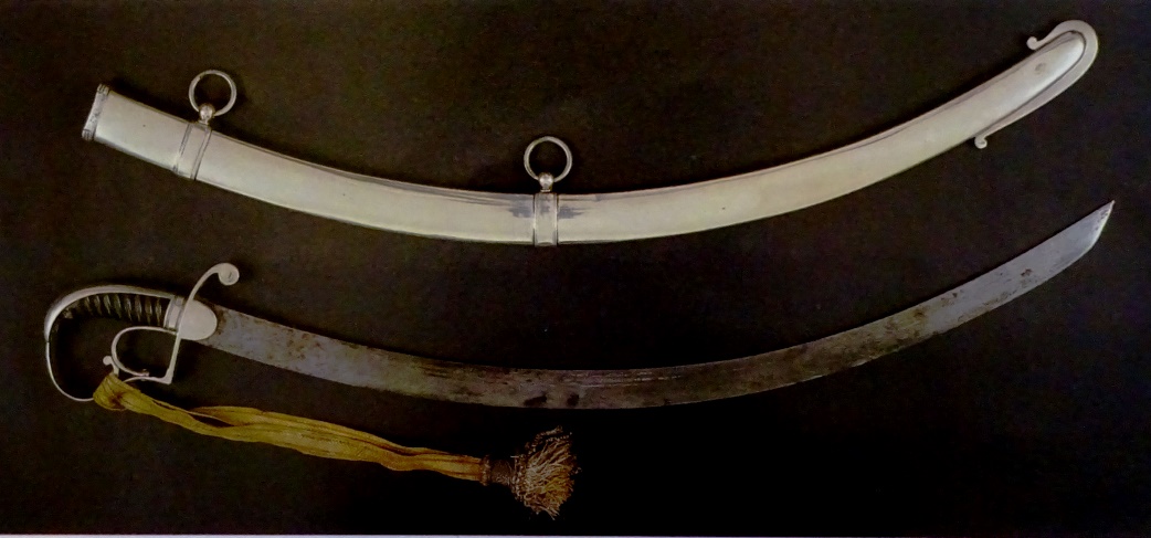

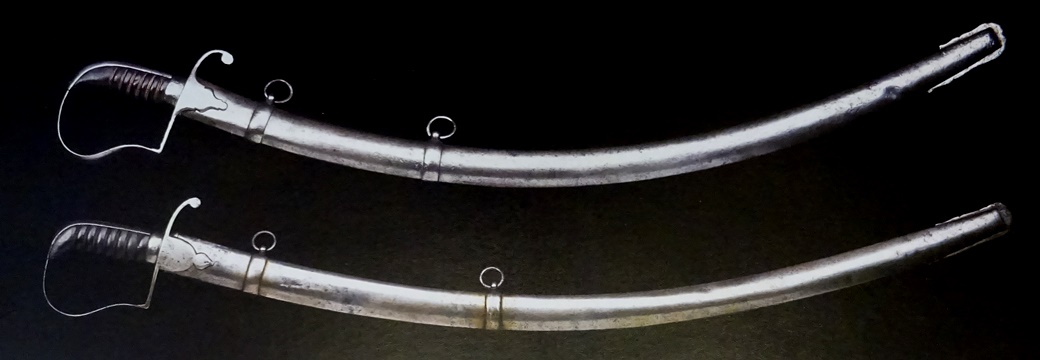

A "De Luxe" version of the 1806 Uniform Plan (as it was called) would be this example, provenant of the House of Marquis de Fronteira.The scabbard is silver, with a textile & gold knot strap and tassel. The well bent blade with traces of having been silver plated, with three fullers as from the second quarter. The hilt is in silver, with an internal riveted finger guard. The grip is ebony, with braided silver wire.
(Courtesy Paço Ducal de Vila Viçosa)

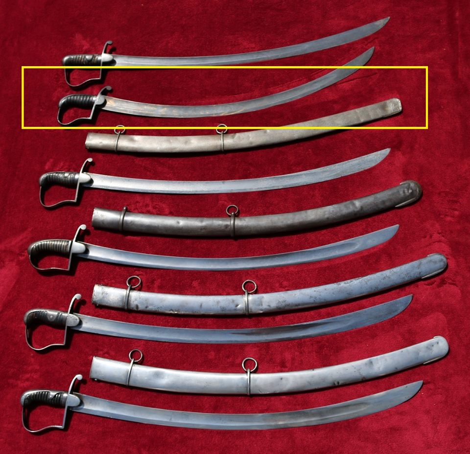

The top sword in Fernando's post 4 looks like a match. I think we have a winner!
And the prize is ... a saucer of barnacles ... and a pint of bitter .
