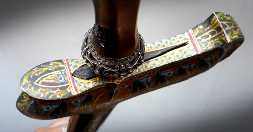

If we consider these Sunggigan krisses as being used for formal events then there is no difference in the dress code for a Gayaman versus Ladrang as opposed to the unpainted versions?
Here is one with a black back ground?
Decorated with Kala and one eyed Bintulu creature (along the opening of the blewah).
Paul B. is offline   Reply With Quote
