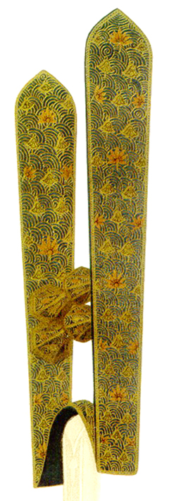

You have an old and very nice katar – congratulation. The midrib on the blade is the ‘Kundalini flame’ or the ‘Tree of life’ springing from a lotus bud.
I agree with RSword that the question about etching or not is a difficult one. You know what you have, but can’t be sure of what you will get. Normally, if the pattern is very week, I would etch the blade – but the decision is yours.
I am not sure that it is umbrellas shown on the side guards; my guess is that it is flowers, but I am not sure. Have a look at the picture shown, do you think it is umbrellas or do you think it is flowers? I think they are flowers.
It may be easier for you to see if I add the picture - sorry .

I remembered to have see the decoration on the side guards before in one of my books – but in which?
I started with Hendley, and in the second I found. ‘Damascene Work in India’ it is on plate 25. Here is what he writes about it.
‘Hindu thrusting dagger. False damascening in gold from Kotha, a great State, an offshot from Boondi in Rajputana; cost Rs. 50. Here gold of different tints has been employed with good effect.’
Using a magnifying glass I can't see that the two side guards can be closer to each other.
Even the number of flowers seem to be the same.
Sorry, I forgot, the book was printed in 1892.

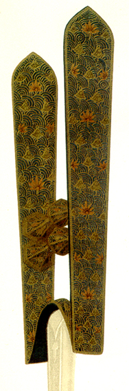

Some may have wondered where the places mentioned are, besides being in India.
Rajputana is roughly coextensive with the modern state of Rajasthan, Boondi/Boondee is now called Bundi and Kotha is called Kota. Try the link below, and you will find Bundi and Kota in the lower right corner of Rajasthan. http://www.mapsofindia.com/maps/raja...travel-map.htm it is always interesting to know from where the weapon comes, and in the book Th.H. Hendley tells us, from where the katar in his book – Damascening on Steel or Iron, as Practised in India, comes, from this information, we also know that the katar shown in the book was made before 1892 – the year the book was published.
I will add the picture once more as I have lightened it, to make it easier to compare.

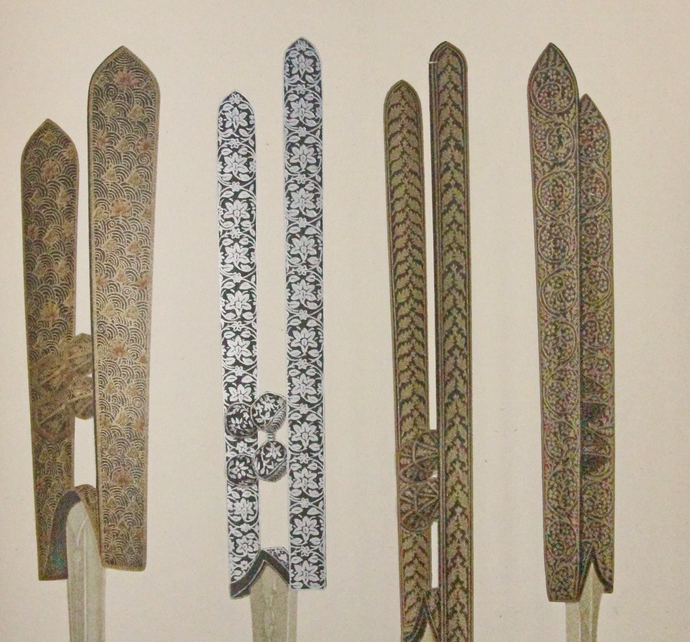

I think it will be easier for you to see the difference of the katars if I show all four katars on plate 25. The three other katars shown are said to be from Delhi.
