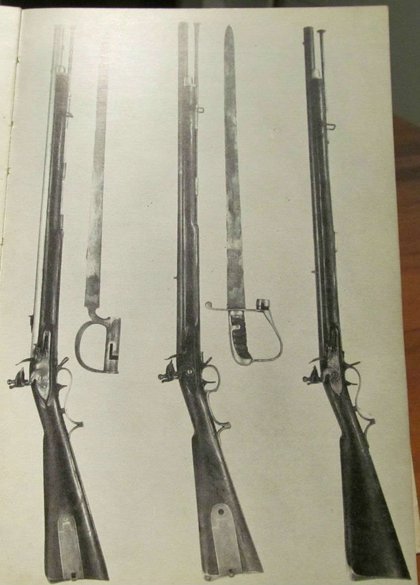

Hello
The saber-bayonet was also produced by private gunsmiths, for the volunteers. Here some variants
Affectionately. Fernando K

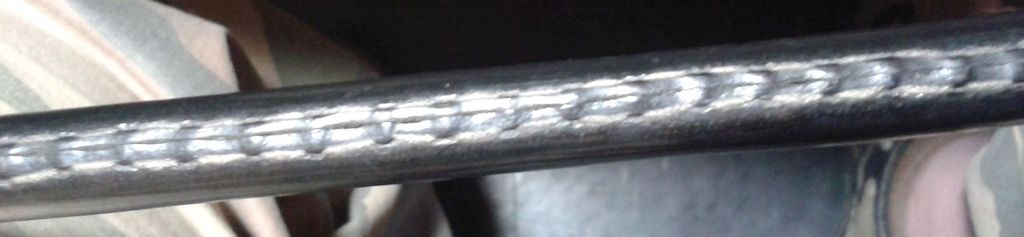

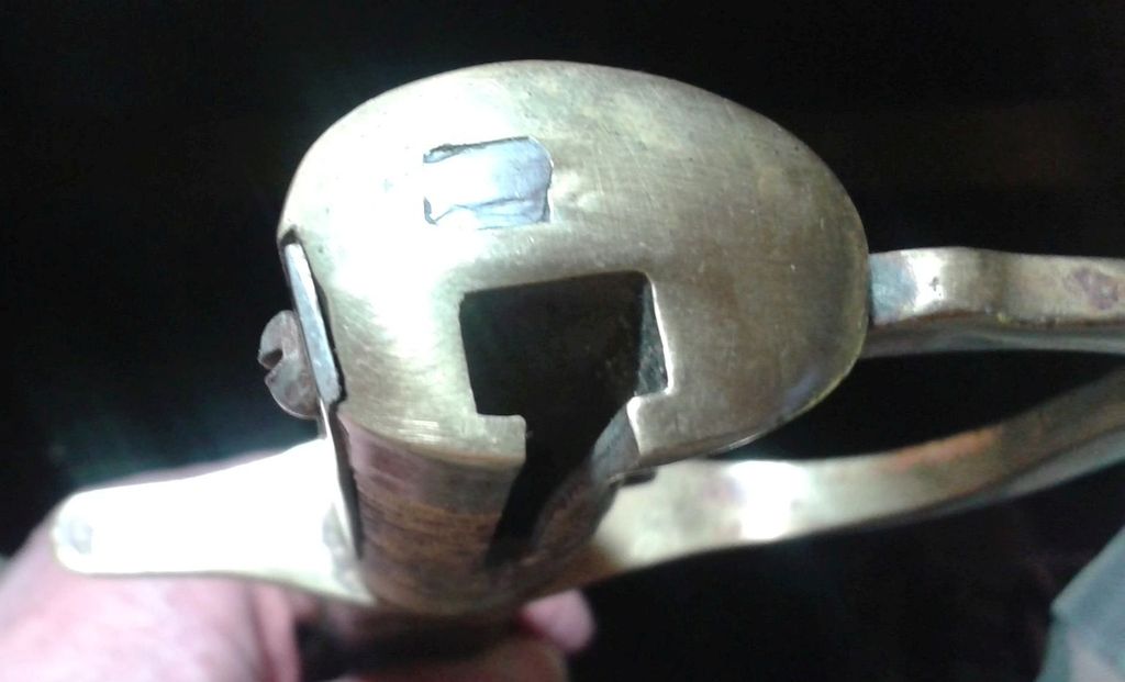

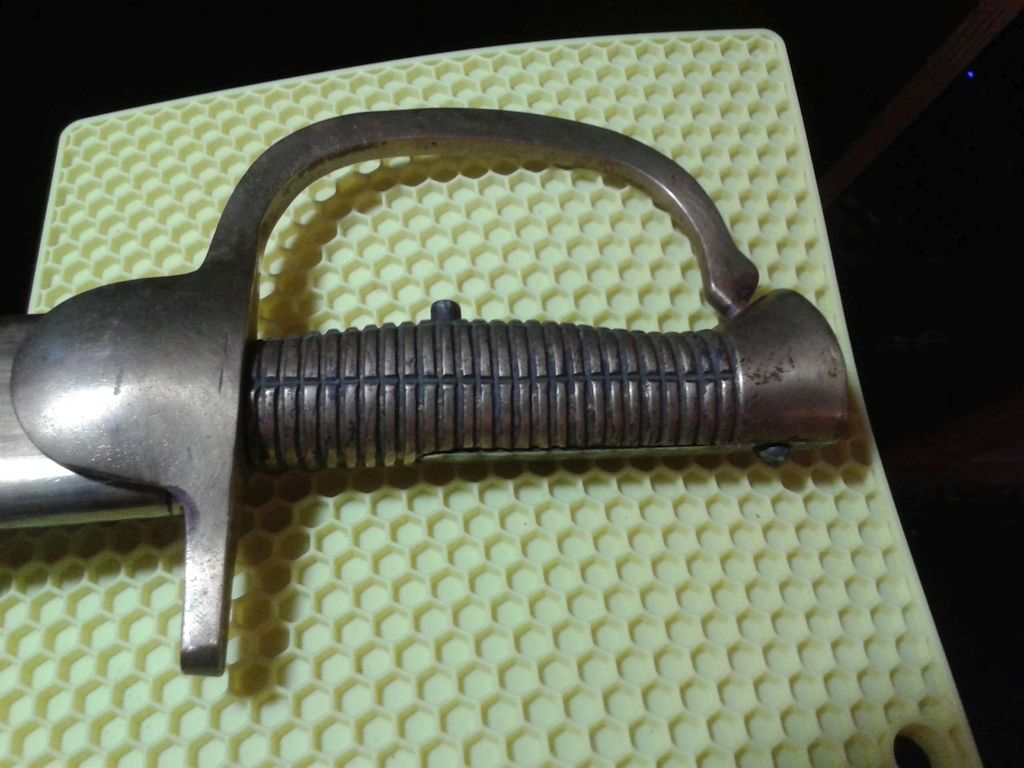

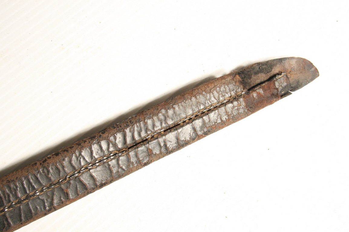

Do you have any pictures of markings on your Baker bayonet ? The back edge of the blade near the ricasso is a typical place for makers mark or on the brass languets for unit marks. Can you also do some pics of the stitching of the scabbard seam scabbard . Thanks.
Old 31st January 2018, 03:46 PM   #6
Picked it up from vendor today. pics as below. Can't find any markings blade has a lot of black oxide staining, no pitting. edge like a butter knife, but very sharp point. brass is oxidised a bit, some verdegris under the languet. Stitching of scabbard is two lines of dirty white thread 1/4in. stitches that cross under the central seam, on the edge side of the scabbard. Blade is 23 in. long, 3 1/2 in. false edge, 5/16 thick at ricasso, 1/4 in. at the false edge. 1 1/8 in. wide at ricasso, a hair over 1 in. at the end of the false edge. grip is 4.5 in., inc. the guard. 4 longitudinal grooves, 26 circumfrential ones. Blade clicks into place in scabbard over the last 1/2 in. or so. Steel spring and button assembly in place, retained by a slotted dome headed screw.

this almost certainly is an Indian made Baker ... some authorities describe them as 'Indian State Forces' Bakers. In the 1980s World Wide Arms imported a lot of them from India , there is some debate as to whether they had gained access to a State Armoury or were having them made in India . However later on they began to sell ones with British manufacturers names on them , this batch was definitely made to order . The presence of a scabbard is usually a good indicator of relatively recent manufacture as Baker scabbards are far far rarer than the bayonets themselves.
