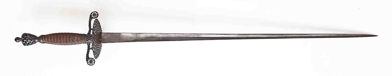

This is a small sword indeed, not only for the style but also for its small dimensions, with a blade measuring 26" which, if its point was not broken (to my despair) would be no more than a couple inches longer... i guess.
The hilt the cut steel type ... ma non troppo; as this is the simplest of the kind i find out there.
No doubt a Colichemarde blade, with its hollow ground three faces.

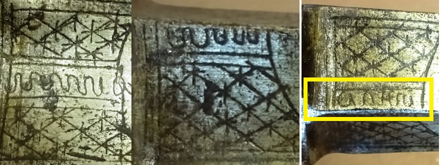

Interesting that it still keeps the leather 'washer' that softens the impact of the (missing) scabbard. It could be my imagination but, one of the arabescs in the decoration looks more like the name of the blade smith.
Culd you Gentlemen favour me with your comments, age and provenance included ?
Thsnk you so much in advance.

Hello Fernando.
A fascinating piece, not least because I suspect (I am open to contradiction of course) that it is a younger hilt: probably to preserve a much treasured blade.
Matthew Boulton was almost certainly the source of the hilt, but I am of the opinion that the true Colichemarde blade (with distinct shoulders) was out of fashion by then. Please correct me if I am wrong as informed details regarding the lifespan of the Colichemarde have eluded me to date.
Old 9th June 2021, 08:54 PM   #3
Posts: 10,862
A fascinating example, and indeed cut steel type maxime, probably English and 1790s. It was the sunset of the small sword, but its influences held in the hilt stylings in numbers of military swords in artistic sense as favored by fashion conscious officers.
As usual, the chain guard is missing, and very attractive etching in the blade, which is as noted 'colichemarde' (the widened upper portion of blade, said to be for parrying). While these were in use from mid 17th century into early 18th, they were regarded as 'out of fashion', at least in most civilian examples.
However, military officers always held to tradition, and these blades were well known on officers small swords well through the 18th c.
The 'cut steel' (some of these almost look 'steam punk') hilts were made popular in England mostly around London and Birmingham, and industrial revolution figures like Boulton were heavily involved in designs (Aylward, 1945).
This probably belonged to a British officer, perhaps with fraternal associations which might be identified with closer look at the motif and circled inscription.
**** Urban, we crossed posts!!! The hilt looks like the 1790s-1800 period hilts made as noted, but I am inclined to agree this is a way earlier, probably heirloom blade, and the motif may well go back into very early period, possibly into 17th c. and the blades we know so well !!!!

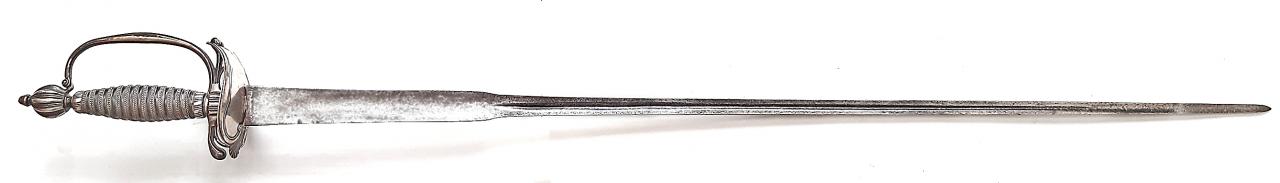

I have a William Kinman silver, boat-shell hilted example with a 33" (84cm) blade (which was unusually long), and while the hilt is in perfect condition, the blade looks a good 100 years older. Kinman was marking from 1765 to 1799, so again, as in Fernando's example, I suspect it was a re-hilt (see image).

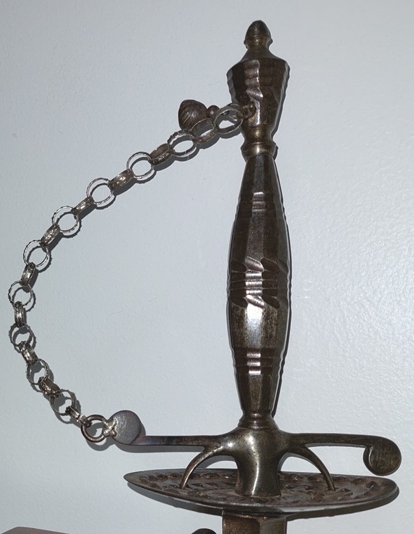

There are a lot of munitions grade smallswords that also feature this groove as it was far quicker and cheaper to produce; although this second image is of a special order smallsword made for a naval officer during George 3rd's reign by Thomas Gill of Birmingham that was obviously an expensive and unique commission; again, it features a Boulton hilt.
By this time the Mohlls/Molls/Moles were working down in Birmingham and using their rolling and grinding machines; but not, I hasten to add, under their own name.

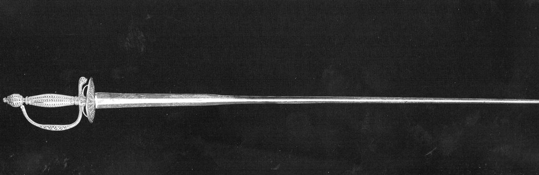

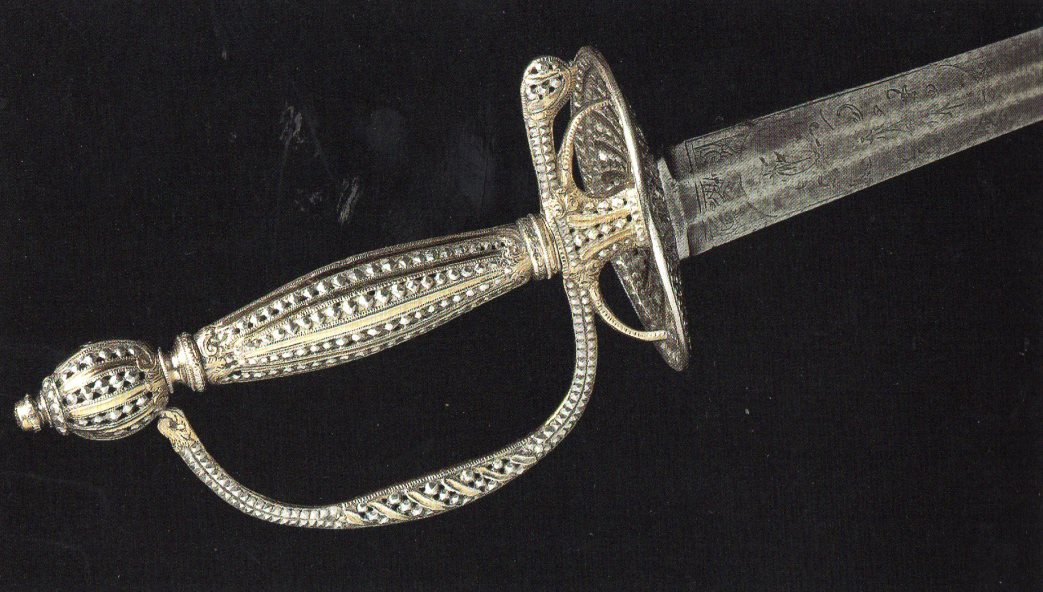

And once Keith notes that there aren't many of these swords out there, i will here upload a high end example, that comes in AS ARMAS E OS BARÕES, by Eduardo Nobre. The silver hilt has gilded decorations, and zoomorphic figures.
Old 11th June 2021, 01:35 PM   #7
urbanspaceman
Join Date: Sep 2017
Posts: 736
Default Eduardo Nobre Colichemarde
This is a magnificent sword Fernando: truly superb. Is it part of your collection?
It is not possible to see in detail, is the blade a hollow trefoil blade?
It looks like a style of colichemarde blade (accurate name unknown to me) that I have wanted to acquire for some time and features in the Diderot page of blade shapes number 5g. Is it called a flattened diamond shape?
There are even less swords of this style than the regular colichemarde.
