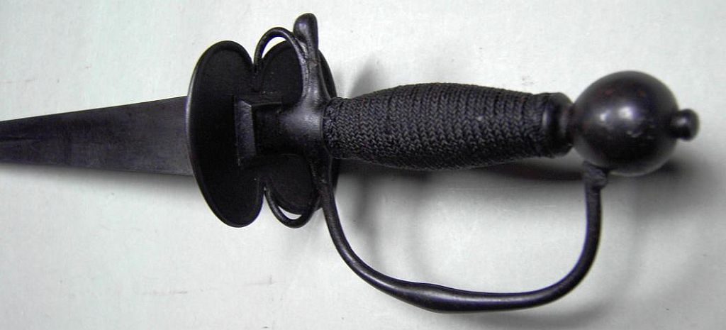

Blackened hilt does not mean a mourning sword.Specifically, small-swords [or hangers, as they were called then] with simple, bilobate shell guards, mostly unadorned [save for scalloped borders], were, IMHO, sergeant's swords from the early to mid-1700s.

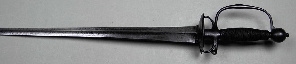

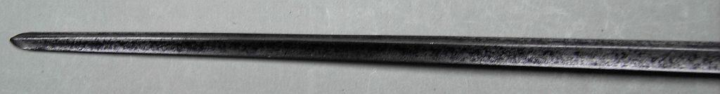

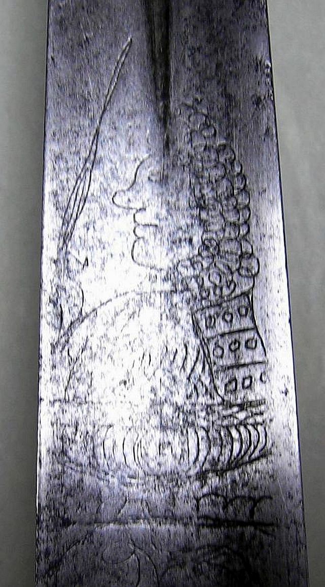

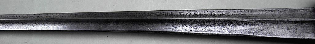

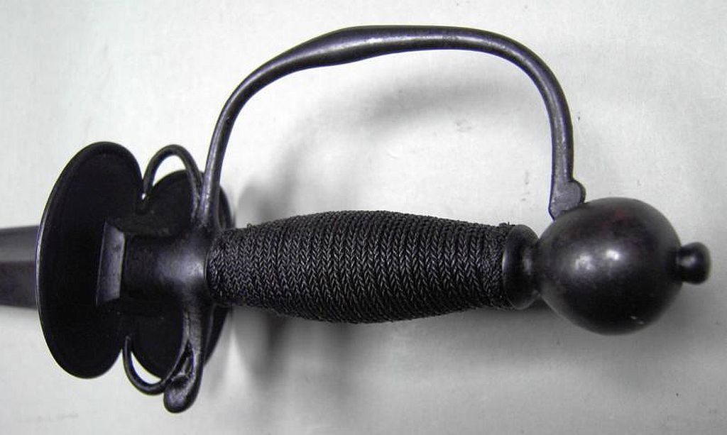

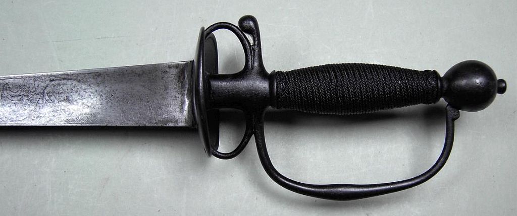

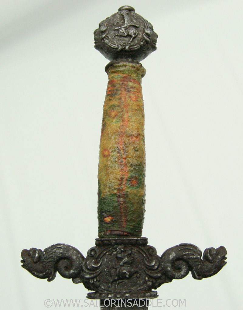

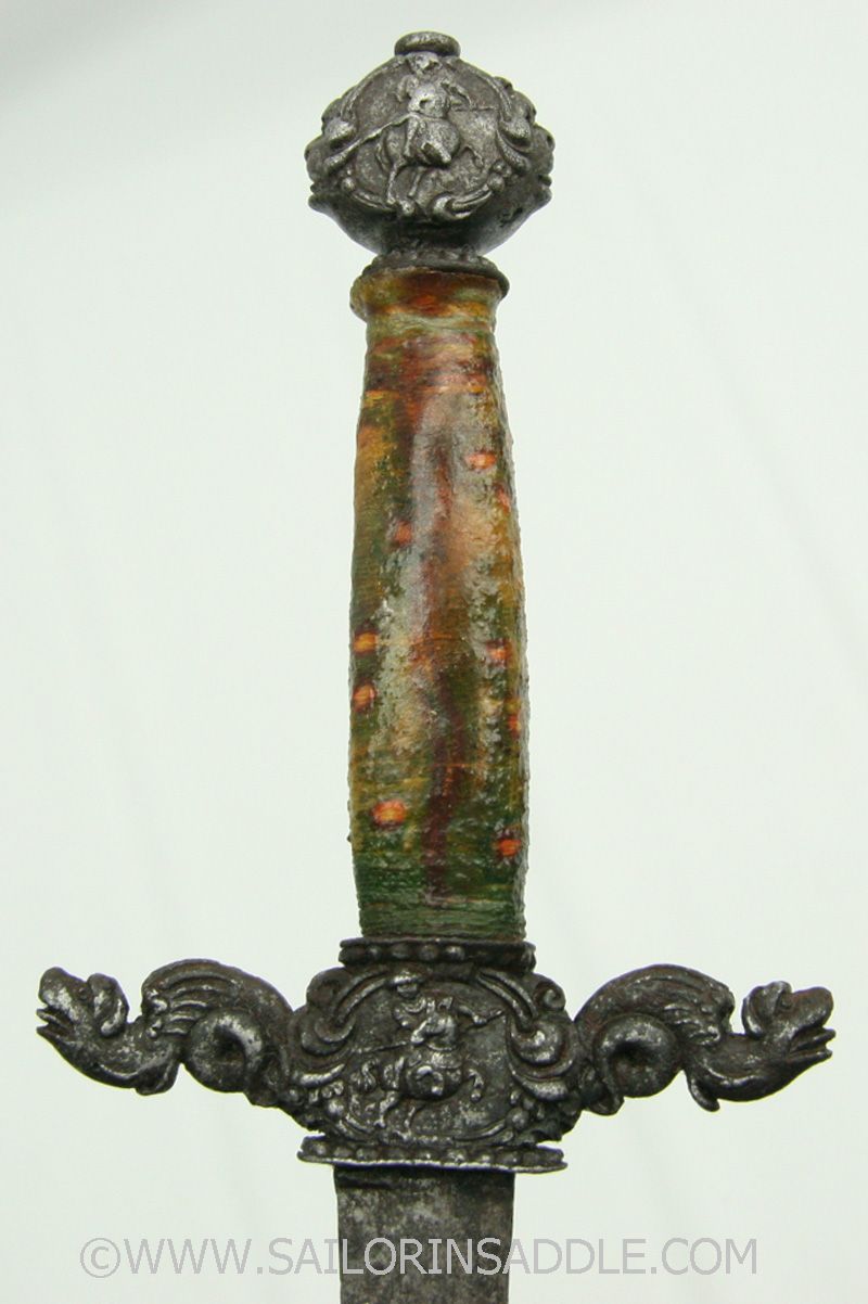

Here's a sword from my collection, ca.1660, that would be called a pillow sword by some, or a town sword my yours truly.
Sword is feather-weight. Even in this condition one can see that the quality of the cast and hand-chased steel hilt is quite good. Blade is inscribed on both sides, one side worn more than the other. It reads something like NULLA LA ...BELLO. Blade is 69.5 cm.

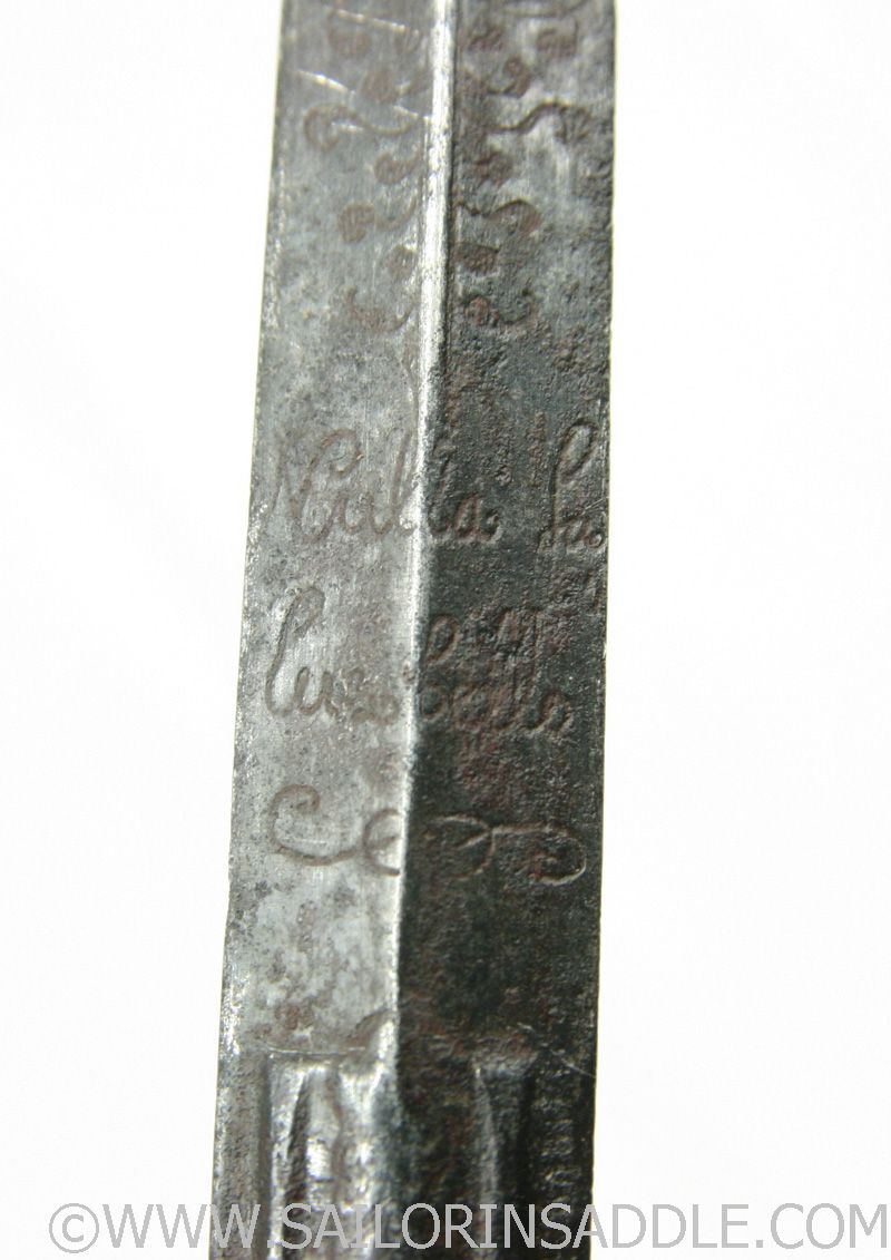

Any help with reading the inscription would be greatly appreciated, of course.
Thanks for that valuable information, Dmitry. I assumed the blackened forms represented the death of the one whose funeral it was. Does anyone have a picture of a so-called mourning sword, or is this title just a misnomer?
BTW, very nice town sword! I especially love the crossguard, with its Dutch designs...

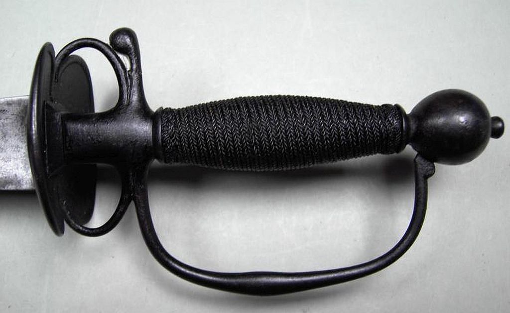

This is what a japanned small-sword hilt looks like. It's a French sergeants hanger from the mid-1700s.
No officer or otherwise a person of means would have a sword like this, as Jim writes, the darkened appearance of the hilt was done by other, way more expensive means than the asphaltum-based paint [i.e. japanning] - blueing and russeting.

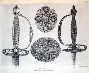

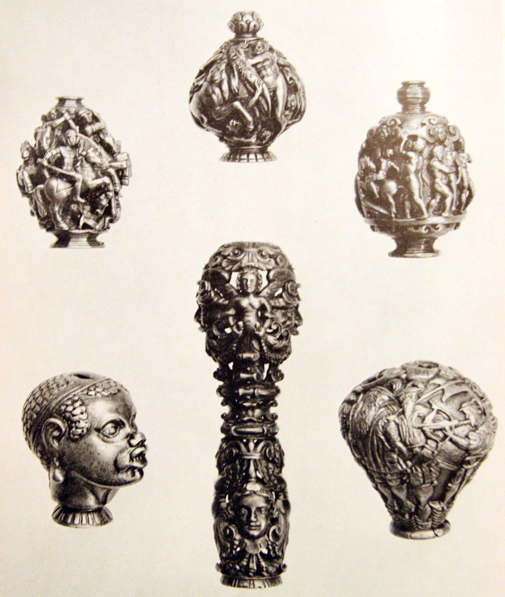

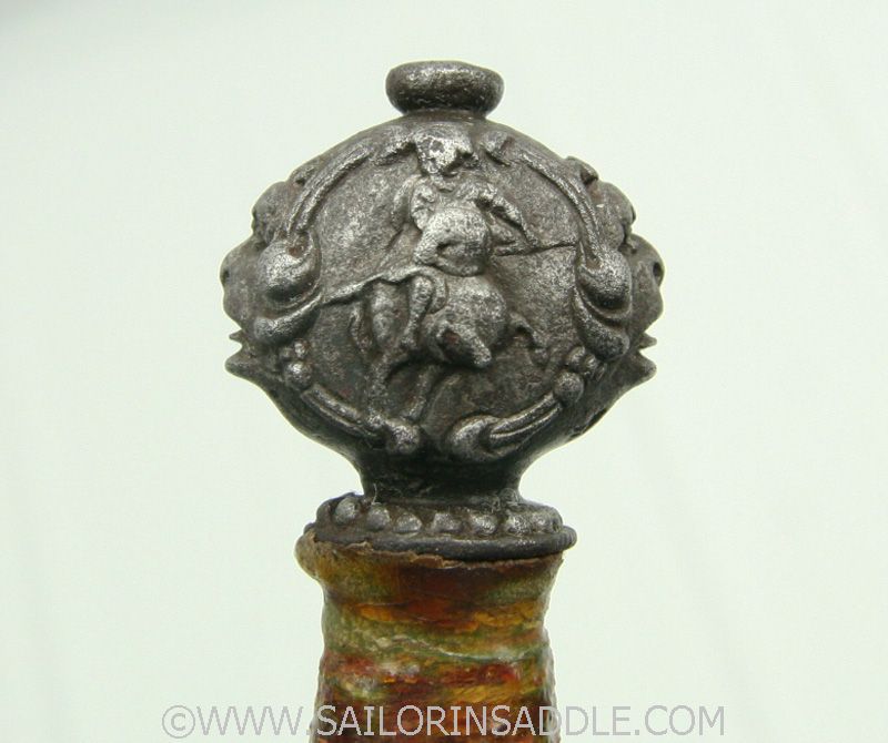

Here are some chiseled steel pommels from around the same time< or just a tad earlier, than the one on my town-sword. Some of them are classified as French.

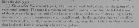

Jut to awaken the "pillow sword" nomenclature, Claude Blaire in his European and American Arms" put the term to rest [no pun intended].

Outstanding Dmitry! and thank you for the great illustrations as well. The information you and Mark have presented on japanning really puts that in perspective, and this on the 'pillow sword' term is great information.
It's amazing how literary notes can become collectors terms, and I found some other material that the the late Mr. Blair likely had at hand also from Aylward (1945). Here Aylward describes a 1748 reference by Smollett, citing an earlier tale of men giving up the habit of putting thier swords by the pillow (headboard) at night.
The late AVB Norman noted similar references but added the note on 'scarf sword' (p.184) which you noted earlier. On the same page Norman cited a 1970 reference from RBF van der Sloot who states that c.1655 these swords were called 'walking swords'....which nicely concurs with the 'town sword' term you have considered for these light self defense swords.

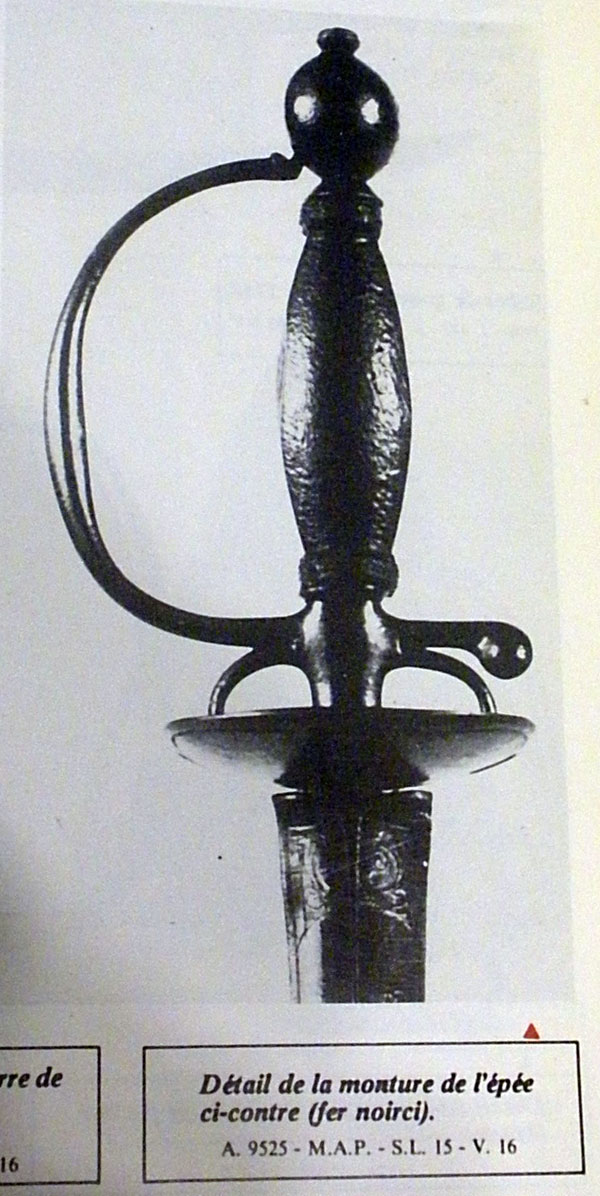

Old 15th August 2010, 02:28 PM   #19
Posts: 10,872
The 'mourning sword' topic has continued to really intrigue me, and Marks question about functionality or simply dress on these led to trying to discover more.
In extracts from "Mourning Dress: A Costume and Social History". Lou Taylor , 1983, I found that mourning was not simply a brief event and attending of a funeral, but a protracted, expensive and very status oriented affair. This was particularly the case in the 17th century, and a person had virtually all elements of somber clothing and in mens case, accoutrements, specially in place for these sometimes long occasions. From what I have understood, depending on the protocol or etiquette according to the stature of the deceased, this could be weeks or even months.
In mens fashion of the times, it was unthought of in the 17th and 18th centuries for a man to go unarmed without his sword, and while this was decidedly a matter of fashion, it was clearly a matter of a very real potential for need of self defense. In a bit of my own speculation, in the case of mourning, such a drawn out affair in which a person was clearly visible with respect to the matter, it would seem that a man would be in a sensitive situation. Perhaps a misplaced remark or slight toward the person being mourned might lead to altercation, and an effective weapon would be far more than just a dress affectation.
While it seems that many smallswords of the 18th century were fashioned with 'blackened steel', as noted in Bashford Dean's "Catalog of European Court Swords and Hunting Swords" (1929), there was only one listed specifically as a 'mourning sword'....#105, English, 1805. There were no particular details, but it appeared mostly of the cut steel fashion of the times. (attached below, left)
It was noted in the previous work mentioned that along with a mans cloak for mourning and other somber clothing in black, black sword 'covers' and belts were purchased during the 17th into early 18th century. As the 18th century progressed, the strict elements of the mourning seem to have gradually relaxed, and eventually a black armband became widely accepted for men, while the women still followed more strictly somber fashion in dress.
George Washington, whose mourning sword was earlier mentioned as such, apparantly wore his to funerals, and was worn by him in Stuarts full length portrait of him. It was referred to as his 'Spanish Dress sword' and on its blade was 'recte face ice' (do what is right) and obverse , 'nemine timens' (fear no man). It would seem reflective of the standards of mourning in place even in high station by the 1790s, and that 'mourning' swords were by this time simply dress swords, with the term used more traditionally. (attached below, right).
I have seen very light dress swords of the mid to later 19th century from Europe which were termed 'coffin carriers swords', and seem to have had blackened steel hilts of simple hanger style. These are believed to have come from a royal house, but details are unclear, and just seemed worthy of note.

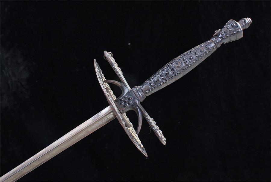

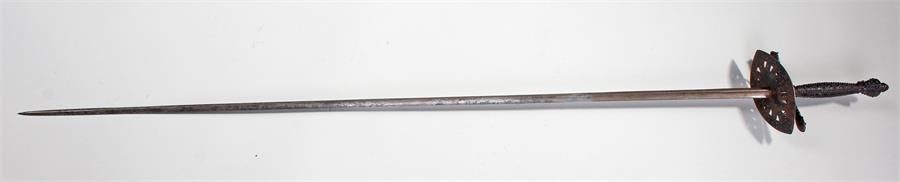

stumbled on this thread while researching. thought i'd post a photo or two of my cut steel grip mourning sword. it was listed as 19c when i got it, but it appears from the above discusiion it may be earlier. 95cm blade, appears to once have had a chain from the guard to the pommel in lieu of a knuckle bow. sadly no scabbard. i gather the black finish was rather polished to reflect from the steel bobbles jewel-like rather than a dull matte finish.

I red these posts with great attention because I have in my collection a small sword totally blackened and I didn't know what could have been the reason for this surface treating. On the blade there is a portrait or perhaps a caricature of a person whose meaning is also unknown to me. The sword has a length of 880mm and a total weight of 295g what is very light.
It could be French as well as English.
Thanks for comments
