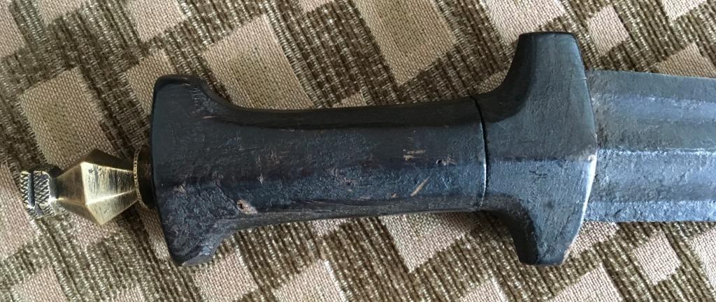

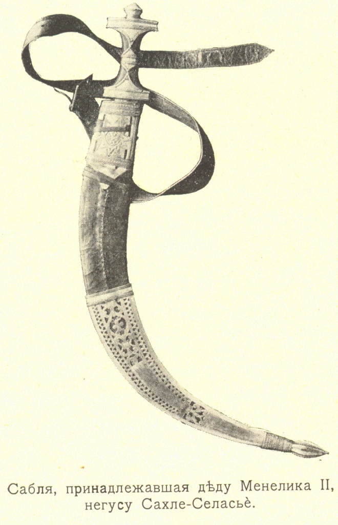

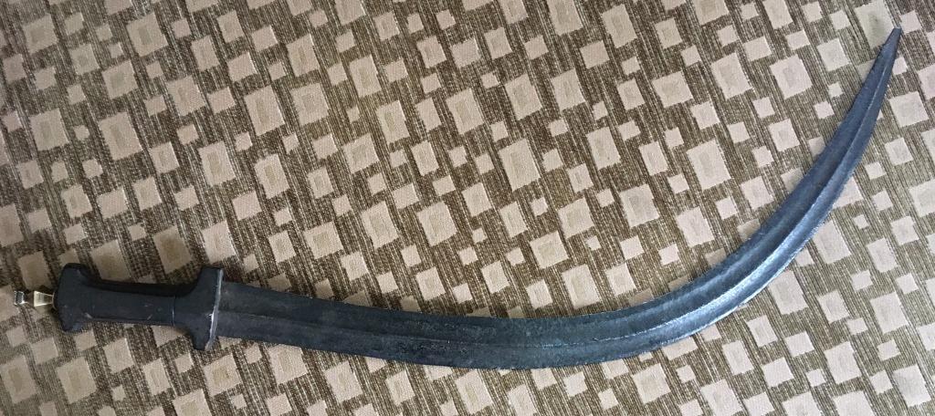

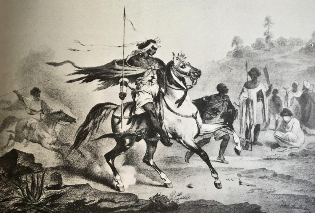

I have never seen this kind of Abyssinian sabre in "photographs with people". I would say it is neither gurade, nor shotel. It is much shorter (the example in the picture is 68 cms long) and also notably heavier (thick blade)and the pommel has always this particular shape. My idea is - either old type which was not photographed too much, or comming from the south (like Sidamo area). I am also enclosing the old pictures of the short sabre of the King Sahle Selassie and one old engraving of Abyssinian cavalryman with similar short sabre.

The problem is that the evidence is a sketch thus up to the artist what he presented... in this case a possible Shotel either badly drawn with the forte missing ..or is this the result of a snapped sword redesigned more as a long dagger? The blade on the exhibit could be a straight Solingen ...imported then bent into a curve.

The problem is that the evidence is a sketch thus up to the artist what he presented... in this case a possible Shotel either badly drawn with the forte missing ..or is this the result of a snapped sword redesigned more as a long dagger? The blade on the exhibit could be a straight Solingen ...imported then bent into a curve. Please see below and where I couldnt get a print simply place the string into search
That would require re-tempering the blade and is utterly inconsistent with the characteristics of the blade.
This blade was obviously forged in the shape seen here. A lovely piece Martin, I agree this seems to be part of a subset of shorter curved blades. I find the thickness of the blade quite attractive an obviously well made and old item. The sketch of the king's sword seems to follow a similar profile, a pity the blade is not seen in the illustration.

Ibrahiim, thank you for the first reaction. What I am 100 % sure: The blade is local, not imported, not made of snapped shotel. It is short, but classical stabbing with it is not too much practical due to its curvature. Except of one case: "to stab from behind". Because of its weight, I think, it is fatal slashing weapon. I already saw more sabres like this. (- as far as the design they are muchness and the length varries +- 5 cms)

Yes, I know classical shotels. Nevertheless their blade is always lighter, flatter and still (enerally) longer. There is also always difference it the hilt and style of pommel ...

This is very interesting Martin, On looking carefully at the sketch I note all three men in front are wearing a weapon like this. Perhaps this is an entirely new weapon?

This is very interesting Martin, On looking carefully at the sketch I note all three men in front are wearing a weapon like this. Perhaps this is an entirely new weapon? On the other hand ~ It is interesting trying to fathom how this was used except for the fact it looks vicious and it could be stuck into someone...it seems over curved... but on looking at related battle fields was this a special weapon to hamstring horses...? see http://www.victorianmilitarysociety....e-19th-century

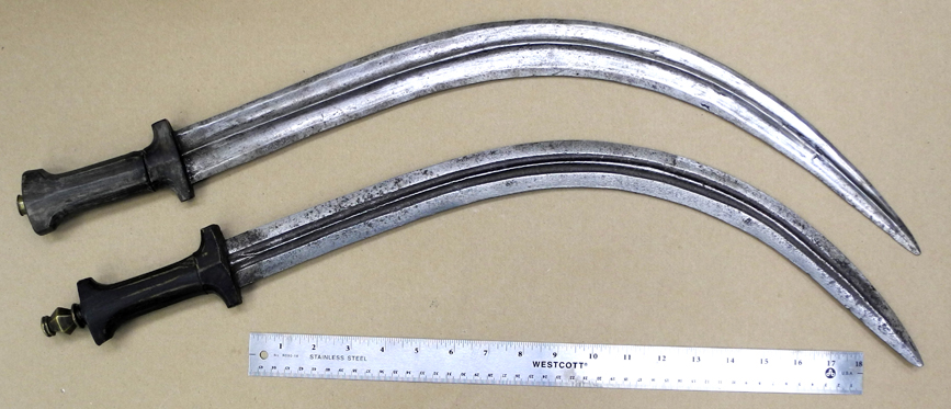

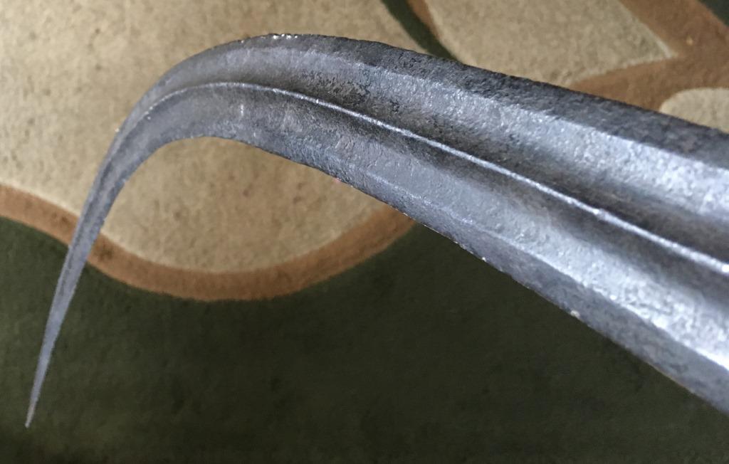

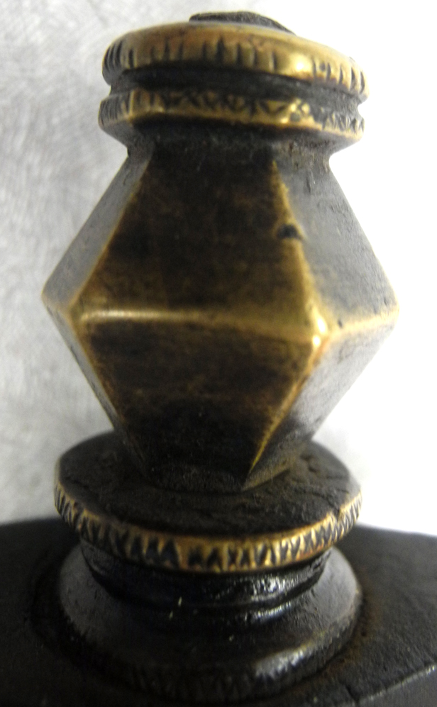

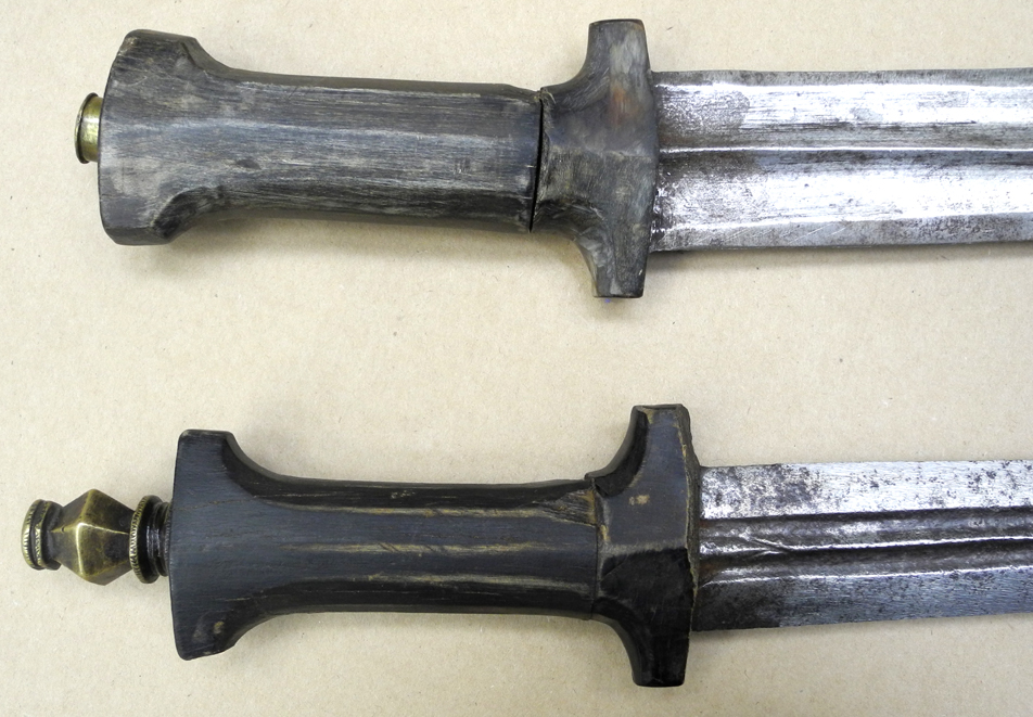

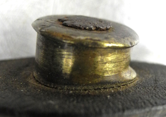

I have two similar swords in my collection. Both are quite heavy. Locally made and not re-worked from shortened blades. Fortes are missing from most of locally made shotels. Lengths of the blades (straight line from tip to handle) are 20" and 21.5". One of the pommels is typical, while the other one appears to be the head of a black powder cartridge, maybe a French Gras. Though these swords are Abyssinian, I have no idea which ethnic group they are related to. Galla? Oromo? I doubt they would be from the low lands and desert areas (Danakil, Afar).
Cheers.
Very interesting to note that Fortes are missing on locally made blades...That would point to these daggers being local and probably spun off from the design of the Shotel. I was about to spout off about Danekil, Afar daggers though they are noted as lighter and a slightly different shape...I cannot make out the brass cartridge case type ~ maybe the French though there a few possibilities and any of the likely suspects would perhaps be used..

Posts: 10,851
Excellent points! no forte on locally made blades! That one I completely forgot, and is a great indicator. It always amazes me that it seems so commonly held that native makers were producers of crudely made blades, at least to those relatively uninitiated in ethnographic weapons.
It is always interesting as well to see the notion that certain swords or types of weapons were restricted to certain tribes or groups, as well as to certain geographic regions. As Kubur has noted, influences and features of various weapons are often amalgamated into what frustrated collectors often regard as variants.
While obviously we can largely classify certain forms to the regions where they have propensity, however movements of ethic groups through diaphanous borders which are the thing of maps remind me of the sage axiom. .... "weapons have no geographic borders".
Roanoa, as always, your insight into the weaponry of these regions is great as you have been key in the study of this field for so many years.
Interesting use of what may be a cartridge when the use of coins have always seemed to dominate this place on hilts of these regions.

Thank you Roanoa for the additional pictures. I will investigate a little bit re. the origin. Till now I was of the opinnion that Galla was old name for Oromo ?

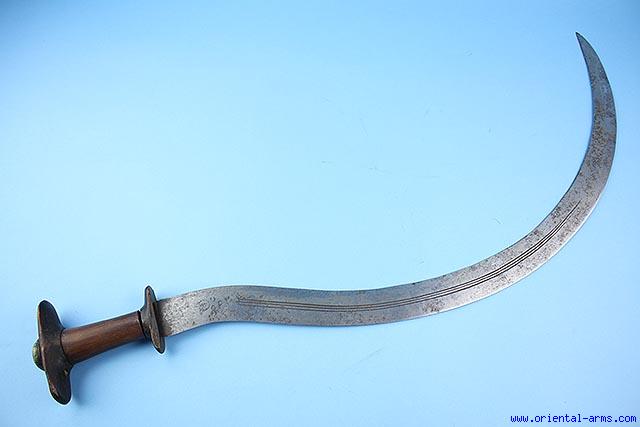

Another sketch perhaps offering a clue...
see https://www.shutterstock.com/image-p...reatd-76884388
