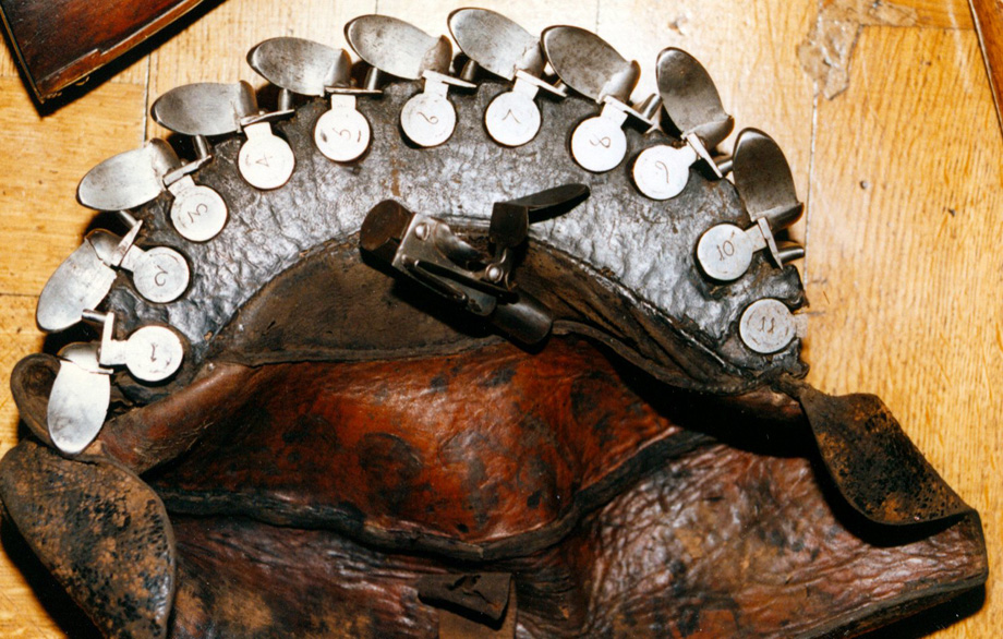

Richard,
No one could be any happier than myself about your shedding new light on one of my older posts (I joined the forum only two months ago).
Actually, the bolt action breech loading system has been employed with wheel-locks at least from 1540.

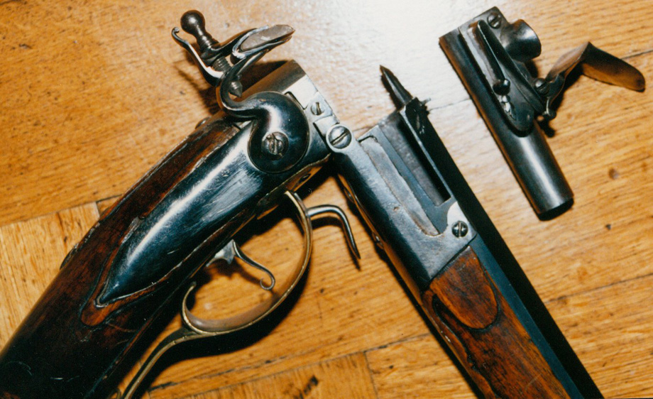

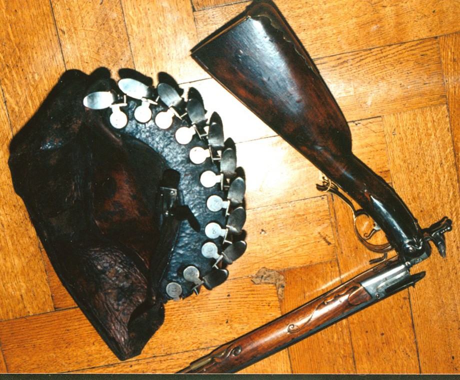

I attach some images of a combined snap tinder lock and self spanning wheel-lock breech loading harquebus (the snap tinder holder and iron "cartridge" now missing), the barrel bearing the double falchion mark of Christoph Arnold, Augsburg, ca. 1540 (an almost identical piece in the collection of Schloss Grunewald near Berlin bears the same marks together with the date 1540), and a short wheel-lock breech loading harquebus or pistol by the same maker and of identical date. I got allowed to take the photos of the latter in the Imperial Vienna collection 20 years ago. Its exceptionally fine condition strikingly illustrates the original impact of contrasting colored surfaces in those mid 16th century pieces!
You are doubtlessly right in assuming that such a costly and refined system would only have made sense if used together with pre loaded and readily primed interchangeable iron "cartridges". Only in wheel-locks the pan was an integral part of the lock and had to be primed manually prior to each shot.
Interchangeable breech loading with cannon was in use since at least mid 15th century. It took some time to get applied to harquebuses, though.
We know of some very rare breech loading break down action flintlock guns of early to mid 18th century date whose sets of spare cartridges are still contained in a leather collar, each of them equipped with its own frizzen and pan - perfectly ready and primed!

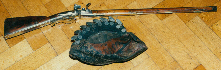

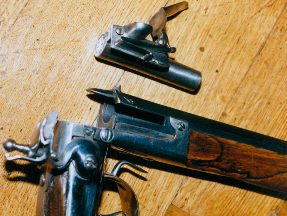

I enclose some views of one rare sample of such a rifle, ca. 1700 but re-stocked in mid 18th century, together with its original cartridge collar containing 11 numbered and rifled (!!!) iron cartridges, with number 12 inserted in the breech. I was granted to take the pictures in the reserve collection of the Princes of Thurn & Taxis, Regensburg/Bavaria, 26 years ago.
In all probability, mid 16th century "cartridge" containers for breech loaders looked very much the same.
Great mind job, buddy - and thanks for inspiring me to post the following attachments!

The extremely fine and perfectly preserved Vienna breech loading wheel-lock pistol, like the harquebus posted above made by Simon Arnold, Augsburg, ca. 1540.

And the ca. 1700 Thurn & Taxis flintlock rifle, re-stocked in the mid 18 th century, together with its original leather collar containing 11 numbered rifled (!) cartridges - with number 12 inserted in the breech.

Michael,
The piece by Christof Arnold shows Solomon was quite right............" There is nothing new, under the sun..."
It seems this very modern action was used with very little alteration (except putting hinge on other side) by Jacob Snider, to convert muzzleloading P '53 Enfields to breech-loading in 1860's.
Does pushing back on the tunnel sight withdraw a bolt which passes forward into the breech-block?
For some time, I've wanted to make a wheellock mechanism, and a self-spanning one would be very interesting!
Re. the snap tinder lock;
What was the tinder made from?
I know hemp was used when attainable as slow-match, but do not recall hearing what "tinder" was used in the snap-lock.
The pistol you show above, is one of the very best I have ever seen, and the file-work is beautifully executed! a very crisp and stunning example.
On this arm, I can clearly see the bolt which engages the breech-block.
Re. the flint-lock,
What a headache it must have been! ...making each cartridge with exactly the same geometry so each frizzen would spark well! It was a long way ahead of it's time!!
Thank you again for the marvelous pics!!
Richard.

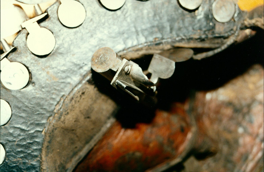

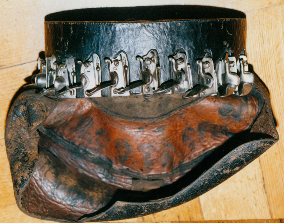

Default Snap tinder locks
Richard,
Here are some historical early 15th (the b/w one dated 1411) and early 16th century illustrations showing the use of pieces of tinder in snap locks - and sometimes the thick matchcord employed to light them.
I posted some these before in my thread on the Battle of Pavia, 1525.
In some of the illustrations you can clearly see that the matchholders' heads are way too small to take the thick matchcord wrapped around either the guns or the harquebusiers' arms.

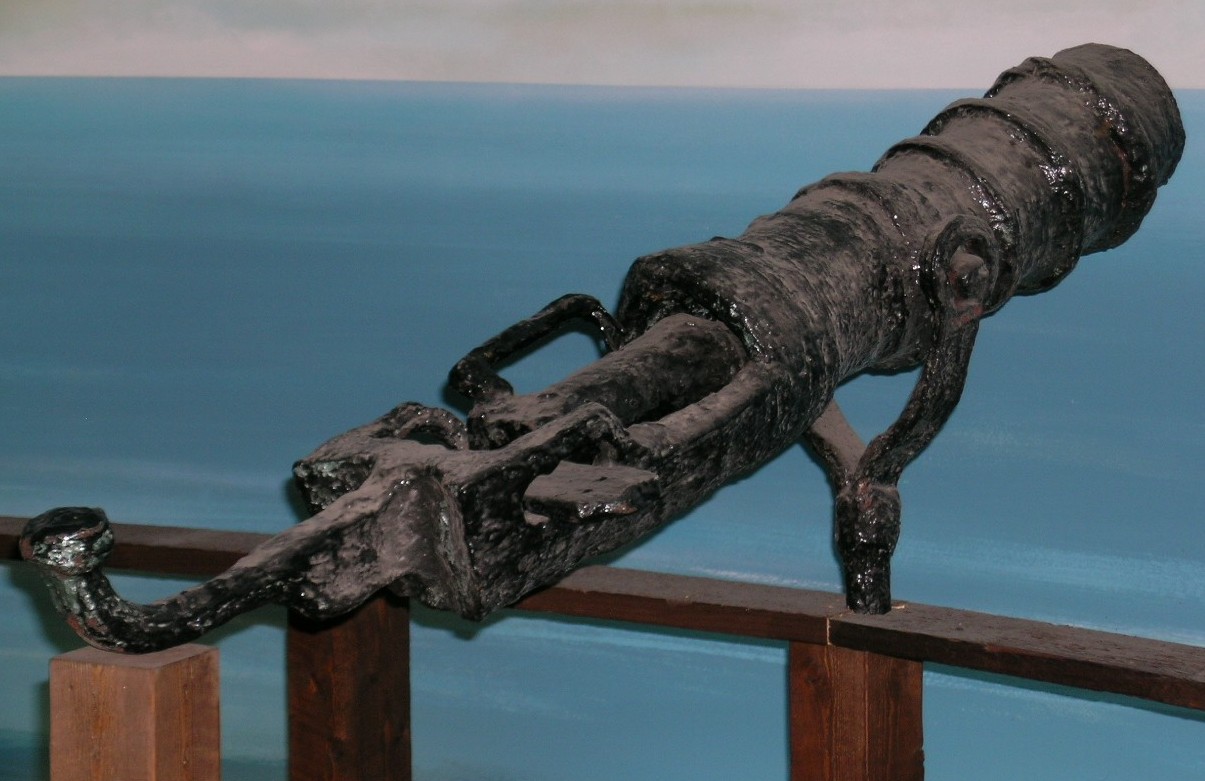

very interesting thread, thank you. I especialy liked the gun & bandoleer combo on #7.
Here is my contribution to the subject: a breech loading swivel cannon, found in very shallow waters off the coast of Israel, south to the city of Haifa, north to Caserea Maritima. Probably a relic from slave/pirate galley, as at that time - 15th century, there was very little buisness for merchant vessels to do there. Interestingly enough, found with the breech, swivel and breech-locking bar. The barrel used to be 30% longer but only the front rings survived (not shown). It is on display in the National Maritime Museum in Haifa. I will be able to bring measurements sometimes later.
Old 26th November 2008, 11:55 AM   #19
Matchlock
Matchlock's Avatar
Join Date: Sep 2008
Posts: 4,310
Very nice 15th century naval breech loading cannon indeed - thank you, broadaxe!

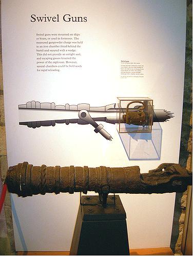

At the Tower of London.

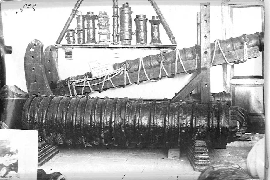

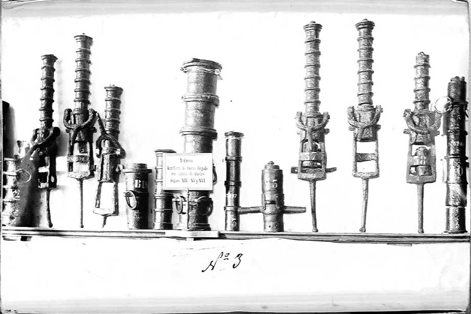

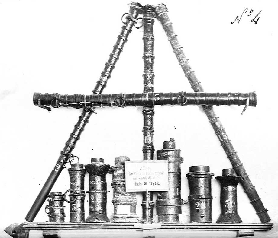

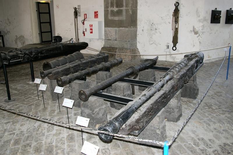

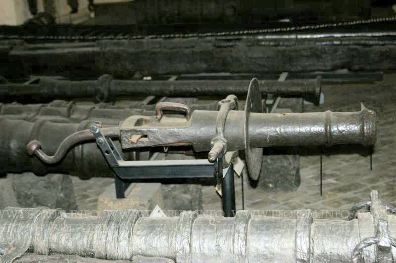

Default 15th Century Breech Loading Cannon at the Museo d'Artilleria, Madrid
Only these b/w photos available, taken as early as 1883 .

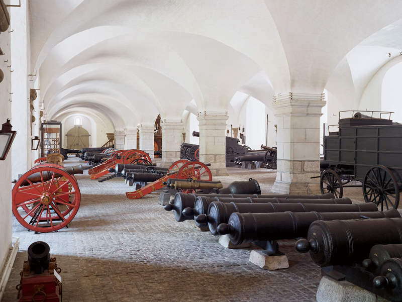

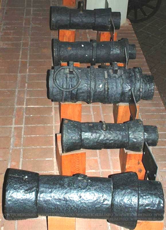

Posts: 4,310

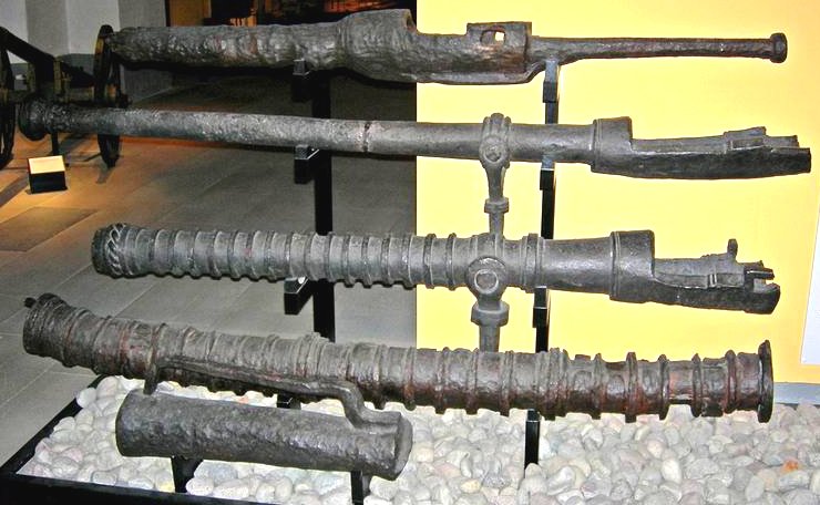

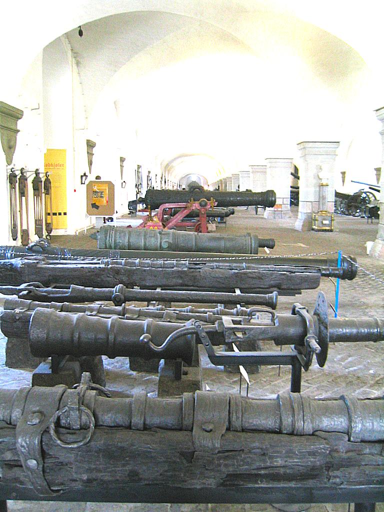

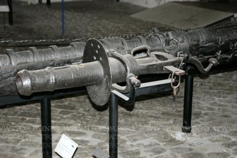

15th century breeches and cannon at the Tojhusmuseet Copenhagen.

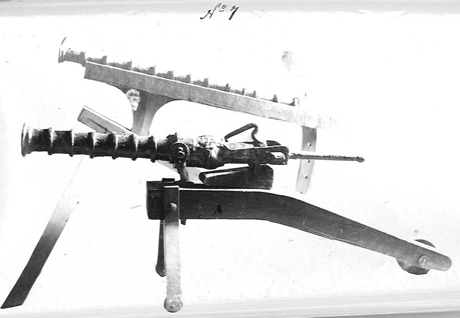

Lately I was lucky enough to find an old b&w photo of the very same cannon on post #18; on the day it was found (1978) with the underwater debris intact.
Old 8th July 2009, 02:23 PM   #29
Matchlock
Matchlock's Avatar
Join Date: Sep 2008
Posts: 4,310
Hi broadaxe,
Thanks for that perfectly documentary contribution!
