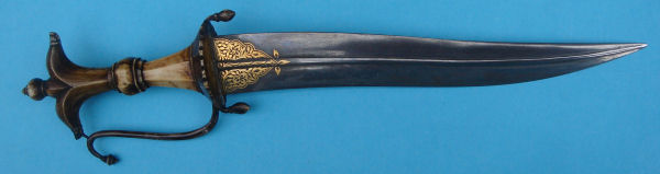

Helly everybody,
I'd like to buy these two chilanums/indian daggers
but a friend told me to be careful : maybe two more replicas
the sellers, specialised in knifes tell me they are authentics no fakes ,
not so old maybe early 20th century.
Not too expensive so...and with indians weapons we have so often replicas with fake damas blade...
the first chilanum told to be with bone hilt + wootz damas blade.
The second authentic too : but the koftgari and the scabbard seems too
recents!!!...
Whath do you think ?
Kind regards

Very hard to say from the photos you posted.
The koftgary is definitely recent but the dagger can be older... much older. It is a rather frequent practice to apply koftgari on antique but otherwise mundane knives to make them more saleable. But then again, this looks to be genuine koftgari, and well made. So I don't think being recent makes it less genuine/valuable.
Other than that, the example looks good and made in the traditional way. The chiseld blade is almost unseen in recent production. So I don't think it is a fake. Early 20th century seems plausible to me albeit the blade can be significanly older.
Would definitely like it for my collection.
The recent scabbard has absolutely no relevance for assesing the blade but it is a nice extra.
PS: I managed to download and open the pdf file. Now that appears to be a recent dagger with a pattern welded and NOT WOOTZ blade. So, if the seller lies about this, ho much can you trust the rest? But then maybe I am wrong ...

Hello Marius,
thank you,
I'll look about what you call ''pattern welded''
here another picture given by the seller of the ''pdf'' dagger- chilanum,
the hilt was complete on this picture but now it's damaged a little, that's why the seller makes a low price.
Do you think it's not a bone hilt ? Maybe Ivory
or plastic ? ? !!!!! ....
