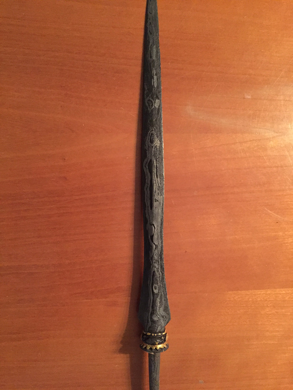

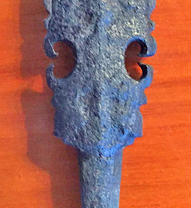

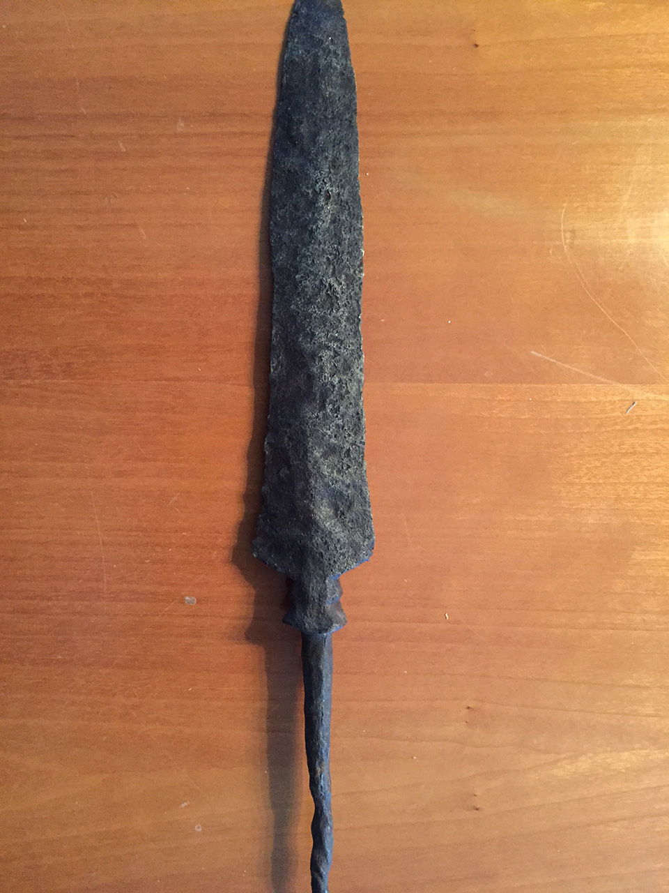

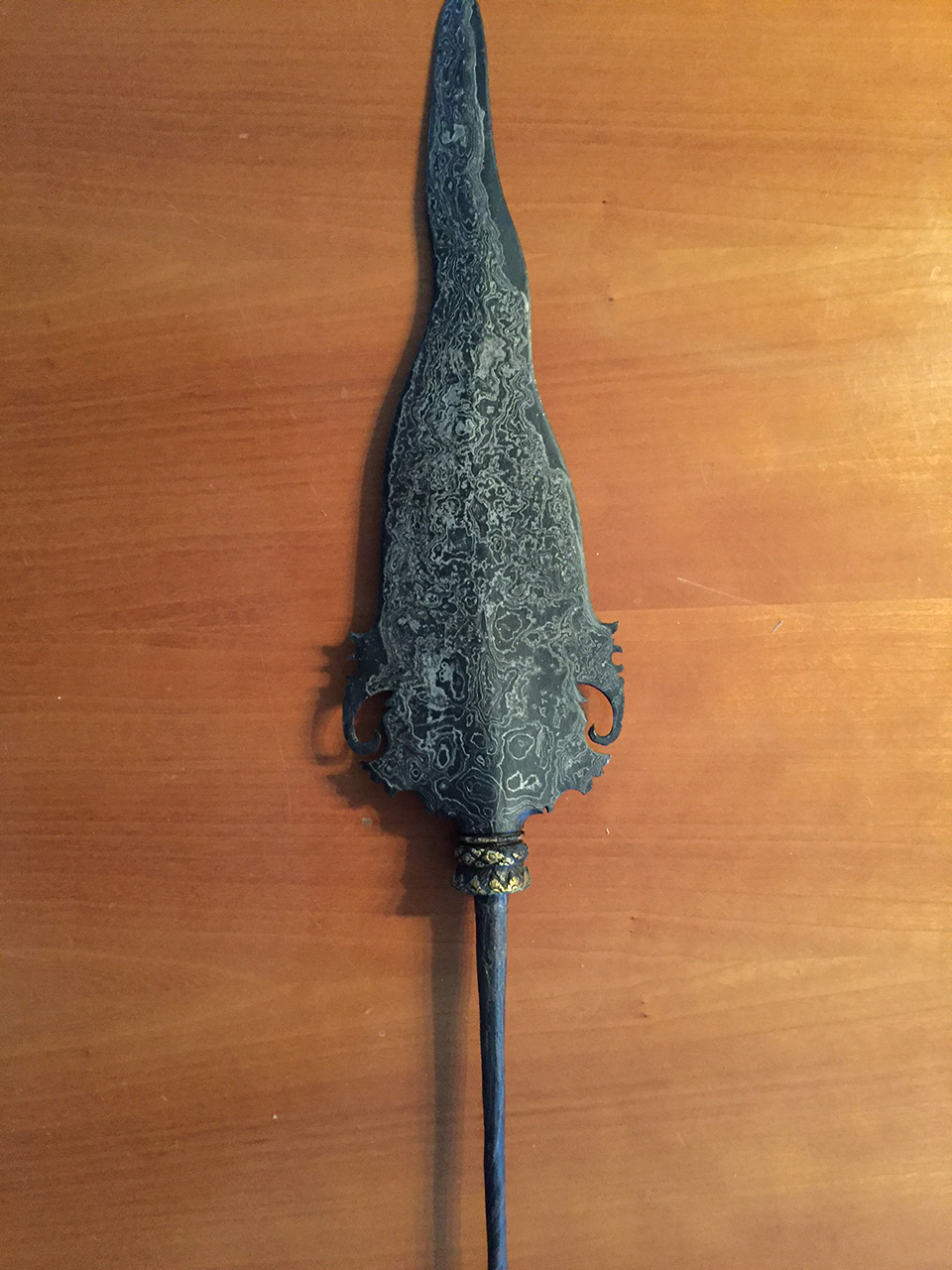

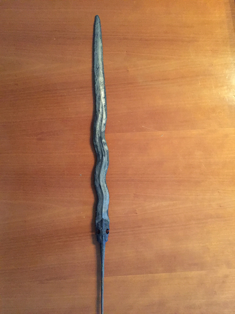

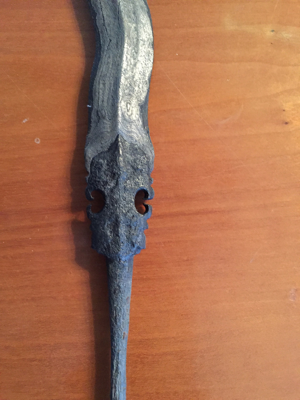

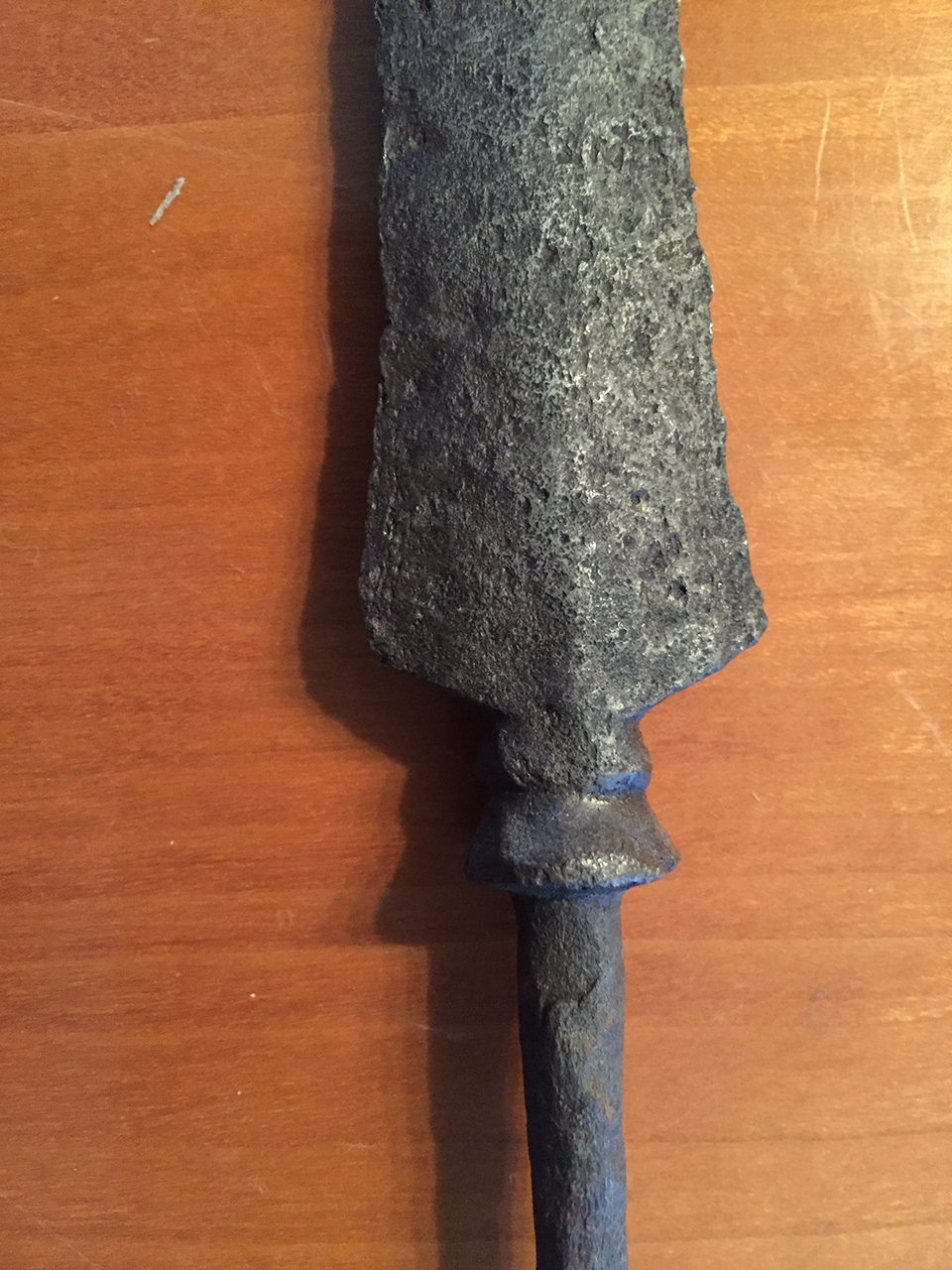

So to get this straight I've added three tombak.
One with a missing mentuk, one with a mentuk iras and one with a seperately made mentuk. Correct? Is the one with the 'missing'mentuk intended to go without?

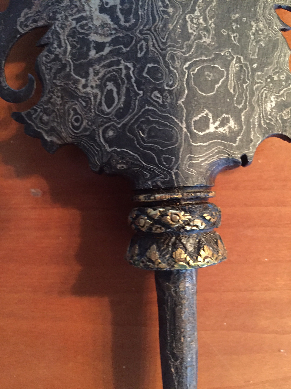

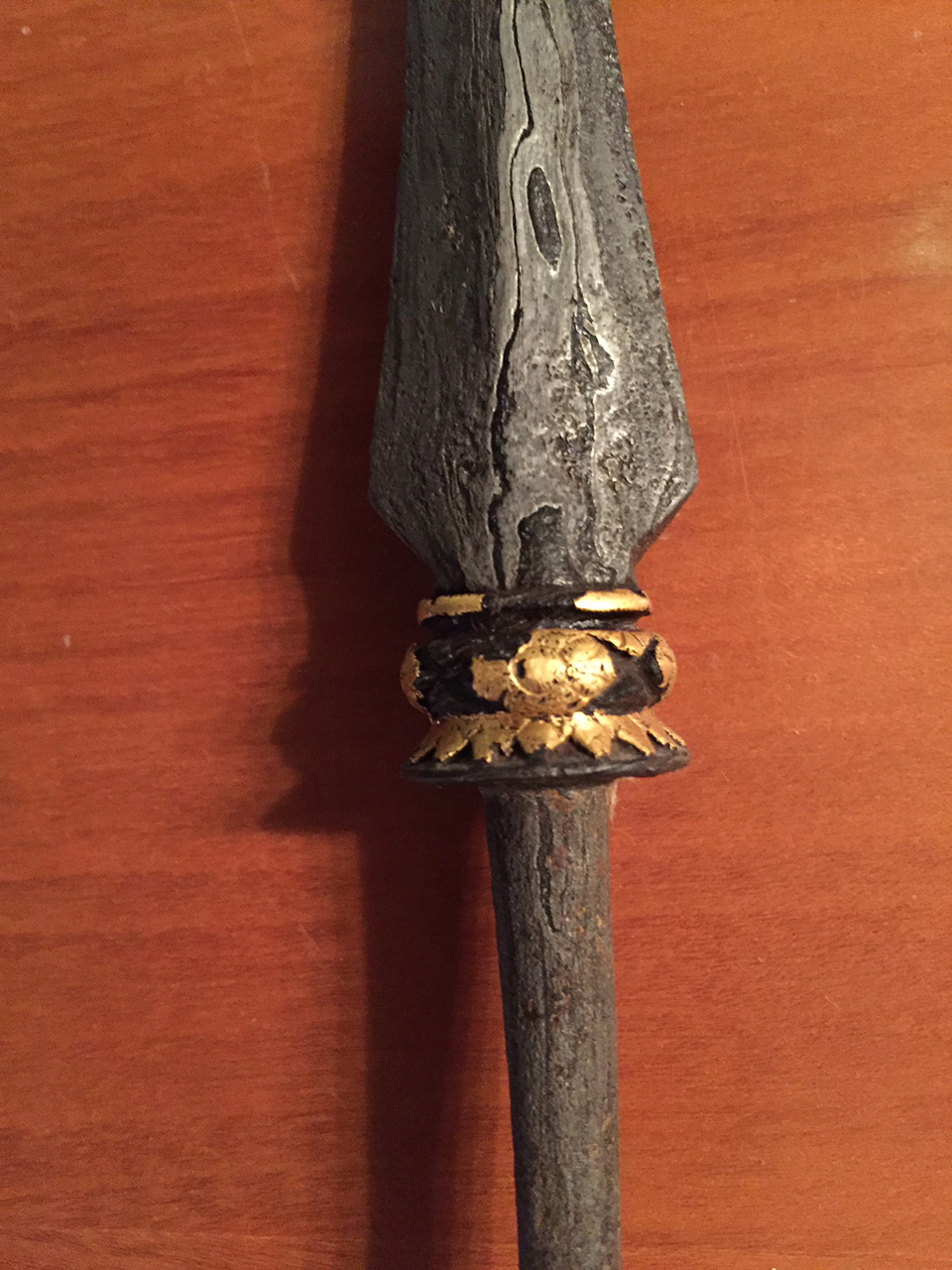

Hello K!
Regarding the tombak with kinatah, it looks like the pamor might be continuing onto the metuk - could this be iras construction, too? (The kinatah obscures the lamination a bit and closely examining this tombak should help to resolve this.)
kai is offline Report Bad Post Reply With Quote

Hi K!
Looks like it. The kinatah looks genuine. The tombak looks like a quality object. Wutuh, sepuh and maybe even a bit tanggu. If this is the case this could support the idea that there might be tombak of quality with mentuk iras. The tombak now showing has seperate metuk with the same kinatah.
Kulino is offline   Reply With Quote

Hello Kulino,
(Maybe less intricate)
The center motif seems to correspond, indeed. I'd agree that the iras metuk looks nicer than the separate one in these 2 examples (even when ignoring the kinatah).
Without wanting to hijack Paul's thread - great to see some tombak here for a change!

I believed the or the main reason for keris gonjo iras of decent quality was to counter magick against the wearer of such keris. Granted, there are many gonjo iras blades which fall way short of any kratons' standards; however, there are also heaps of keris with separate gonjo that are of low level quality.
I'd have expected pusaka tombak to follow the same basic symbolism as keris (originally linga/yoni, etc.) with possibly the same, rare exceptions to the rule (i. e. usually with separate metuk but a few quality examples with metuk gonjo iras). Out on the left field on this one?
