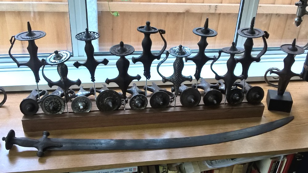

There are literally dozen of Tulwar handles on e-bay: day in and day out.
All look old, most are simple, but quite a few have traces of silvery decoration.
About a third of them have no saucer-like pommel.
This epidemics started about 3-4 years ago and is not abating.
I am wondering: where are the blades? What is the reason for such an abundance of old handles? Why no pommels?
Any inside information or just a supposition?
Thanks for enlightening me.
