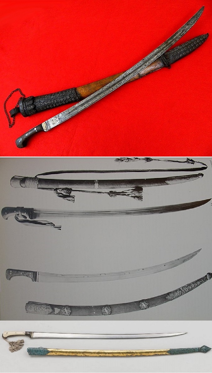

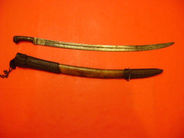

Just received it 3 days ago and would like to show it around.
This is what we conveniently called " Bukharan shashka", even though it is not a shashka, and may be not from Bukhara, but from Khiva, Samarkand, or even what is now Afghanistan.

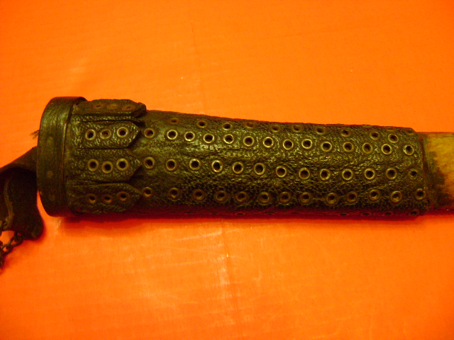

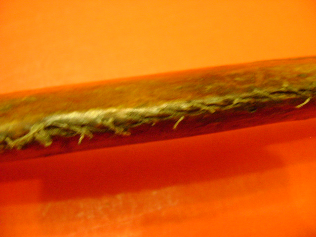

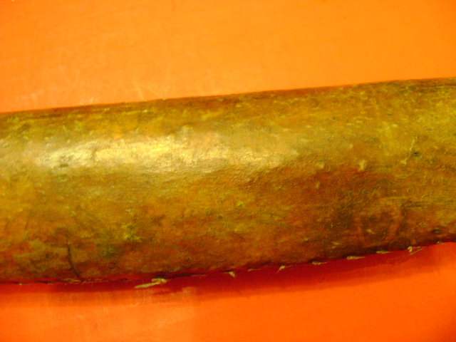

What is great about it, is that it is largely intact, with only some very old repairs to the wooden handle. The scabbard has an unusual covering: both throat and chape are made of leather decorated with "eyelets", reminiscent of the scabbards of Central Asian straight Pesh Kabz ( some call them Karud, but it is a separate story:-)). The midsection of the scabbard is tightly bound in smooth leather stitched together,
The blade looks monosteel, but I haven't had time to polish and etch it, so that's he limit of my description for now. About 3/4 of the blade decorated with incised silver.

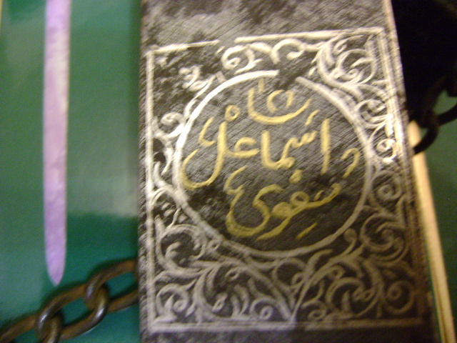

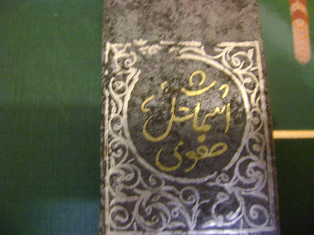

But the absolute top is the inscription ( repeated on both sides: Shah Ismail Safavi.
Well, I would love to think that this blade belonged once to Ismail I ( Khatami), the big lozer at Chaldiran, or at least to his grandson Ismail II, the mad psychopath, but.... neither of those are likely. Most likely, of course, it was a kind of dedication to one of them. However, both lived in the 16 century, so, with a lot of luck and wishful thinking, one may posit that the dedication was to the actual Big Kahoona ruling at that time :-))
I wish:-))))
Would love to hear from all of you.

This is an interesting blade and accurately translated ... Your assessment on possible birthright is also reasonable ... An excellent item.

It is a known sword, which a very long time trying to sell on e-Bay. Because of this, I had the opportunity to see the sword carefully.

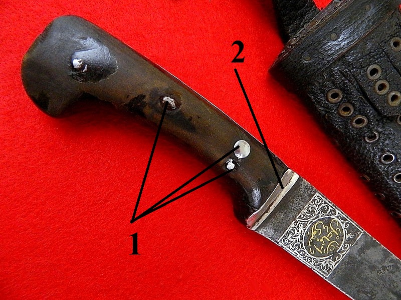

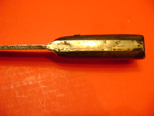

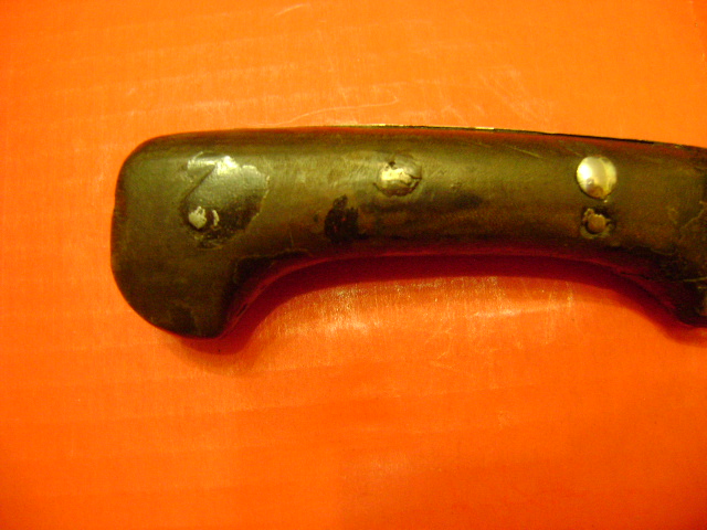

1) I see a new sloppy rivets (1) and parts bolster (2) (photo 1).

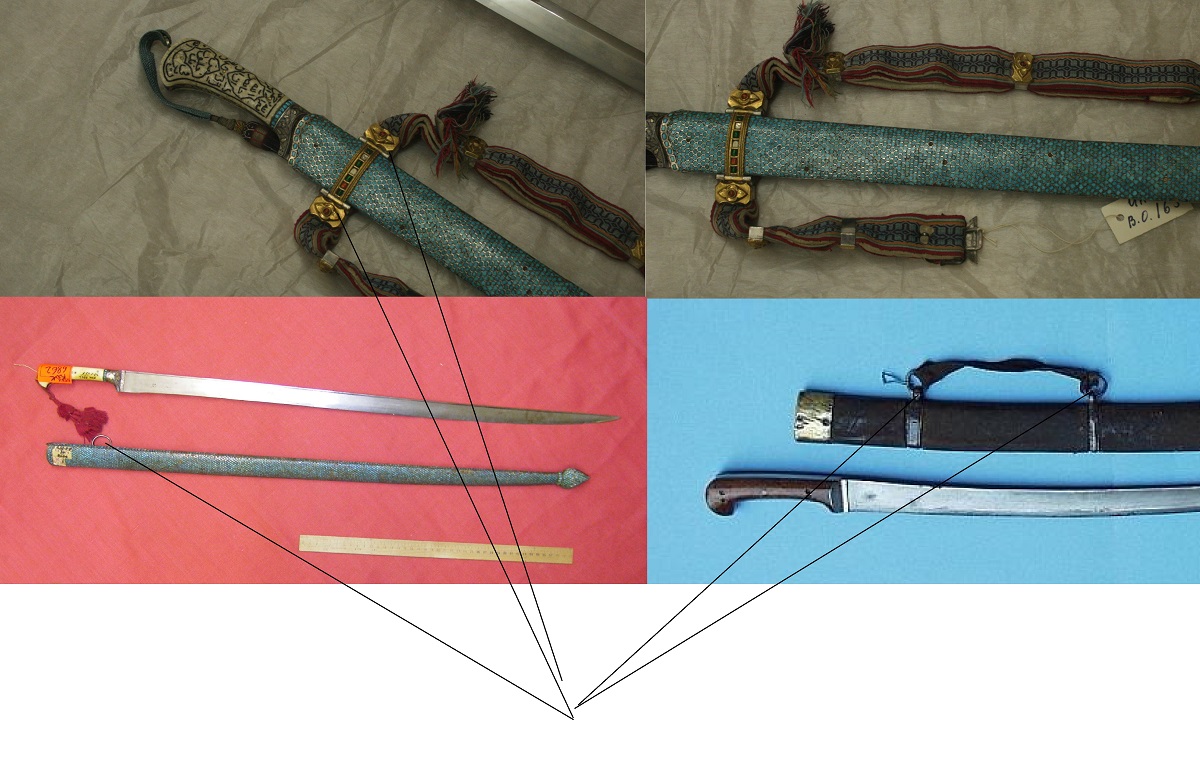

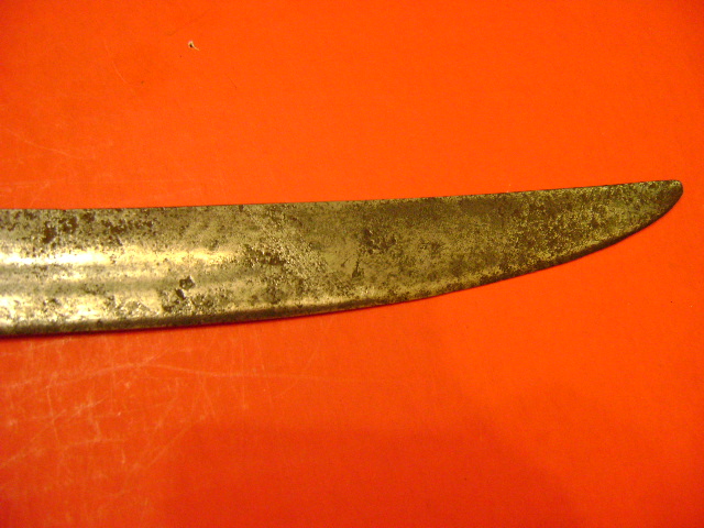

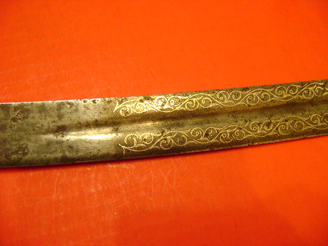

2) The shape of the blade and groove on the blade It does not look like shashkas from Bukhara (or Khiva, or Kokand). (Photo 2) But I'll be glad if someone will show me an example of a similar blade from Bukhara.

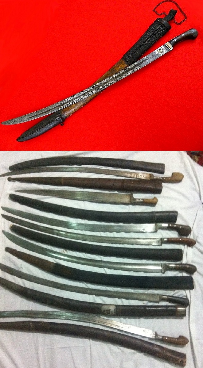

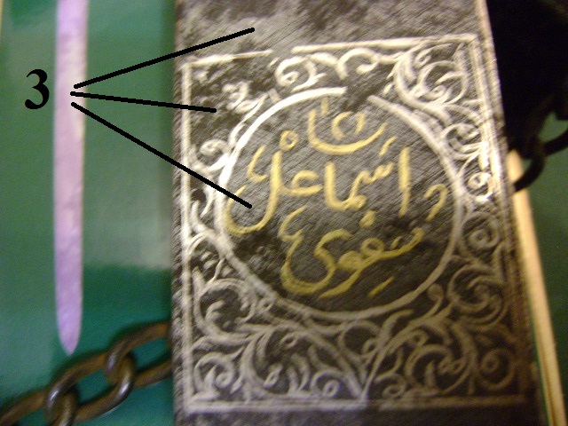

3) But this blade is similar to the blades of the Afghan shashkas of the late 19th century. (Photo 3)

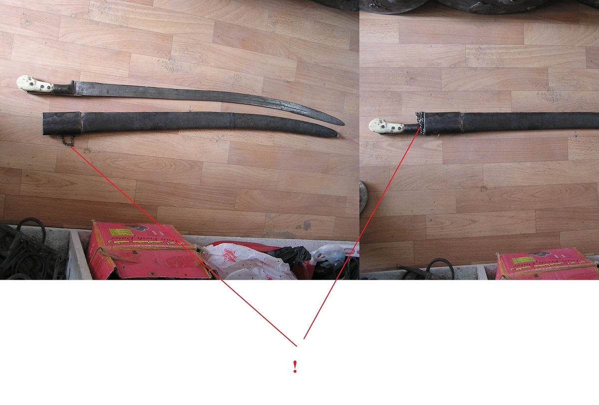

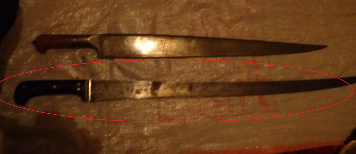

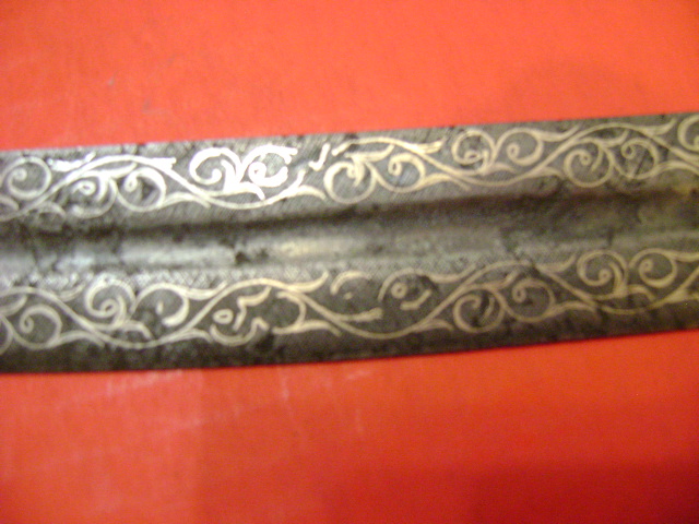

4) Now a little about decorated with "incised silver". Unfortunately I can only see "koftgari" (3) (Photo 4), this is usually the modern masters "improve" the old blades .... At real shashkas of Bukhara is it looks differently (Photos 5)
Lately, me offer many items from Kabul (Afghanistan). Among other items I was offered "Bukhara shashka". But unfortunately it was modern .... So I politely refused to do an item. The blade was no inscriptions in gold and silver (Photos 6)
So I would not hurry to congratulate ... I will be very happy if I am wrong.....

I've passed this sword by a couple of times now, passed for the very reason that I think it has been monkey'd with, being either, in the day, or for later bazaar trade (My thoughts are with the later for the hilt change). You may also recall a similar one seen here in Australia 12-18 months ago...which I thought was "more" correct ... It also had similar characteristics that distracted me.
Personally, I do think Mahratt is on point with his assessment.
I personally feel that this sword is, and always was, from the Afghan/Scind regions. See the blade type in this post;
http://www.vikingsword.com/vb/showpo...43&postcount=8
Function; is valid as a weapon. Form; not of Bukhara, much further to the south east IMHO.
Gavin

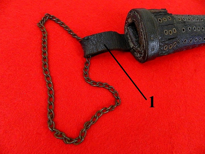

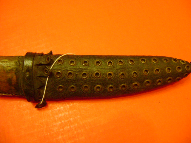

I'm sorry to disappoint the new owner of the sword. However, the scabbard of the sword can not be called a "very old". Note the leather "loop" (1), for which the scabbard should be hanging on a belt (I think it is clear that the chain - it's just a decorative element) (photo 1). Such attachment is not typical either for Central Asia (photo 2), nor for Afghanistan (photo 3). This "leather loop" - useful for a small knife, but not for a large sword ...
Although I will be glad if someone can tell me really old scabbard for the sword of the Central Asia with such a "leather loop"
Old 3rd August 2016, 05:17 AM   #10
mahratt
mahratt's Avatar
Join Date: Nov 2009
Location: Russia
Posts: 1,042
I forgot to say. "Chain" in the scabbard - this is one more "brand" of modern masters from Kabul Here we see the old Afghan shashka with new modern scabbard with a chain.
