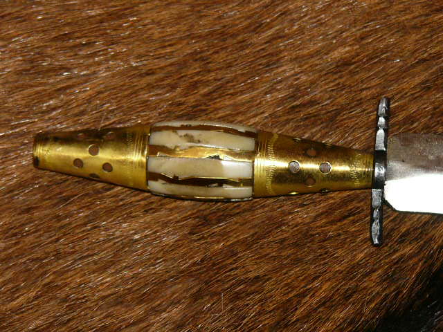

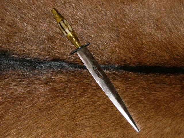

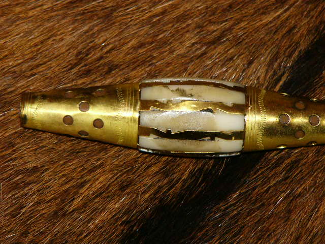

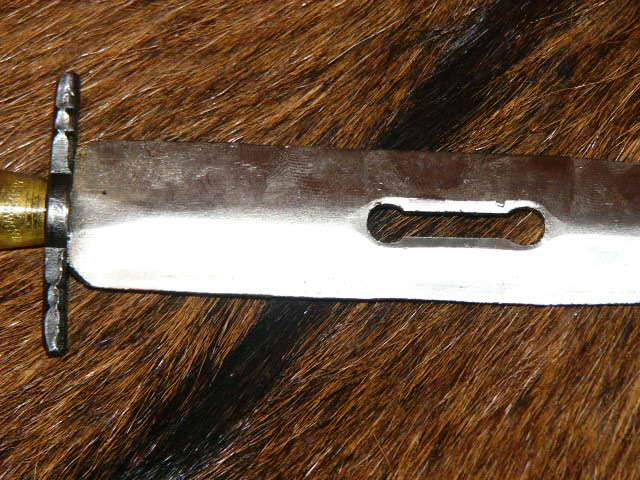

I just bought this "Castillian Dagger" in Toledo. Believe me, it was hard to find anything in Toledo that was not tourist junk. It has a Toledo mark and is dated 1870. If anyone can offe more insights, I would appreciate it.

Marcus,
That looks like it might be a modern reproduction. It is hard to see the tang stamp on the knife. Do you have a better image?

Default mark
I believe the dealer was very reputable. We talked for an hour. He knew the difference between old and new and did not misrepresent his pieces. He did tell me that he thought the inlays that look like bone were probably bakelite or some other early synthetic.

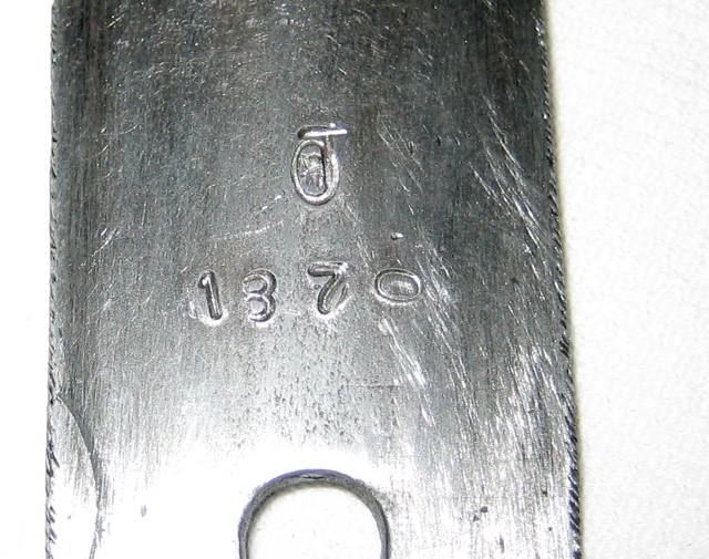

Here is another picture of the proof mark.

It's an "Albacete" dagger, named such because this pattern is considered typical from the city of Albacete, in the actual Spanish region of Castilla La Mancha
The pictures are not clear enough to pass a truly accurate judgement about the age of this specimen, but if its indeed old, the style would coincide with the second half of the 19th. - beginning of 20th centuries.
I would not place much hope in the blade's inscriptions. Decoration on these blades used to be punched with geometrical patterns of dots or etched with foliage and inscriptions. Featuring the manufaturing date is not unheard of, but it normally appars as an etching. The "Toledo" mark is even more spurious. In short, they are good candidates to be later additions.
Despite of this, if it's indeed old it's a nice exemplar. My congratulations on actually finding a weapon really worth buying in the city, it's not easy, as you've already pointed out. And the few places with some genuine material are freakingly expensive...

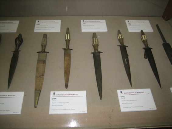

On the other hand, sadly, in the few years that have passed since I left Barcelona, the two most important antique shops specialized in arms and armour have closed their showrooms. They're not out of business, but now you can't just walk in... anyway, if you have time and your wife is in the right mood, you could make a stop at the Army Museum in Montjuďch Castle, or the Ethnological Museum, which is relatively close.

Hi Marcus,
Not2sharp has summed it up pretty neatly. It is a dagger in the Albacete pattern, but its date of manufacture is a puzzle. If the inserts are indeed synthetic, as you suspect, (the handle looks too white to be bone) then that would date is as post WWI and daggers such as your were still being manufactured as late as 1960 for the tourist trade. I also find that "1870" highly suspect, and by way of comment can add that the practice of falsifying dates of manufacture as well as brands was not uncommon amongst Spanish cutlers. The all too ubiquitous "Toledo" can be found in any number of junk Spanish navajas, knives and swords, being a generic brand intended to beguile tourists, trading on the justly famous reputation of the sword blades manufactured in that city before the 20th cntry.
I could not identify the logo-brand from my books
Is the blade hardened?
