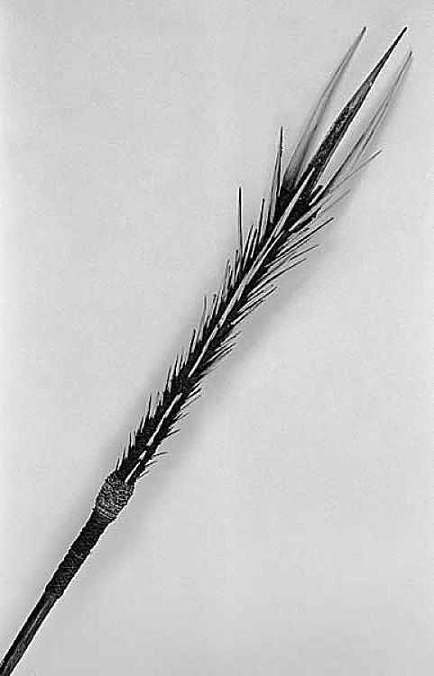

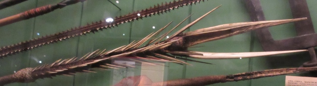

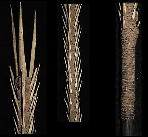

Here are images of two unusual and bizarre wooden spears (with some damages) I acquired a little while ago. They are apparently from New Hebrides (Vanuatu) and seem to be quite rare.
There is an illustration of one in the Oldman 1906 sale catalogue, described as a "Festival Spear" from Espiritu Santo and the points made from human bone. Has anyone more information of these items or comparable examples ? Maybe they were a way a warrior could display his success in combat, or perhaps the points would be poisoned and serve to intimidate opponents ??
Anyway, they are unusual spears and should be of interest to those who like primitive weapons from the Pacific...

I've checked Felix Speiser's book 'Ethnology of Vanuatu', and he gives a few paragraphs on these Santo weapons. He calls them javelins, because they were thrown. "The material for the bone spikes is supplied by human long bones, specifically those of relatives and men who held high rank in the suque. The mana of the dead man is thought to be transferred by the bones to the owner of the javelin ... Before discharging his weapon the thrower tried to impart to it a sideways oscillatory movement so that, vibrating in flight, it was capable of inflicting a lateral wound".
I have seen, and handled this type of giant bottlebrush, and they always reminded me of Corporal Jones's immortal words ... "they don't like it up 'em".

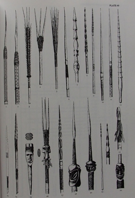

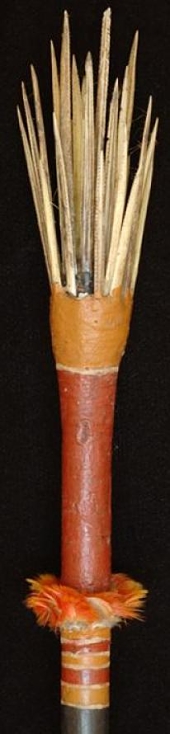

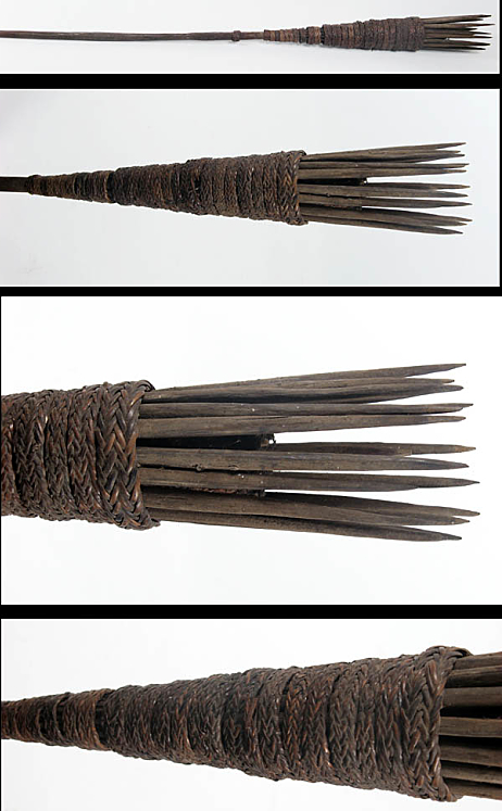

HERE ARE A FEW PICTURES OF THESE NEW HEBRIDES SPEARS I HAD AS WELL AS SOME SIMILAR TYPES FOR COMPARISON.
#1. NEW HEBRIDES SPEAR 246 CM. LONG WITH HUMAN BONE SPIKES

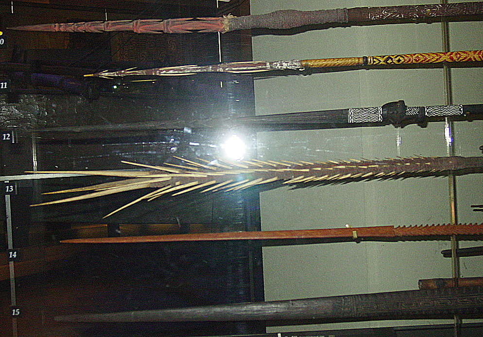

#2. SELECTION OF VARIOUS SPEARS , BISHOP MUSEUM HAWAII 1 NEW
HEBRIDES EXAMPLE.
#3. SELECTION OF SPEARS FROM THE REGION, ONE NEW HEBRIDES EXAMPLE.

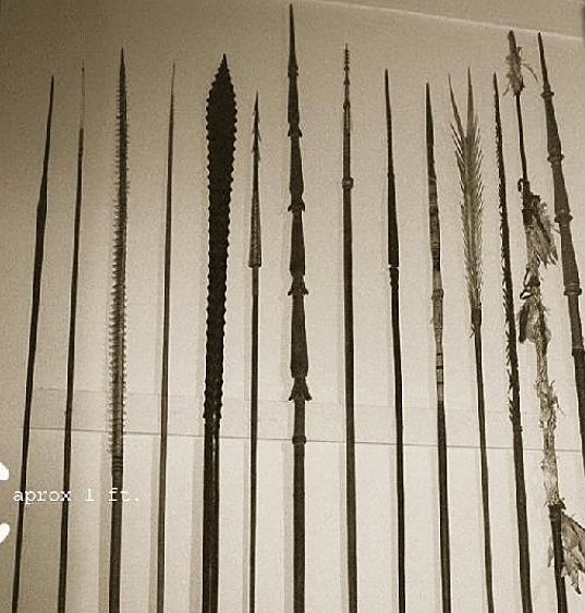

#4. NEW HEBRIDES SPEAR
#5. FISH SPEAR NEW GUINEA AREA
#6. 310 CM. LONG SPEAR SOLOMON IS. WAR SPEAR WITH BONE SPIKES
#7. SPEAR POINT WITH STINGRAY SPINE POINTS.

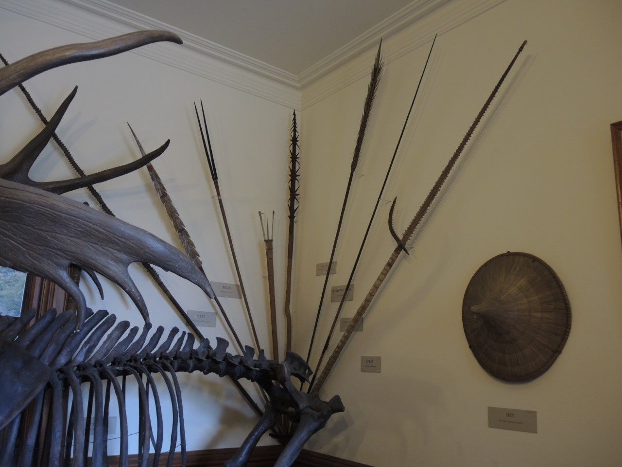

Visited the wonderful Pitt-Rivers Museum the other day, and here is an image of the spear of this type they have on display ...

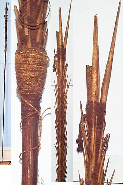

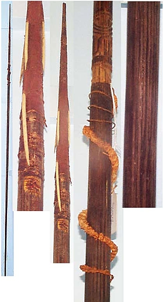

I SAW THESE TWO EXAMPLES RECENTLY. PICTURE #1. AUCKLAND MUSEUM
#2. CHRISTCHURCH MUSEUM.
#3. 53 INCH SPEAR
Old 23rd June 2016, 04:10 PM   #15

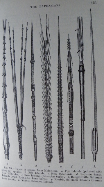

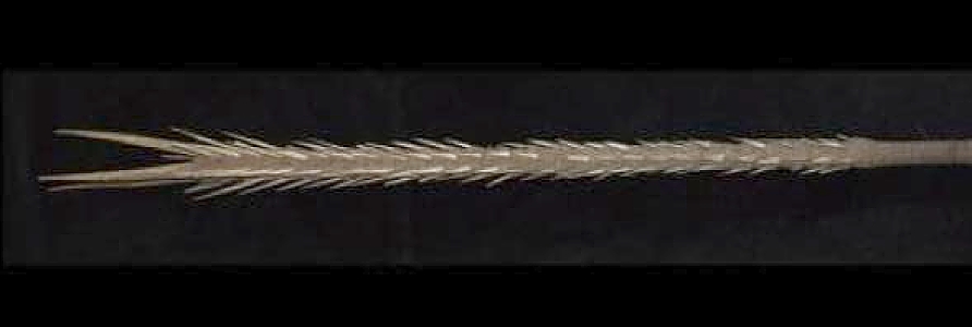

ANOTHER GOOD PICTURE OF THIS TYPE OF SPEAR FOR THE REFERENCE UNFORTUNATELY NO INFORMATION TO GO WITH IT.
