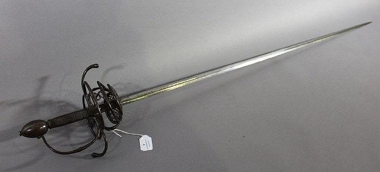

I believe this swept hilt to be Italian? However, I am unable to identify the letters on the blade and the marking on the ricasso is also difficult to place. Based on the Pommel and hilt configuration it is probably early seventeen century.
Overall Length 43 ½” 110.7 cm
Blade length 35 1/8” from bottom of shell guard to tip
Blade widest point 7/8” 2.3 cm
Hilt widest point 10” 25.2 cm
Inside grip length 3 ¼” 8.3 cm
Description
Plain steel Swept Hilt Rapier made up of a Mushroom facetted pommel; wire-bound grip, straight quillons, hilt arms; triple ring guard; the smallest filled with a plate pieced; loop-guard, knuckle-bow; counterguards. Diamond Section blade inscribed? Probably Italian Early 17th Century.

Hi Cathey,
thats a classic rapier and indeed early 17th C.
This pommel shape can also be found on pappenheimer type rapiers.
To me one side of the blade reads A L E M A N I A.
The shell like scales look like an old restoration, this is often the case with this type of scales and not problematic.
A very nice and Original rapier.

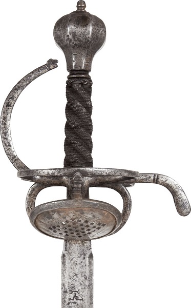

Hi Cathey,
the faded sword makers mark could be seen as Sebastian Hernandez the Elder.
The rapier could be south German or North Italian wit an export Hernandez blade or with a producer of blades in Germany who used his mark.
kind regards
Ulfberth

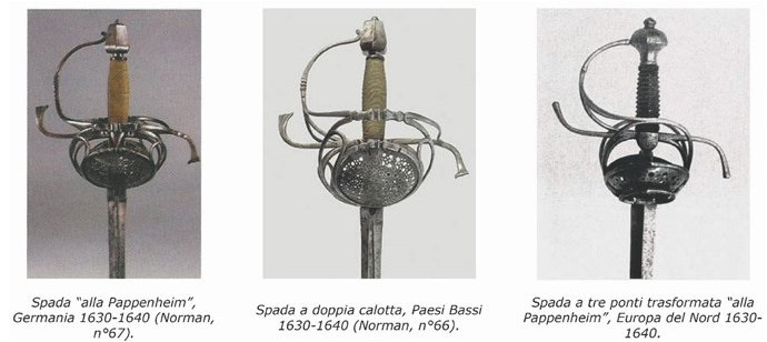

Its easy to see how the double scaled rapiers evolved further into the pappenheimer....
Kind regards
Ulfberth

As you said Fernando "faded sword mark" thats why I deliberately used the faded version of the mark to compare it with the one on the rapier.
It seemed like a good idea at the time.
